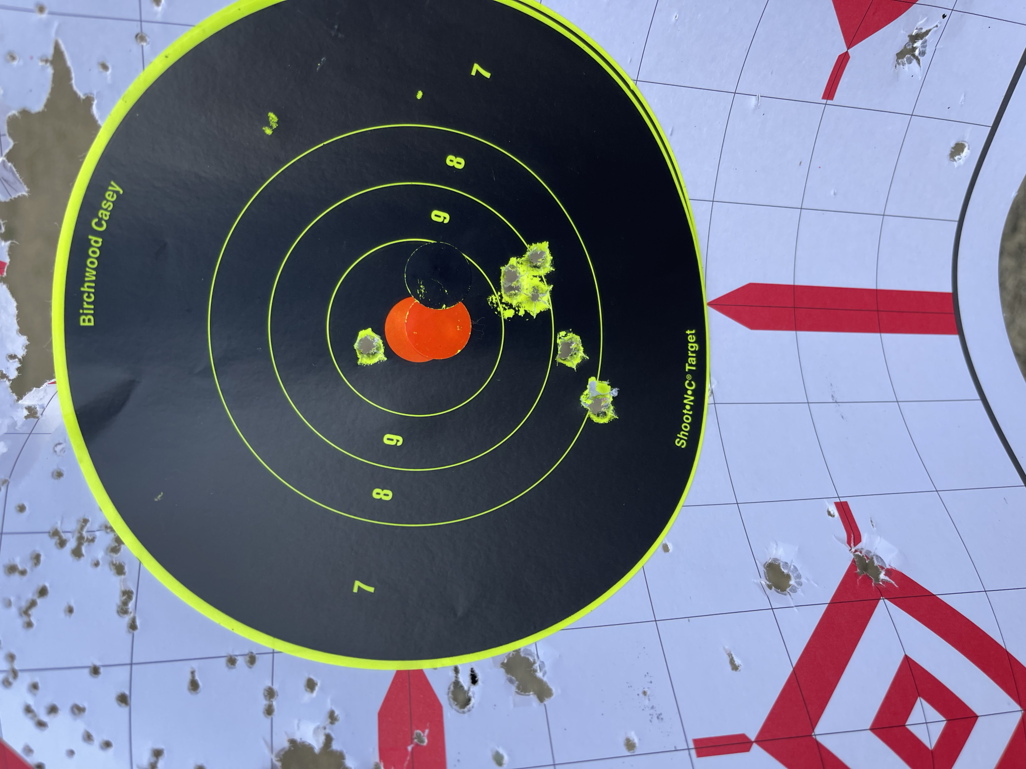

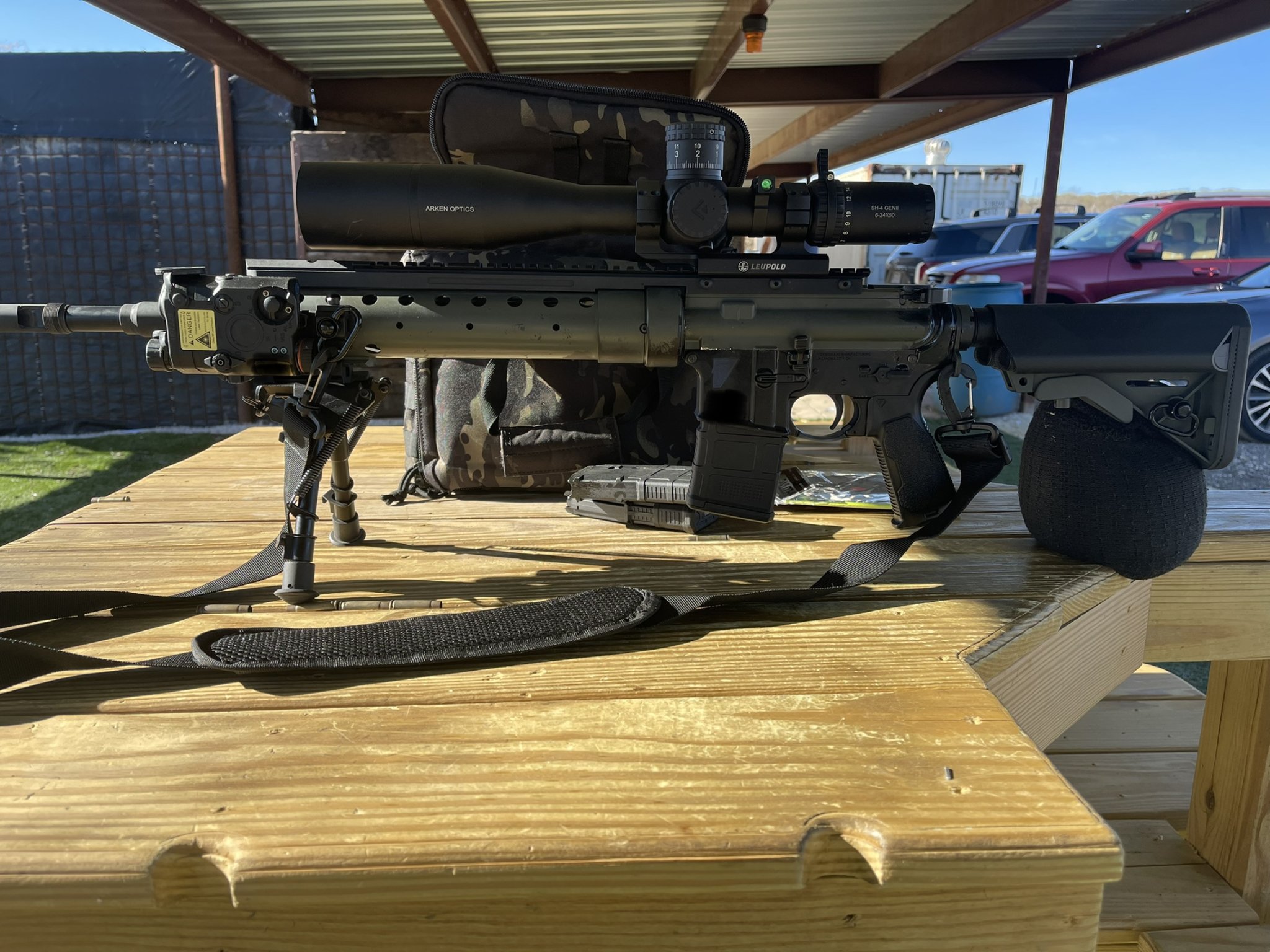

Hey guys,
Just wanted to share my MK12 style build after 1,200rds
Parts
My MK12 is far from “clone correct”. I wanted the performance of the MK12 first, and the looks second. This build was started in the late part of the pandemic (October 2020). Most clone correct parts were out of stock or out of my price range. From tip to butt the rifle is made up of:
AE Brake and collar.
AE AEM5 Suppressor
KAK Muzzle brake (replaced)
Ballistic Advantage 18” SPR Barrel 1:7
Ballistic Advantage .750 LP Gas Block
Ballistic Advantage melonite gas tube
12” PRI Forearm
12” PRI TOP Rail
Unnamed upper and lower receivers
B5 systems buffer kit and stock
Strike Industry LPK
Geissele SSA Trigger
Rifle will not cycle TulAmmo. I get the best accuracy using above 55gr.

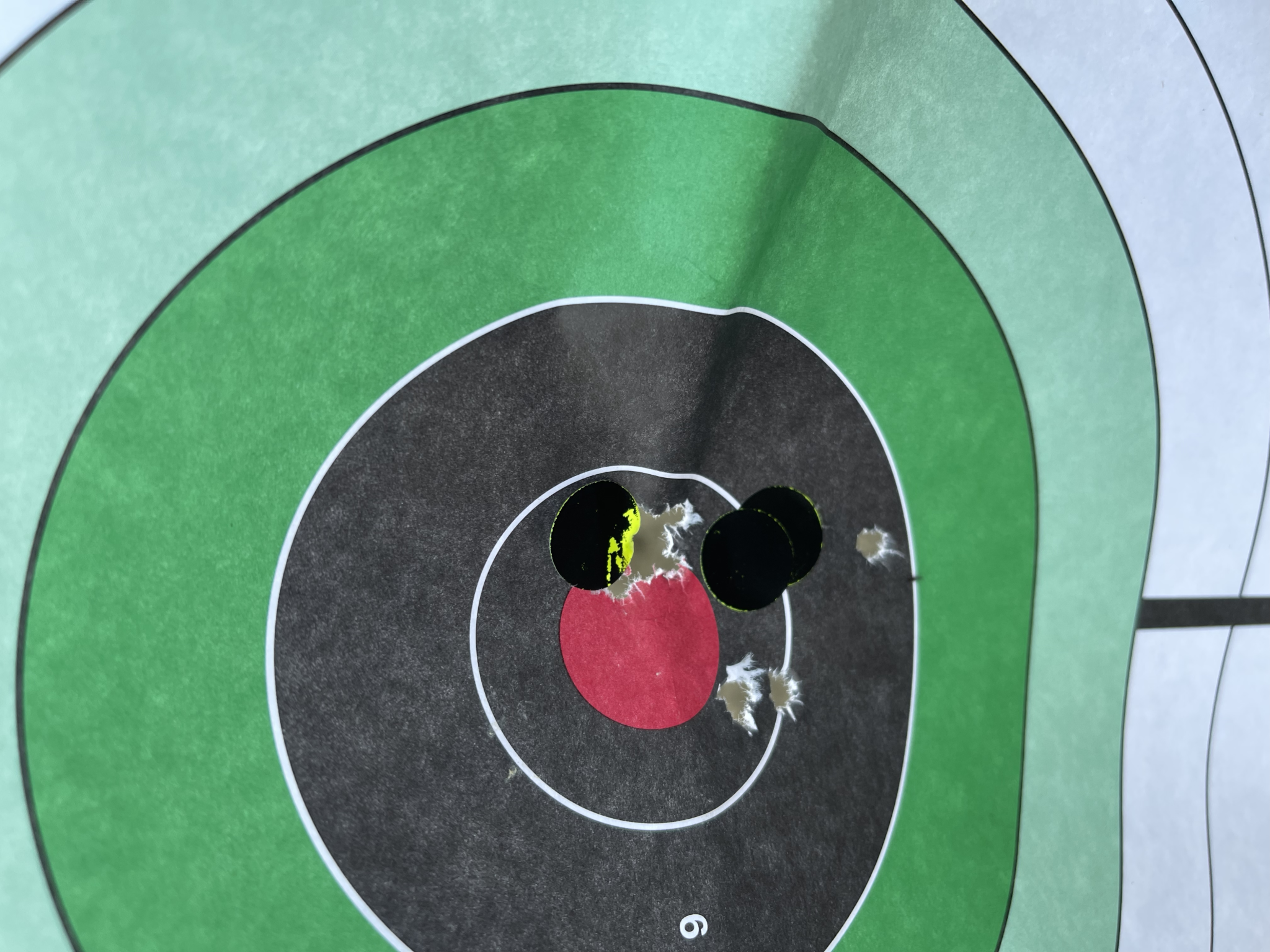

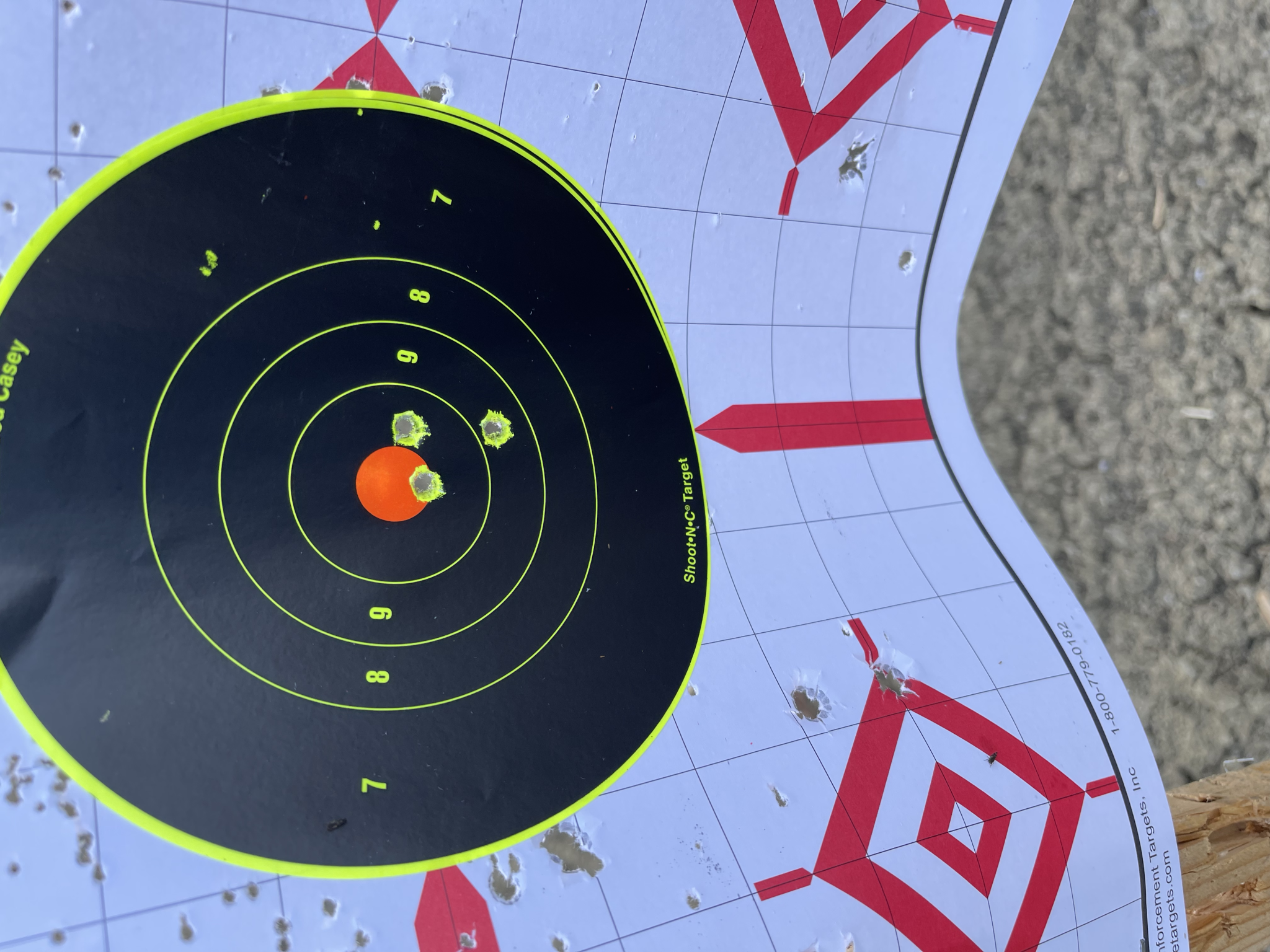

I mostly feed Hornady Black 62gr. I did fire 50rds of the MK262 and the results were amazing. Ive including
some groupings between 300, 500, 700 and 800 yards using 75gr Fiocchi.
Post MK12 pics if you have them

Those targets shot as posted? from 300, 500, 700 and 800? If so those are remarkably small groups, especially for 5.56 and a BA tube.
