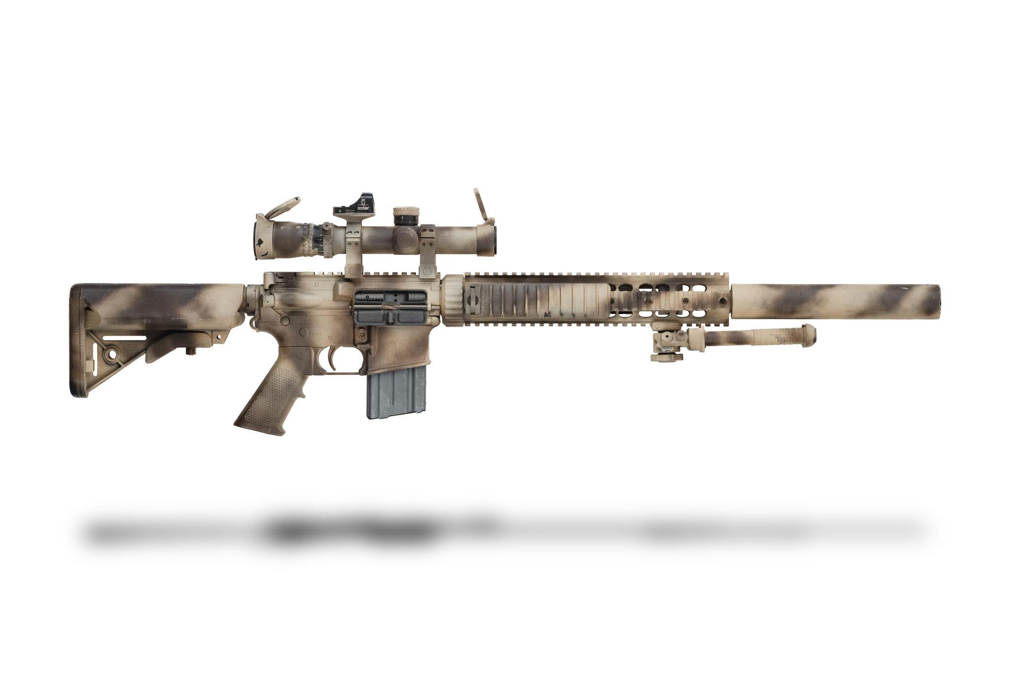

Which Mk.12 are you looking to clone and is clone more important to you that practicality?
There were the prototype SPR uppers. Then there were at least 6 basic frames with specific core parts for the different Mk.12s:
1. Mk.12 Mod 0 with PRI tube, PRI rail, ARMS flip-up rear, PRI flip-up front sight/gas block, M16A1 lower receiver and Type E buttstock, KAC 2-stage trigger. Parts list here.
I saw no less than 2 different types of ARMS Swan sleeve-style rails used on these, one of which had a PEQ-2A interface up front at 12 o’clock to mount the PEQ-2 LAM. The other had a straight Mil-Std 1913 rail that was continuous from rear to the front end that is better for Clip-On TWS. Straight 1913 in background, PEQ-2 model in foreground:

3. Mk.12 Mod 1/M16A1 Lower:
iu
Mk.12 Mod 1/M16A2 lower:
4. Mk.12 Mod 1/telestock lower:
iu
iu
Mk.12 Mod H (16” barrel):
6. Mk.12 Mod H rifle stock:
