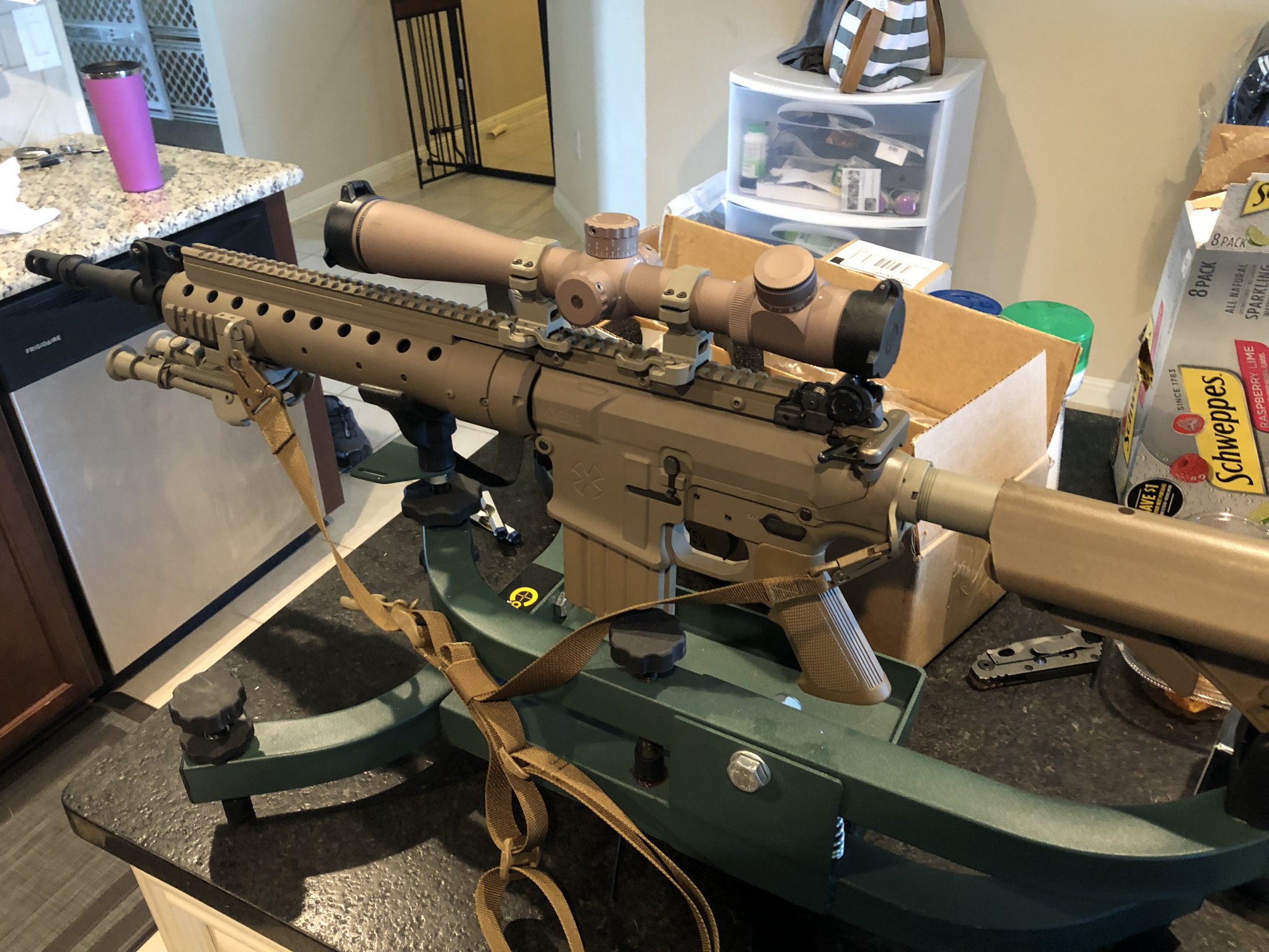

So I really love these mk12s, but would love to see it in a bigger 6.5 Creed for the ballistics. So I thought, why not build one since I have a bonus check to spend.. super responsible.
I've found a similar build on here:
It really looks awesome, especially since it's in a 6.5 Creed. I guess it's how I feel about loving an M1A but wanting it in a 6.5CM (which exists I know). So really this about just wanting want I want. It would be a heck of a lot cheaper to build it without the PRI parts, but again, what I want.
To the point: I'm trying to keep this budget "reasonable". Here's what I'm thinking on parts, you tell me if you see a compatibility problem:
-Aero M5 matched upper and lower
-PRI 308 mod 0 gen 3 handguard, flip up front sight/gas block, continuous rail
-Criterion 6.5cm hybrid barrel 18" .750
-and all the other stuff
I like this barrel length, and I've always had Criterions that would shoot.
Thoughts?

I don't think that Wilson Combat offers gas block journals longer than ~1", so the PRI gas block/sight won't work. Your gas system length is critical, along with your bolt/BCG selection. You won't have the option of an AGB with the PRI, so maybe consider an RCA BCG with adjustable gas key. Next would be the action/recoil system.
I'm pretty sure that I'm going with the Criterion, and not the Wilson combat. So I should be good with what I have?
Reactions: msgriff
I should add that you need to get the PRI gas block/sight that is specific for 308/large frames and not the AR-15 version. They will be sold as the ArmaLite AR-10 receiver height, which is the same as the Aero "DPMS high".
Reactions: EscapeVelocity
Just do a 6 arc spr profile barrel if you want the same look. As soon as you go to large frame everything changes. I have built ALOT of mk12 mod 0 and 1 clones over the years along with some similar dmr setups. They are dated as fuck, the optics are shit compared to modern stuff and they are unnecessarily heavy without good weight balance. Parts are also expensive and hard to find, especially doing a mod 1. It's your money so you do you, but wanted to point it out before you make a decision.
It really is the look and the performance of the larger caliber of 6.5CM. I'm not going to use the "correct optics" or really anything other than the handguard, top rail, and flip up sight. Mod 0 is the look I'm after, it's just not the caliber I want.
The 6 arc is appealing for regular frame ARs and the cost/availability. It's just not quite enough performance out to 1k that I'm after. The monthly matches I shoot have targets out that far and the slower factory speeds of the arc concern me. I know you "get there" with it, but it's not a GT or Dasher, or BR. I don't know, I could be wrong without trying it at range. I've actually had one a couple years ago when they came out but the factory barrels didn't have good enough accuracy. Maybe that's changed with more support.
It just seems like I need to go 6.5 CM without compromising performance despite the heavier/more expensive parts.
