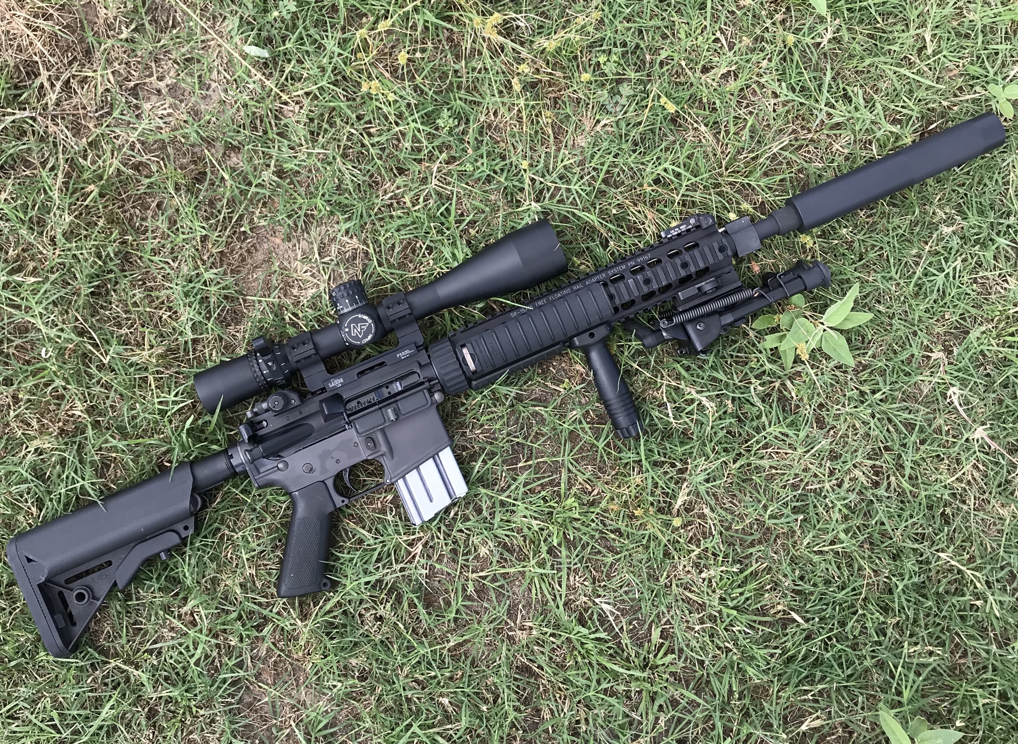

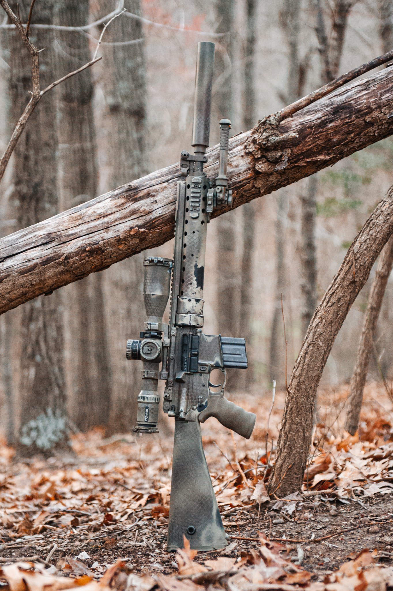

If you’re a 100% cloner, I’m going to apologize now...
Like a shitload of people I love the look and idea/premise of the Mk12.
I built an 18” SPR 5 or so years ago with that Mk12 image in my head but once it was done I never really liked it much. Its just didnt do anything for me, barely liked shooting it. So I sold it.
Got really heavy into PRS style shooting and couldnt justify building another that would likely just sit around. So I just kind of lusted for the past few years.
Finally said fuck it and put one together. Its not 100% correct because I didnt want the shitty Leupold and ARMS rings, and didnt want the A2 grip. Just waiting on the crown for my AEM5 now.
I havent had a chance to actually print any groups or do any real load development, (just threw 24gr Varget under a 77smk) but Ive ran it out to 1000 without too much trouble, and 800 seems to be the realistic “effective range”. Zero trouble getting on a 2MOA plate there.
Movers from a barricade as fast as you want to go is super fun.
Glad I wasted the money on a gun that probably won't ever serve any purpose for me other than a fun gun.
PRI Mk12 Mod 0 Upper (7tw 556)
Premier 3-15 G2 Mildot
Badger Unimount
Geissele SSAE
Surefire RC2 (for now)

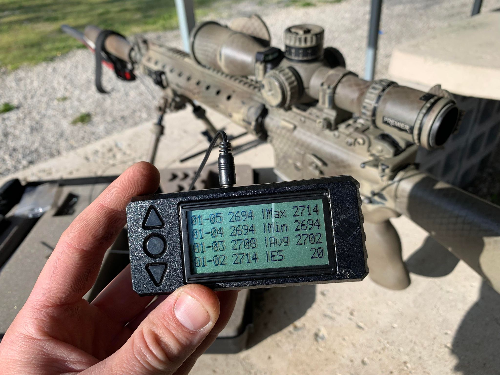

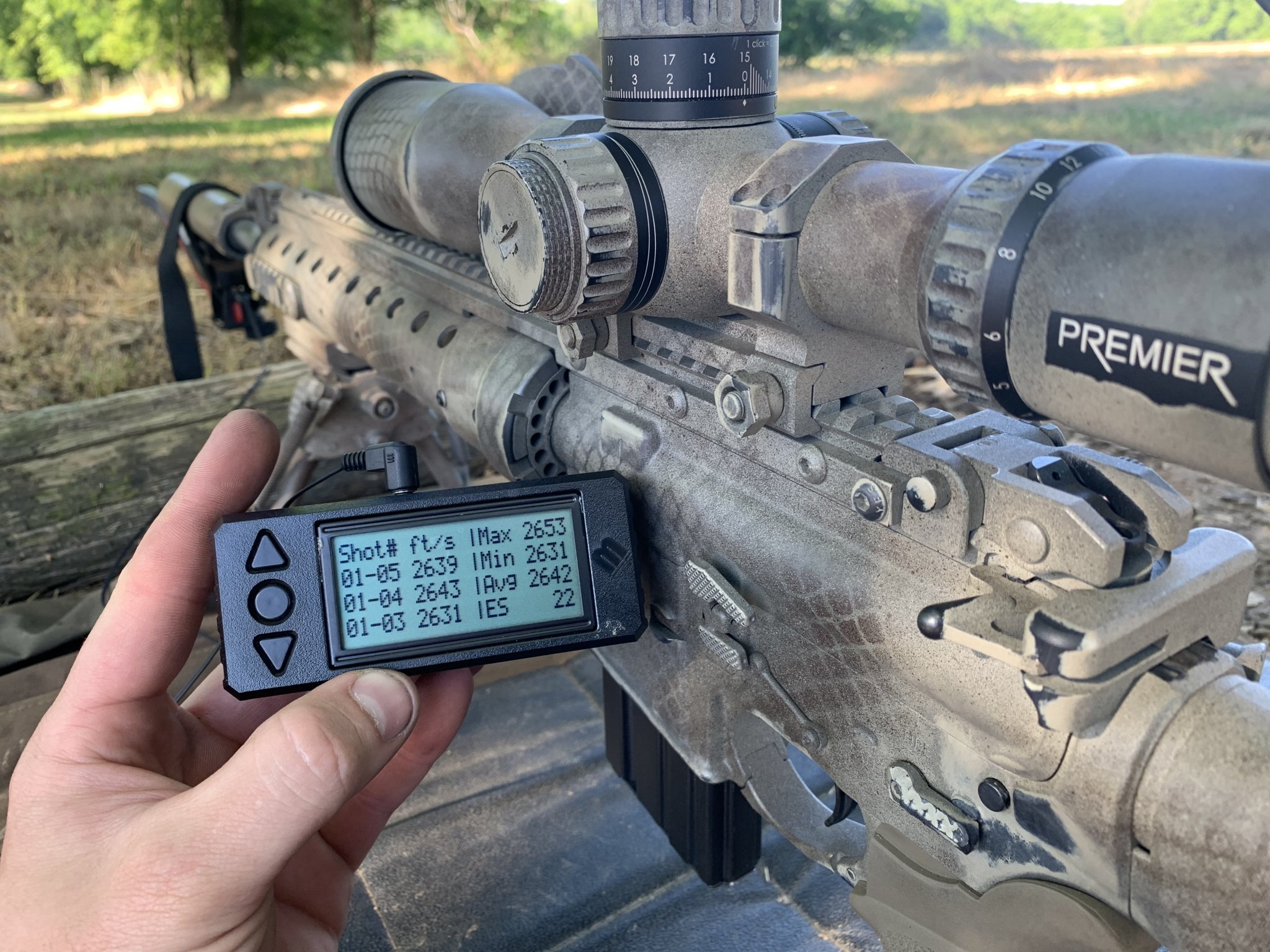

Clocked my 24gr Varget /77smk load last weekend. Consistent enough but a but slow. Going to cram some more in and test, then swap to some different powders I suppose.
I’d love to be in the 2750ish range

I use 24.1 N140 with the 77 SMK. I get 2640 FPS from a 18” barrel. Average .6 moa and not as compressed as the Varget load.
Probably a good idea to go through and torque the (many) screws on that. I think every threaded fastener except the barrel nut on my factory PRI came loose relatively quickly. Individual part quality was very nice, but assembly seemed to have been hurried.
8208XBR is your friend.
23-24 grains in LC brass and #450’s
This or TAC. 23.4 gr XBR or 24.3gr TAC were my loads with the 77 SMK at mag length.
I may have missed what powder you’re using, but give RL-15 and/or TAC a try. Like a few have stated along with my experience, TAC gives me velocity in the range you’re looking for without dangerous pressure signs. Shooting 77smk suppressed through the AEM5, I’m in the 2,750 ballpark with 24.1-24.3ish grains of TAC (sorry, I don’t have my load data in front of me). Keep it up man; once you get that good load, it makes the Mk12 so much fun to shoot.
Reactions: gconnoyer

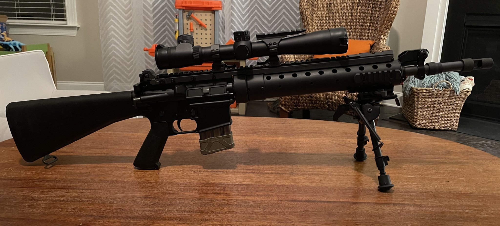

I resurrected this thread because I love gconnoyers build. Here’s my not clone correct Mod 0.

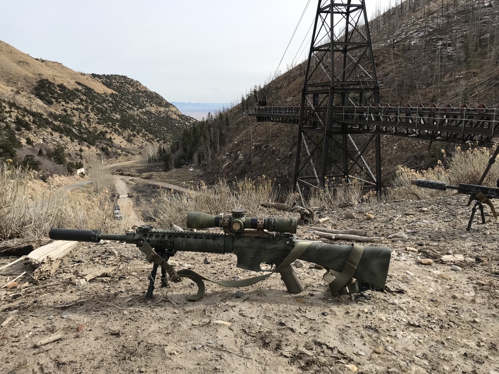

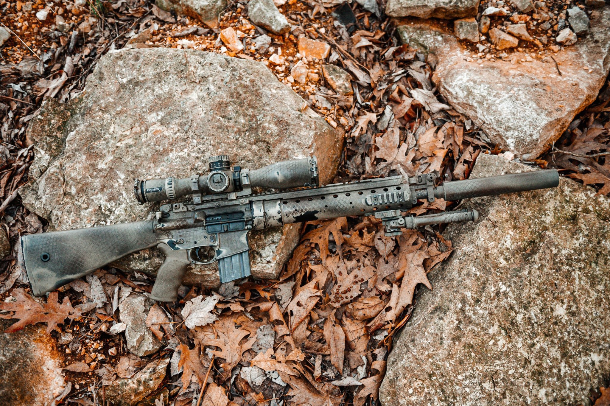

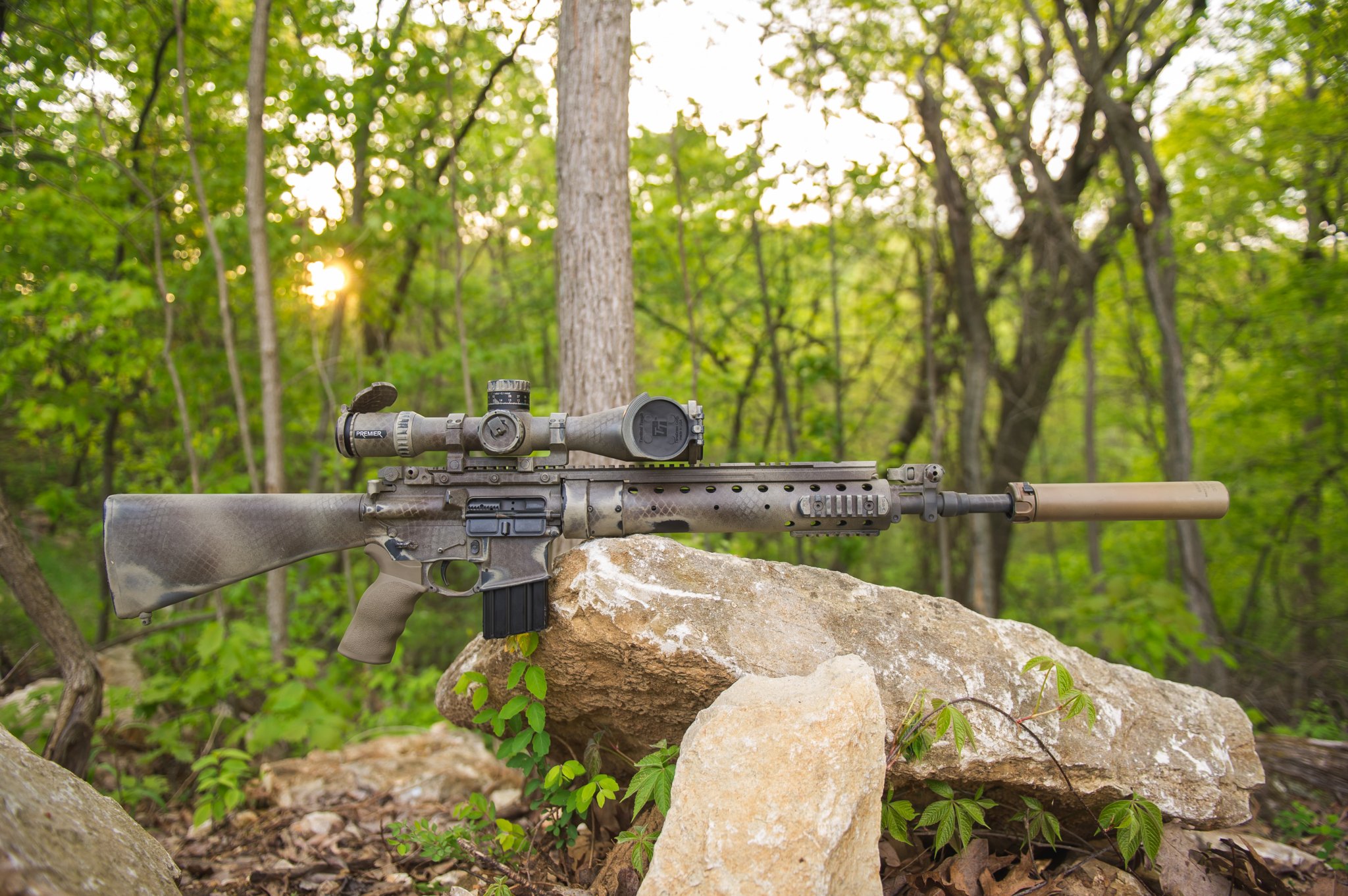

FINALLY got the AEM5 out of jail and got it painted to match as best I could (without redoing the whole rifle)
Ditched the Harris for an Atlas PSR. The harris just sucks in comparison and is way less "streamlined" with a pic to sling swivel adapter.
Since I couldnt afford a KAC Mk11 adjustable stock, I added a flush cup to the rear so I could sling it for shooting gas gun matches (and because all rifles need a sling)

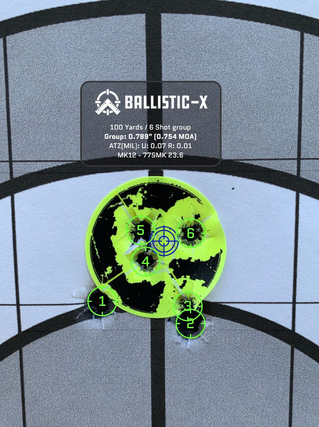

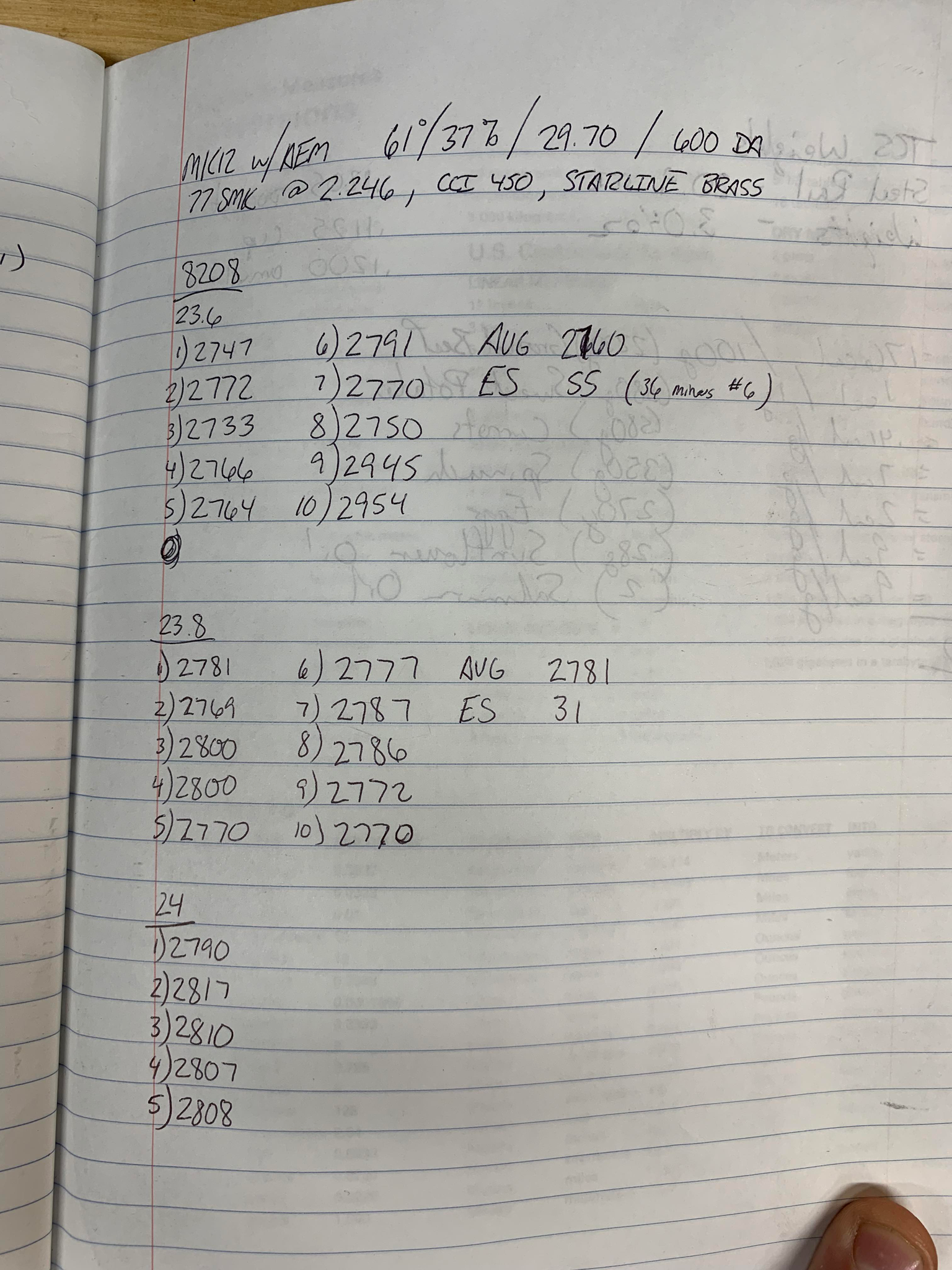

Have done a little load development with the AEM on it to atleast get it good enough for what I do with the gun. Nothing close to bolt gun performance, but I'm getting factory second 77smks for dirt cheap and I doubt its going to matter much how much tuning I do. The base to Ogive on them varies .060-.080 so its never going to be a tack driver.
Using 8208 XBR, Starline brass, CCI450s, bulk 77s getting really good velocity. Not much for pressure other than an extremely light ejector mark, primers still look excellent. 23.6 and 23.8gr shoot great, but I'll probably stick with the lighter charge just so I've got room from pressure as it heats up and if I end up shooting in the rain.
I found a bag of starline I had loaded with CCI41s and interestingly enough that same 23.6 load only shot right around 2700.
Anyway, little update for anyone that cares lol
AEM sounds fantastic and EVERY single MK12 needs one. I even bought an Otter Creek over the barrel adapter so I can run it on any other compatible setups.
