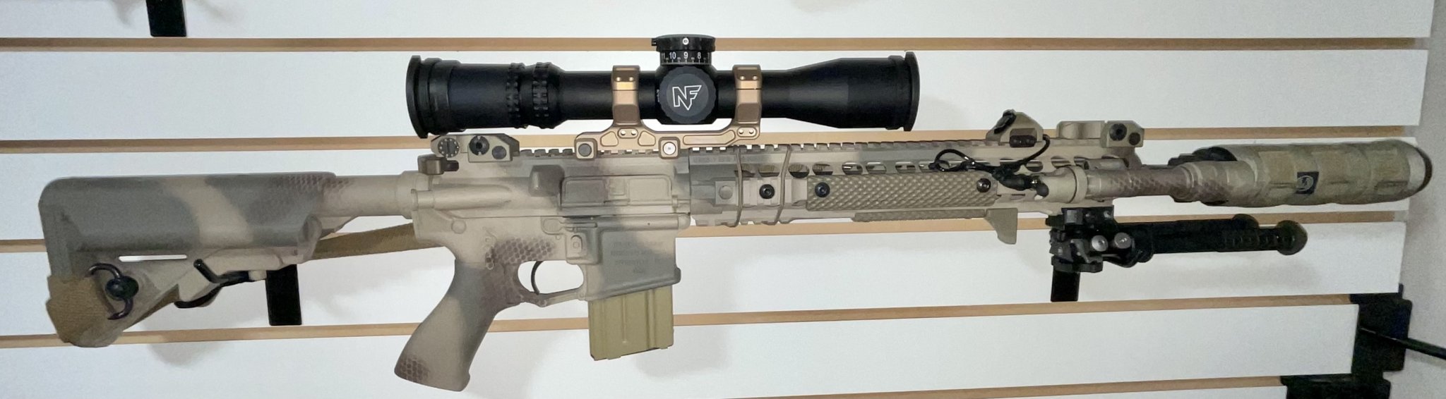

I just went from the 2.5-10x24 NXS to the 4-16x42 ATACR MIL-XT on my primary 18” AR. I really like the 2.5-10 but have been looking for something with more magnification and parallax adjustment so I’m willing to overlook the extra size and weight.
After a couple range sessions, I’m very happy with the swap. The glass is significantly better and even though I wanted the T3, I actually like the fact that the MIL-XT isn’t quite as busy.
I shoot this rifle out to 800 yards frequently so I’m running a Badger C.O.M.M. for the extra 20 MOA cant on the mount. Even though I will use the reticle most of the time, I want the option to dial adjustments if I need to. I will be using an offset red dot and I prefer the offset mount the C.O.M.M. offers.
Reactions: Bakwa

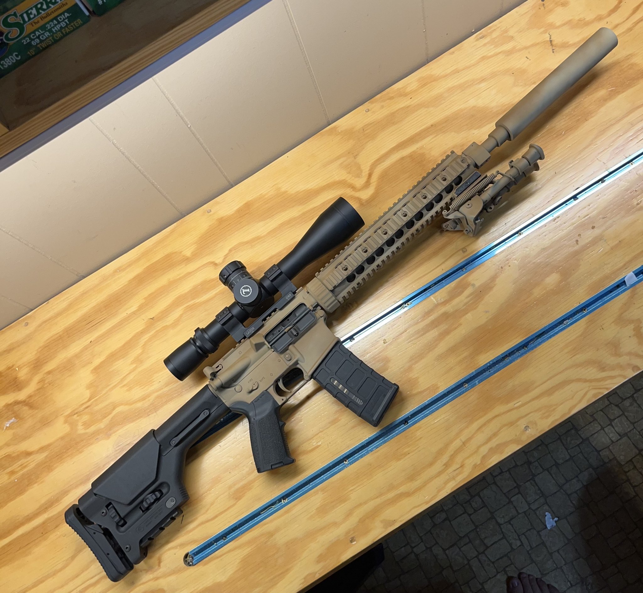

Leupold mk5 3-18 is an option. Plus it's somewhat clone correct as they've been seen on the sniper comp rifles (some of the last mk12s in use if I'm not mistaken).
