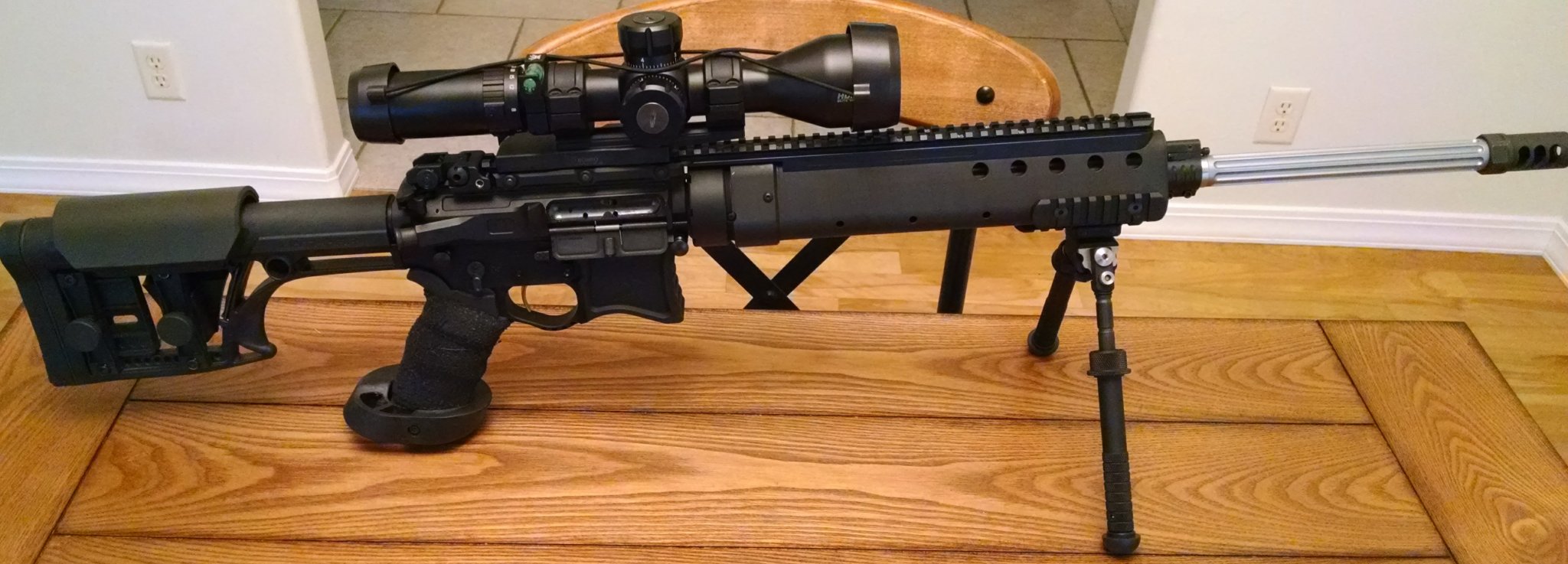

I’m going to do basically the same except in MOD1 configuration. I have a 5.56 and a .22LR MOD1 already, setup and painted exactly alike(except for different BUIS) and a .224 Valkyrie would be a great addition. I had actually considered committing sacrilege and going with a slightly longer (for velocity without getting too far from aesthetics) and slightly heavier barrel(because I’m weird) and using the same brake/collar for my can. A Valkyrie Mk12 seems very cool, if for no other reason that surprising people at the range.

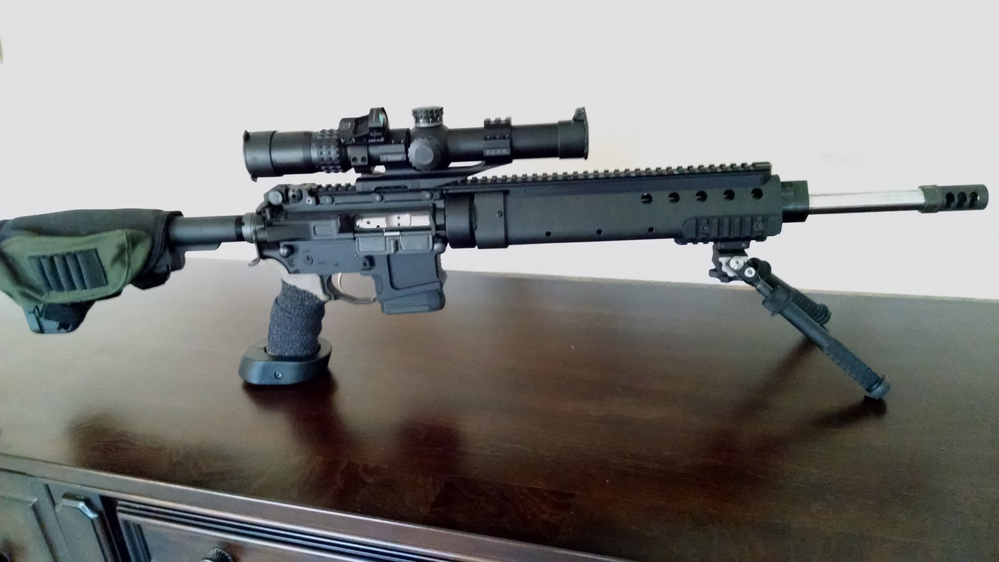

I've done something similar, I've always liked the MOD 0 due to the monolithic top rail. This is my twist on the MK12 with a 22" Bartlein Barrel chambered in 6mm FatRat. I prefer the Delta series handguard the the flat bottom in case I'm out without a Bipod.

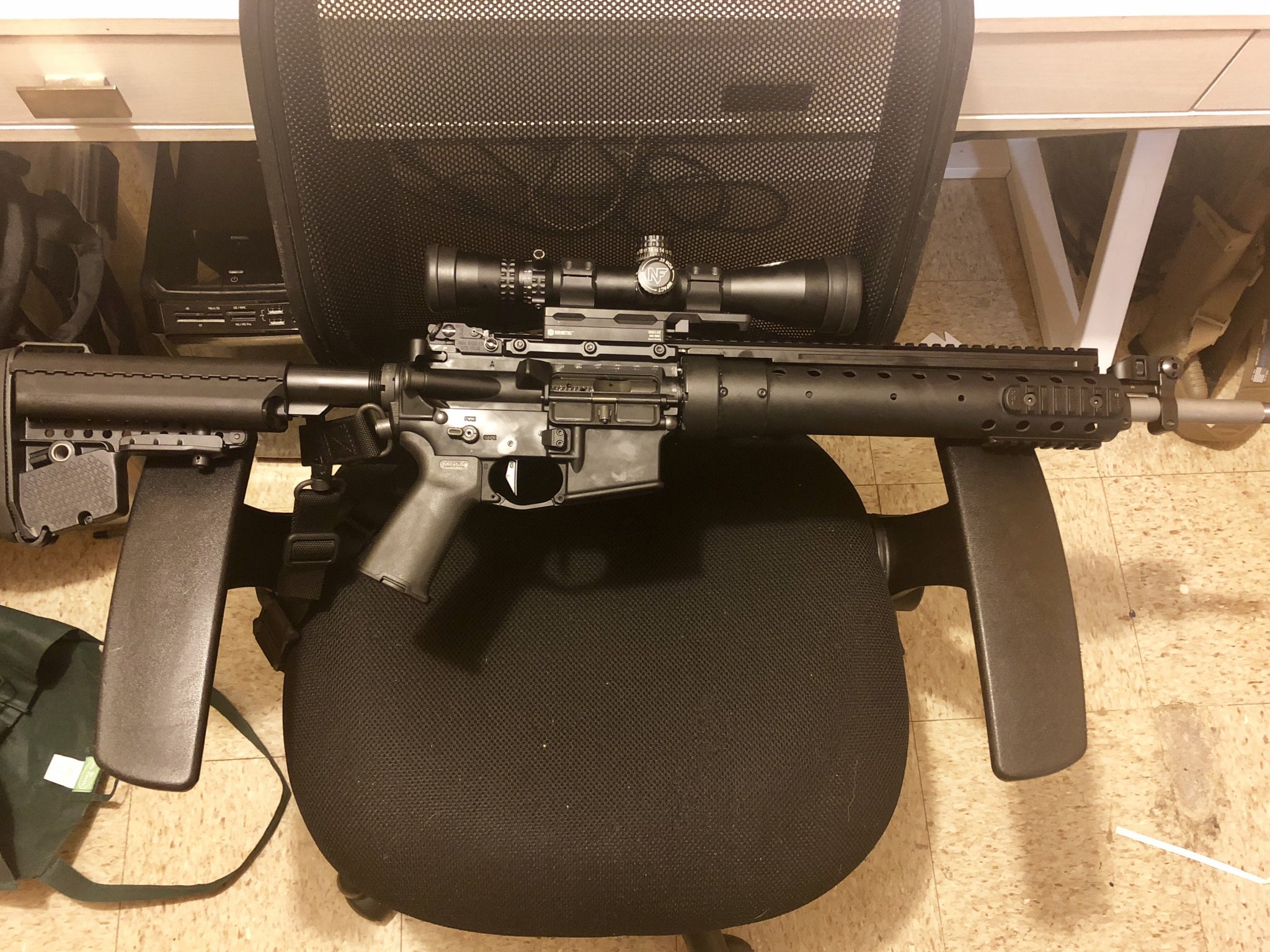

Sorry, I've been away. It shot great! Consistently did 3/4 MOA or better. I have only stretched it out 300 yards off hand supported against a wood beam (realistic shooting) and hit shot after shot on 16 in. diamond steel plates. Unfortunately, I'm looking to fund another project bolt gun and I'm looking to sell it now. Absolutely nothing wrong with it and will probably hate myself for getting rid of it later, but I'm looking to get into PRS comps and need a solid bolt gun and equipment.
