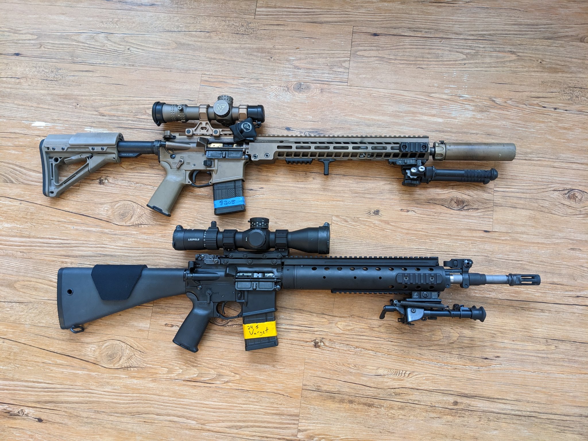

    I am trying to run 23.8gr of 8208 behind 77gr SMKs in two different guns. The 16" gun gives me more substantial pressure signs, including several blown primers. Pressure signs are primarily ejector marks on the brass (substantial on the 16"). However, after shooting Mk262 through both guns, I get similar speed as the 23.8gr load with no pressure issues. Both guns are run suppressed with a Surefire RC2 (waiting on an OCM-5).
    I am wondering if adjustable gas blocks or restricted gas tubes would solve the issue. I would love the extra speed. My 23.3gr loads shoot at 2610fps 12SD and 2705 13SD in the 16" and 18" barrels, which is about 75fps slower in NH winters than the 23.8gr load or Mk262.
    GUN 1
    16" Douglas SPR Barrel from PRI
    Mid length gas system
    Geiselle 42 carbine buffer spring
    H3 buffer
    23.8gr Velocity 2700ish
    GUN 2
    18" Bartlein SPR barrel from CLE
    Rifle length gas system
    Sprinco Green Rifle Spring
    Noveske 5.2oz A2 rifle buffer
    23.8gr Velocity 2780ish
    Any thoughts on ways to modify the gas or recoil systems to reduce pressure? Or am I just going to have to stick with the 23.3gr loads.

    Overpressure issues won’t be solved vis an adjustable gas block as that’s for overgassing. Differing length gas systems will also manage gas better but won’t help if the charge weight is too much for the chamber.
    Mk262 mod 1 uses non cansiter grade powder that’s not available commercially.
    Try AA2520. Gives me 2800 fps in an 18” douglas spr bbl in my mk12 mod 1

    If you’re blowing primers, there’s no work-around for that. What primer are you using? Try 23.5. 2780 for 18” with 8208 is just too hot. I got mk262 speeds with CFE223 and great accuracy.
    Mk262 have a crimped primer? Might be why they don't pop primers like your reloads.
    24 TAC, LC brass, 77 nosler, 2.245 was the closest I got to the sort of speeds people talk about with mk262 and it meters very well + is usually easy to find and cheap.
    You could also try CFE223/2000MR or one of the other superformance type powders.
    Using CCI small rifle primers.
    The 23.5gr opened up on me for accuracy. The 23.8 seemed to shoot great, so bummer about the pressure. May try the A2520.
    OP, I'll pont out the obvious...You're too hot. :LOL:

    If only adjustable gas blocks and heavier buffers erased the physics of excess pressure. If only......

    If by small rifle primers you mean CCI 400s, you might try a primer with a thicker cup. In my experience CCI standard SRP don't like high pressure loads. I'd suggest trying CCI BR4, CCI 450, or Federal 205MAR primers.

    Deffff need to use thicker primers. I settled on 23.5 with 77TMK's and CCI 450's in my 18" Lothar Walther barrel. No issues up to 90*.
    I did successfully hit MK262 and a little more, but like others have said, TAC was the only way I could do it. It was not very temp stable, but I think I hit around 2800-2825fps with the 77TMK. Would have been a fun load, but I bought a keg of 8208 and just rolled with that.
    Only powder I could get close to 2750 mirroring mk262 in my rifles safely was tac.....

    Crimped primers are key. The only way I was able to replicate the velocity of Mk262 was to use brass from pulled down m855. LC brass with a factory crimped in CCI 41, TAC and a 77gr SMK or Nosler CC was indistinguishable from the Black Hills load.

    You don’t need to run crimped primers nor do you need to crimp the case mouth to match the Mk262 mod 1 mv. Douglas mk12 SPR bbls from either PRI or CLE will get you there provided correct components are used with the correct development process. I use Rem 7-1/2 primers which is what I believe mk262 mod 1 uses but I could be wrong about that (the primers look identical to the Remington primer).
    I ran into the same problem with 8208 while chasing Mk262 velocity. It shot, but the brass was dirty as shit and had all sorts of primer issues and ejector marks.
    McCourt did some voodoo magic and made a round for me that was more accurate and also 100fps faster than the 8202 load with zero pressure signs. I don't know what powder he uses or if you can get it.
    As far as the gas settings fixing your problem; that isnt a thing.
