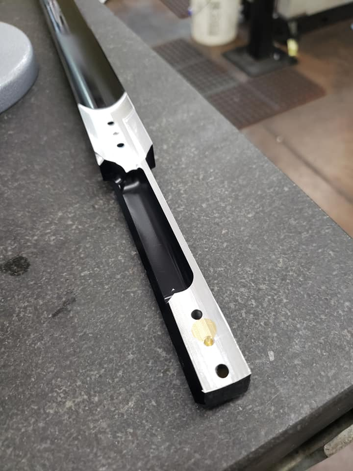

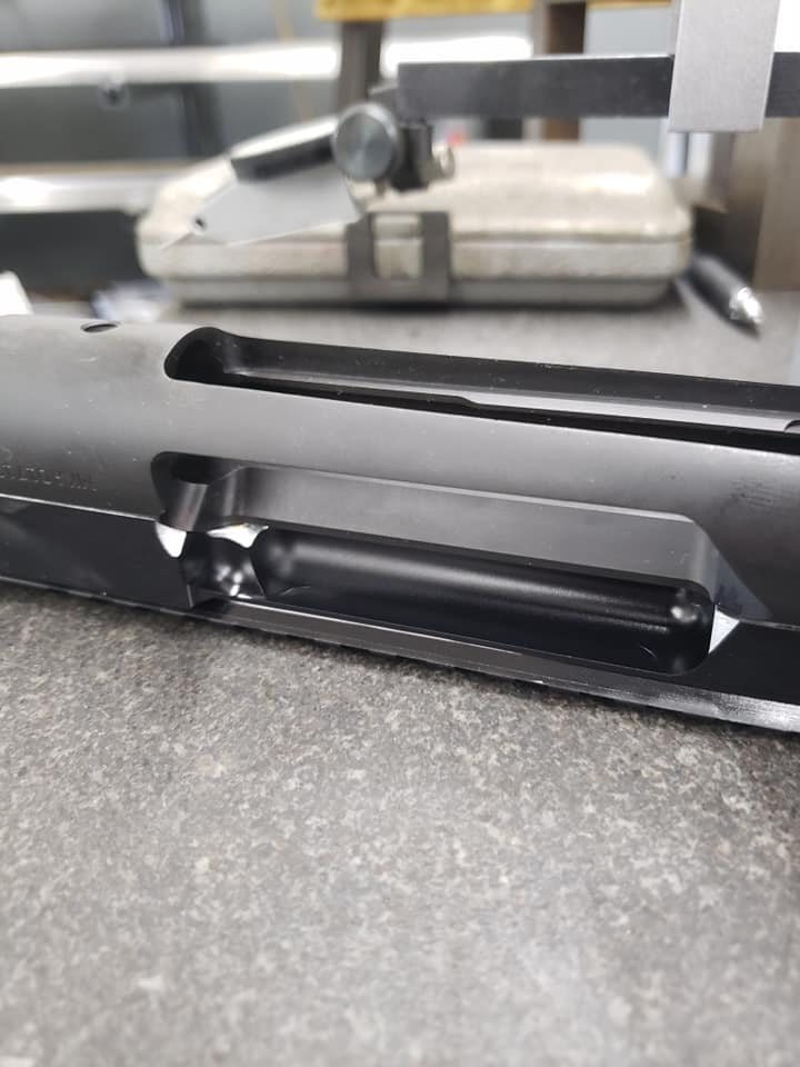

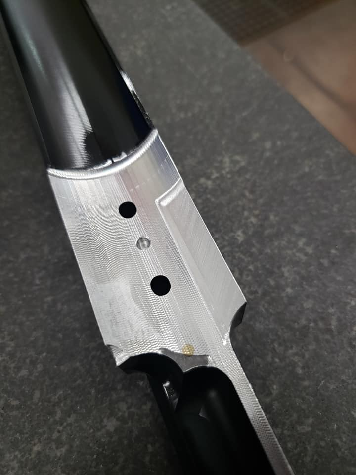

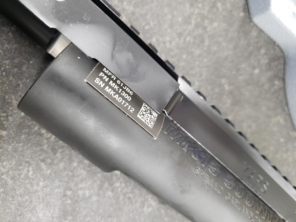

    I wrote a probing routine that basically allows a guy to slap the part into the vise with little concern about its absolute position. The probe finds all the relevant features, updates the required registry, and it just goes to work. The bottom half is surface machined to match the receiver's contour while also creating a clearance feature for the RFID tag that goes on the all the Stiller MK13's.
    Machining is paused so that a brass pin can be pressed into the part while still in the fixture. This is because M700's and Stillers don't use the same hole spacing on the back of the base where the two parts mount to one another. We also add the pair of dowel pin holes that serve as recoil lugs for the base. The original roll pin is removed and also plugged with a brass pin.

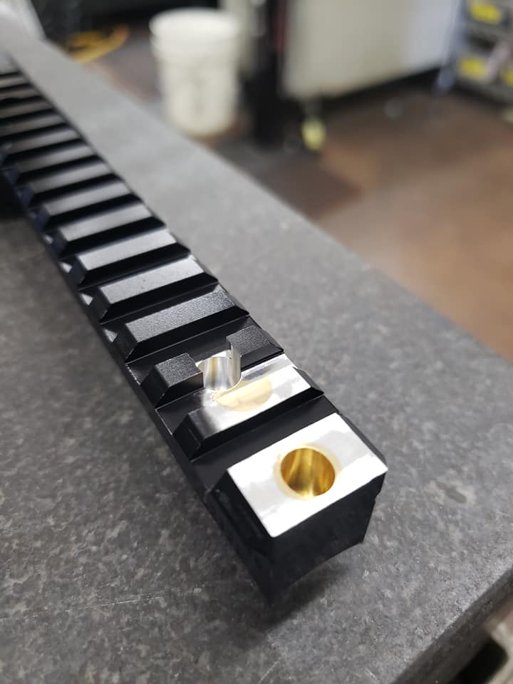

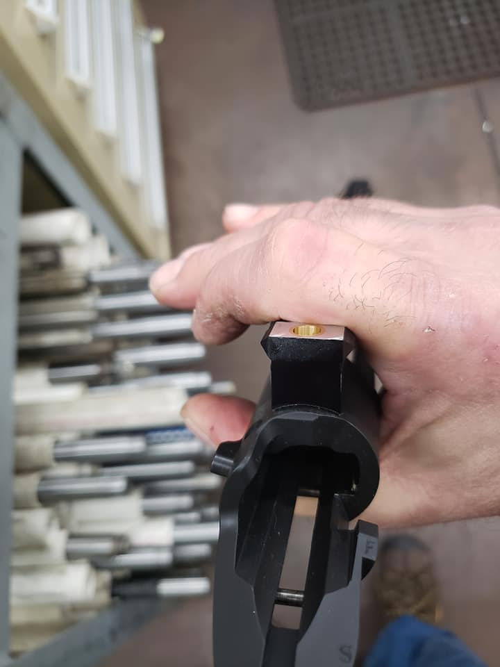

    Completed, we flip the part and move to the 2nd op. Again, the machine probes the part qualifies it and updates the registry. A 2nd hole is bored and another brass plug is installed. This is for the rear base screw hole. Machining the rear bridge portion leaves the bottom paper-thin. If we'd of left it, the screw head would pull right through the bottom of the base. So, the oversize plug restores the material thickness so that we can machine the counterbore with the assurance it'll never rip through the bottom.
