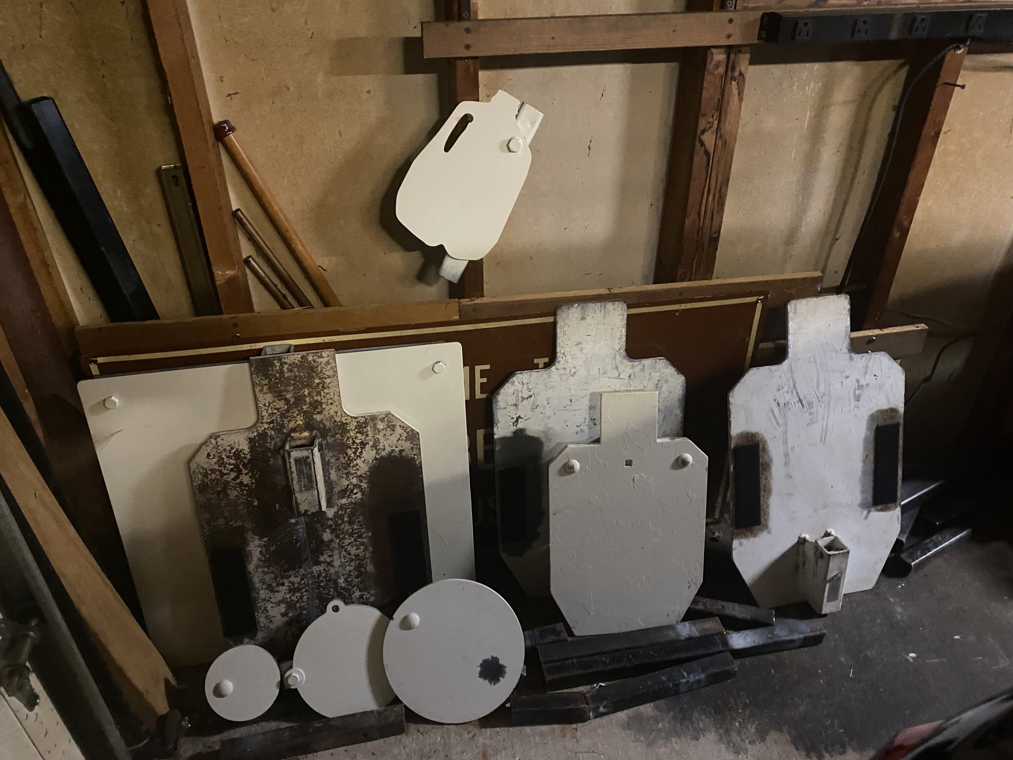

And an 8” disc is pretty ambitious for 1K…..I shoot 1K nearly every weekend and the smallest target I can consistently (80-90% of the time) hit is a 20x10 IPSA aside from the occasional 1K milk jug challenge.

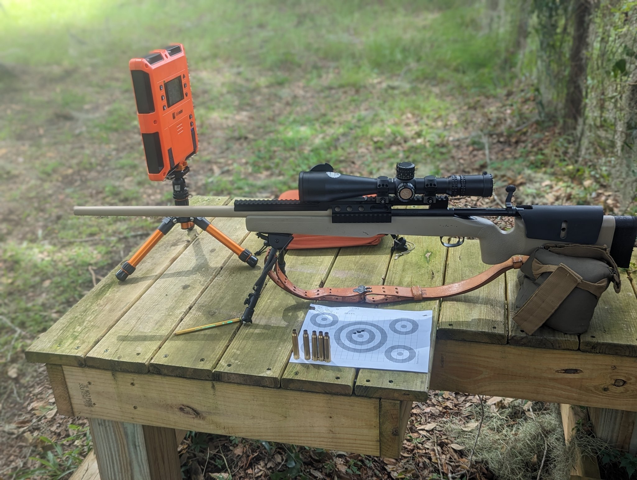

Well, might I inquire about your bipods? In the picture shared they look loose and I cannot tell but they appear to be the not cant version?
