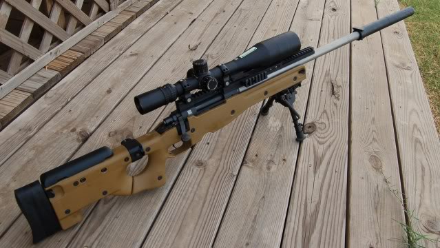

My Mk13 inspired 700 next to M24 and M40A5 tributes.
Thanks! Its taken a while to cobble all the parts together for them....

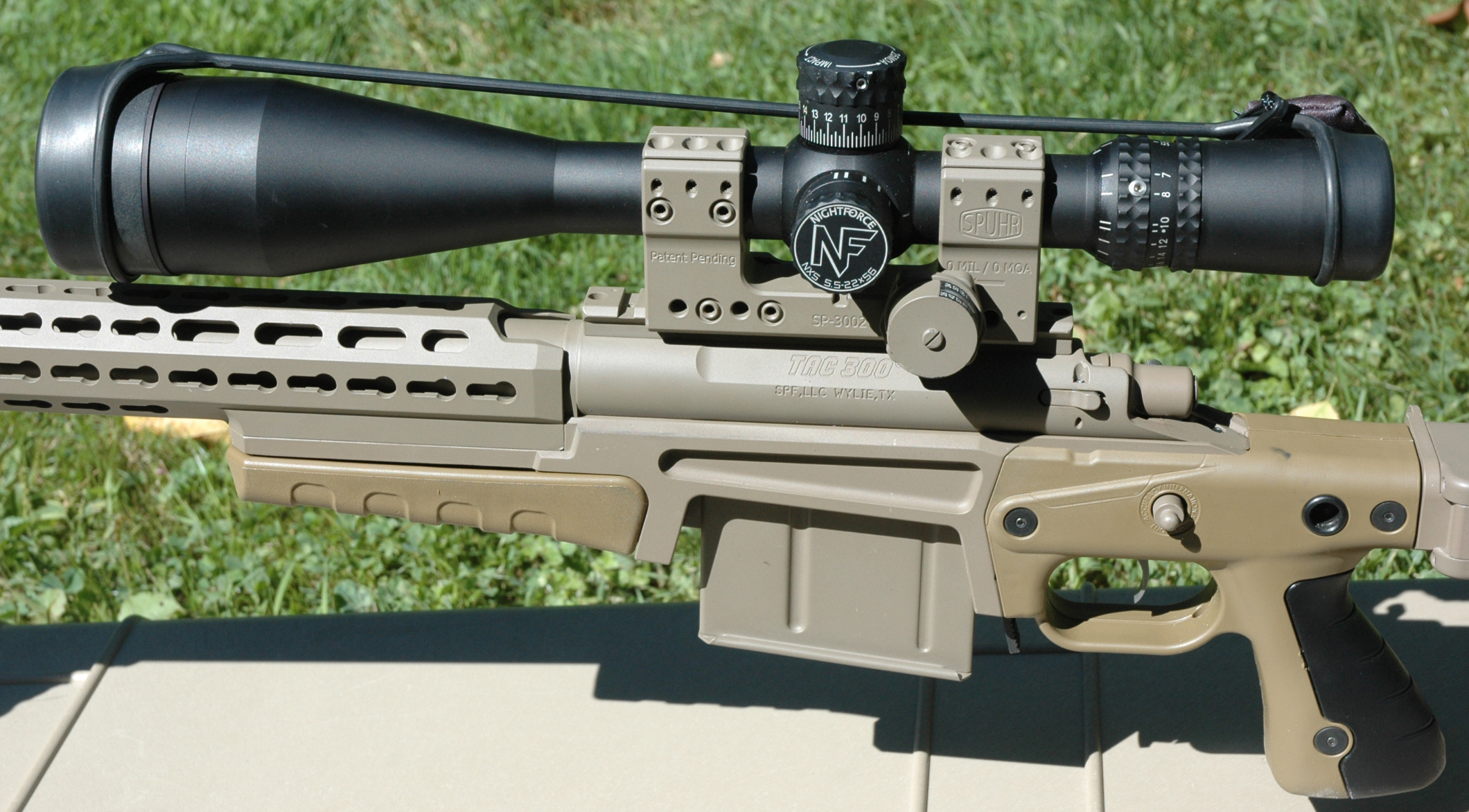

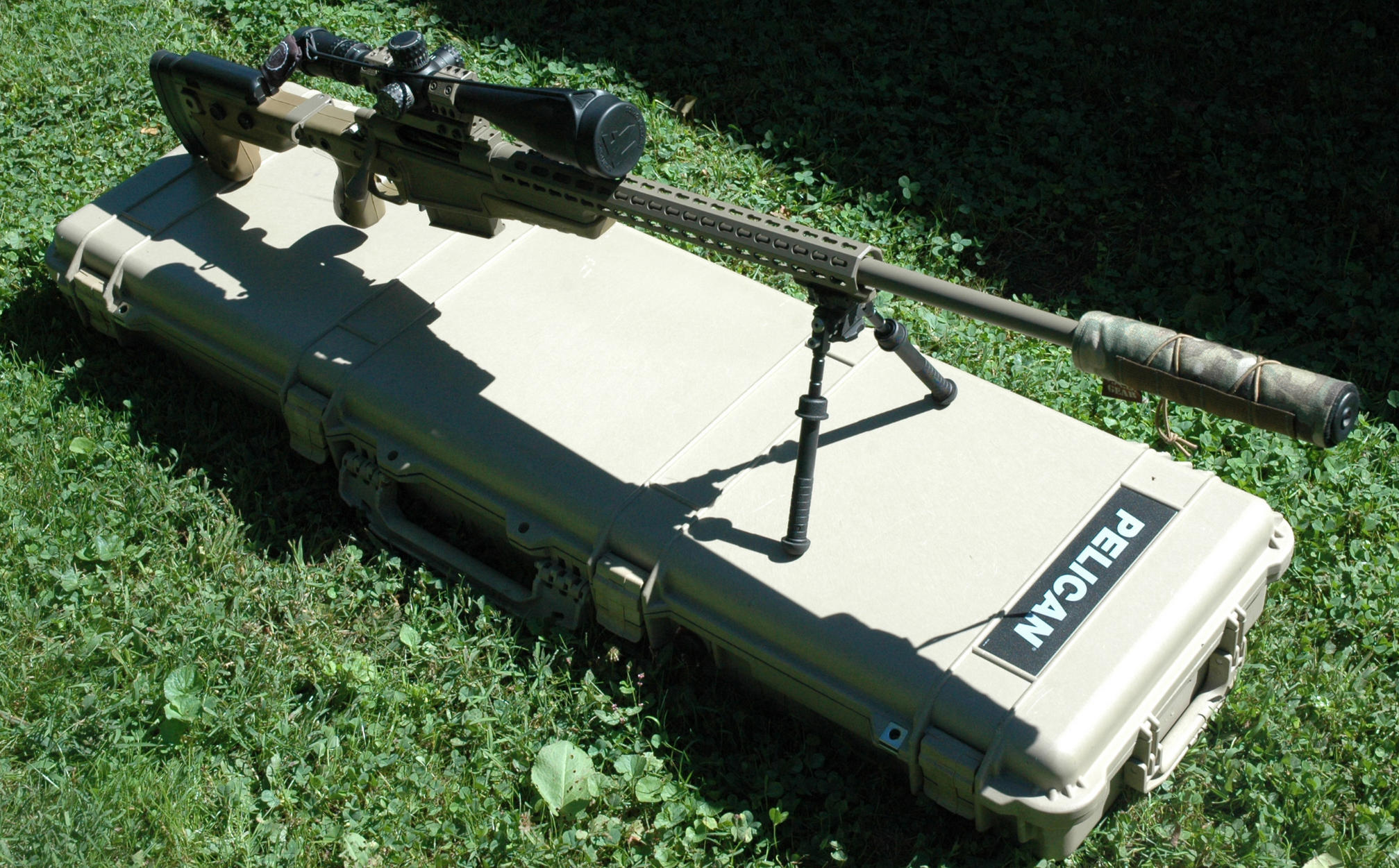

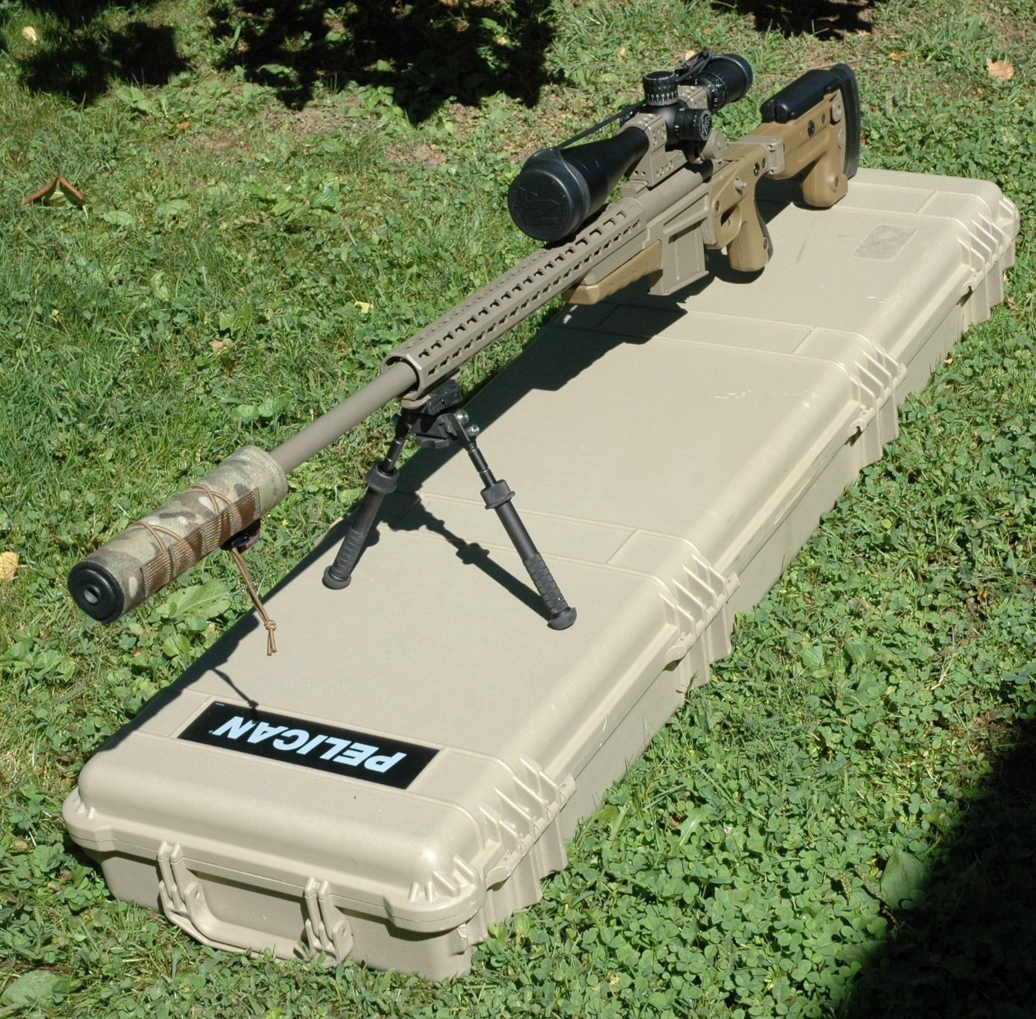

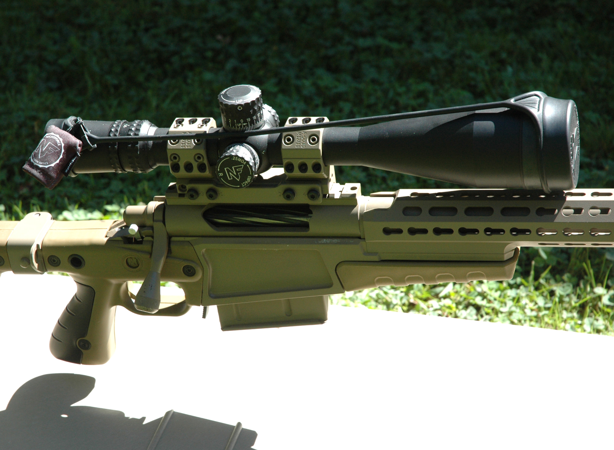

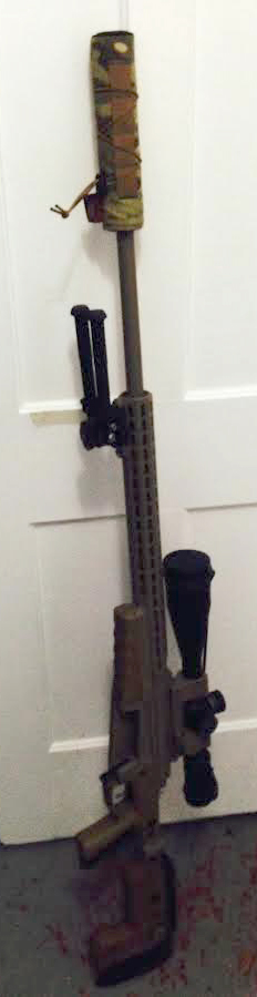

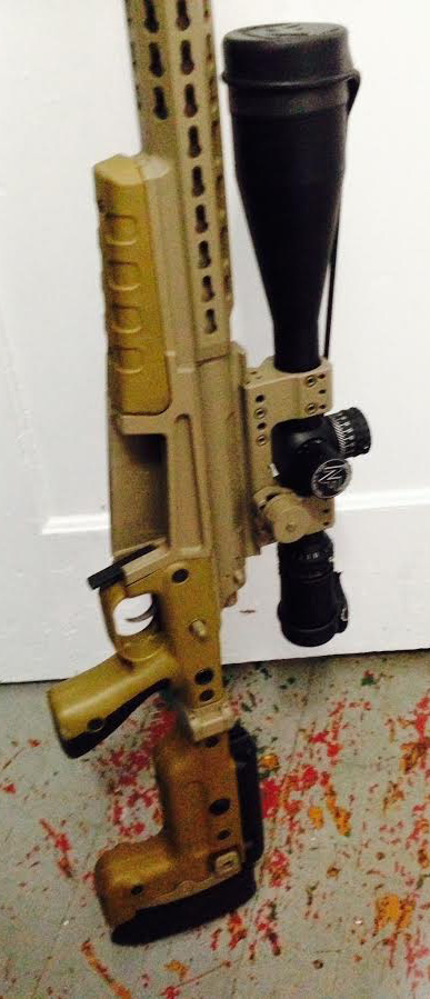

I promised you guys some pictures...Was a nice day yesterday so, I managed to snap a few before we headed to the range.
When I was building this rifle, a buddy of mine was using one on duty -- The specs for a Mk13 Mod 6 according to him were:
AICS AX Chassis - With 10" handguard
Lilja 26" M24 profile 1/10 barrel - Profiled for a KAC can - Ultimately that's based on unit.
MK13 Stiller action
Remington 700 Trigger (I was initially told the X Mark but, that's a big ?)
Nightforce NXS 5.5-22x56
Apparently for the mods before the 6, IE before Stiller won the contract, they used trued Remington 700's with standard trigger groups.
Crane also still has an open contract for information in regards to Carbon Fiber barrels: https://www.fbo.gov/index?s=opportu...&id=07f23672177b624da227573a9207752b&_cview=0
Good luck with that on a 300wm...
Anyway my build/tribute/clone - whatever you want to call it:
AICS AX Chassis - Cerakoted
Bartlein M24 5R 24 1/4" - Cerakoted
Jewel HVR-TS
Stiller Tac 300 - Cerakoted
Spuhr mount
Nightforce NXS 5.5-22x56 with an ADS
Surefire 7.62-RC Suppressor
I reload MK248's with 208 Amax / 220gr Match-King / 240gr Match-King.
Anyway here's the rifle porn:
What's the white shit on the magwell you ask? - It's actually bird-shit...Can't seem to get the rest off - Meant to try Goo-Gone but, haven't gotten there yet.
