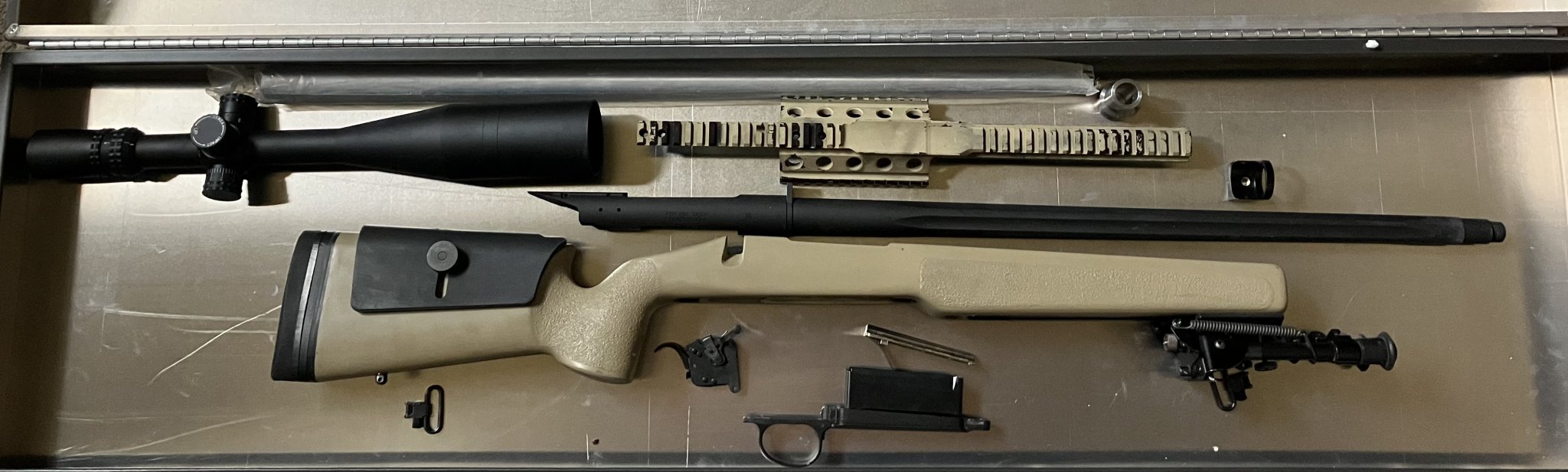

Having been bit by the MK13 bug during Covid, I have been quietly sourcing parts to send off for a MK13 mod 3 build. Being extremely new to this weapon, I wanted to verify a few things prior to sending off the items to the builder. Specifically, I am a bit confused regarding the firing pin, bolt, and extractor.
My current items already procured:
Lilja barrel
McMillan a-2 stock
McCann rail
Crane lug
Mk11 suppressor collar barrel adapter
Harris bipod
G6 barreled action
M24 trigger
8-32x 56 low speed NF
Heavy NF rings (not shown)
Turner saddlery sling (not shown)
Turner sling stock adapters
What I need:
Extractor
Firing pin
Ejector
Bolt

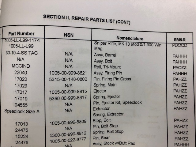

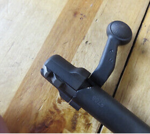

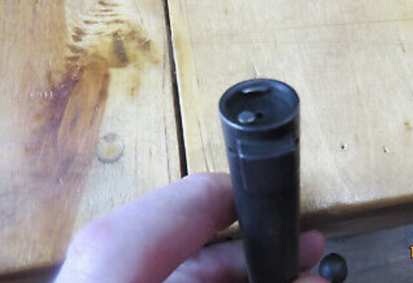

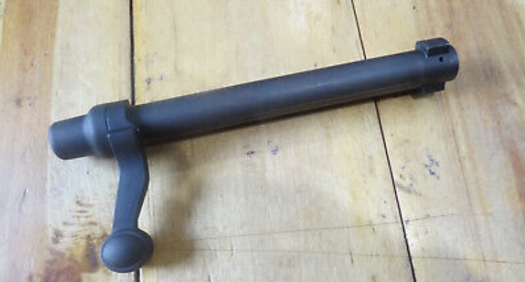

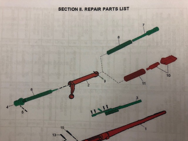

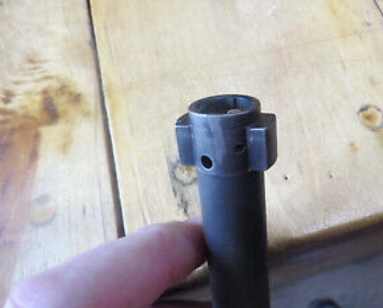

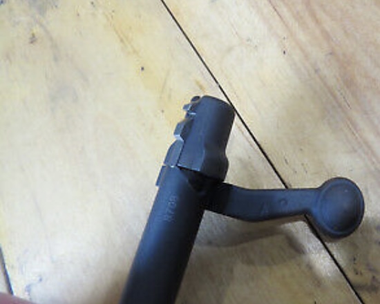

Does the item below check the boxes for the remaining items on my scavenger hunt list- ie bolt, firing pin, extractor?

Thanks in advance for any help/counsel/guidance on the matter. There are some guys here with above expert level knowledge.

Hope this helps:
Extractor, Speedlock Size A:
Firing pin, ejector and bolt - were all standard Remington LA M700 parts, although the bolt was modified for the 'Sako' style extractor.
(Note: Trigger was the standard M700 part with a trigger job, not the M24 trigger group, for what its worth).
Definitely helps. Thanks a million for taking the time to reply.
