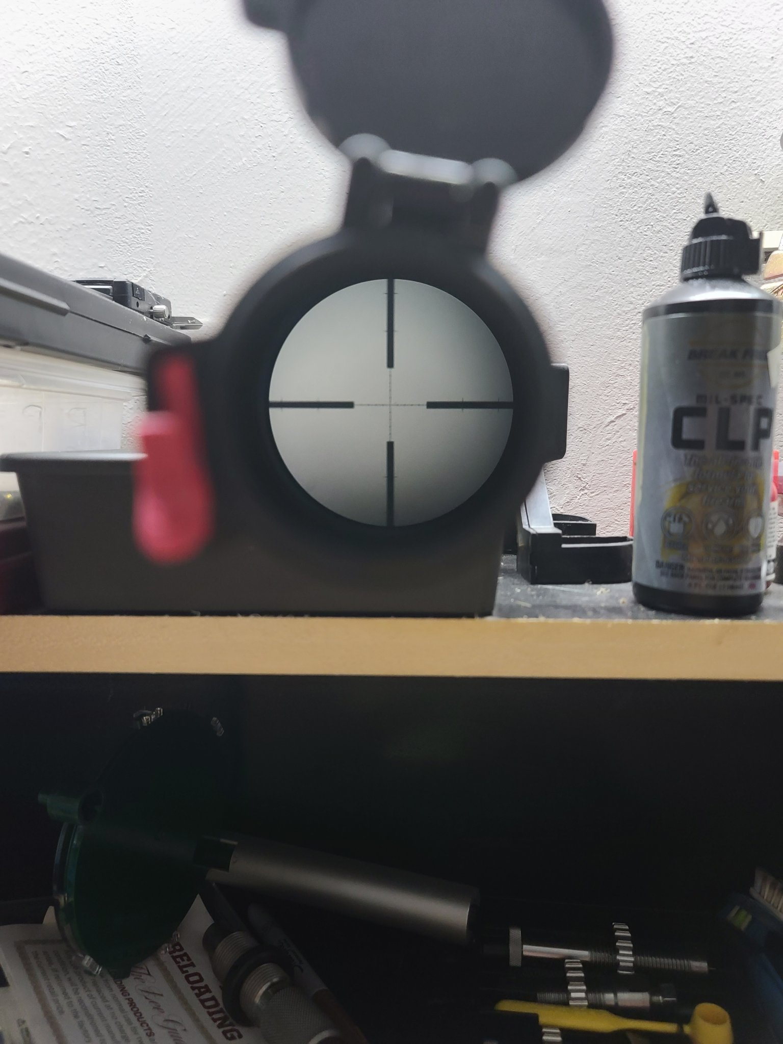

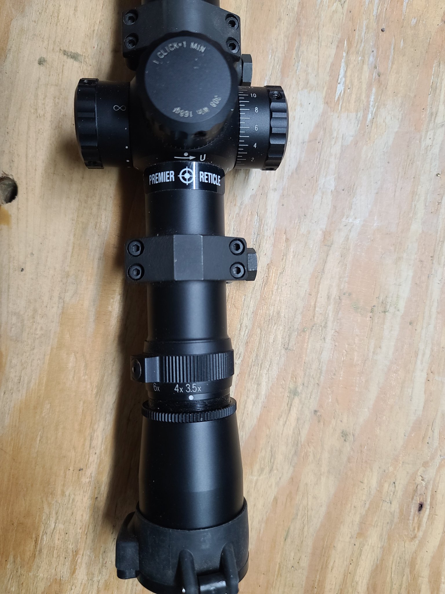

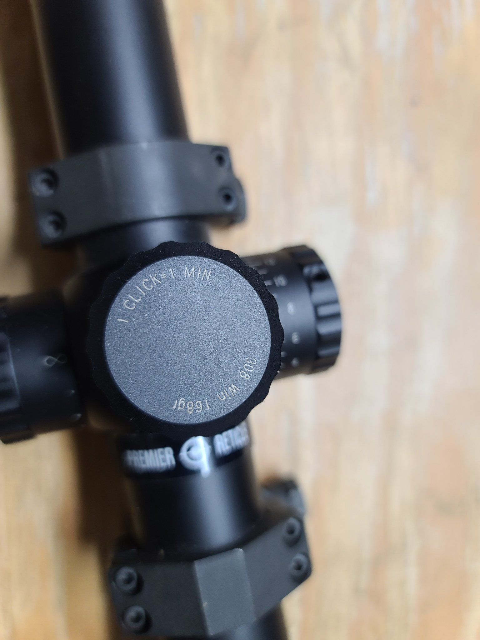

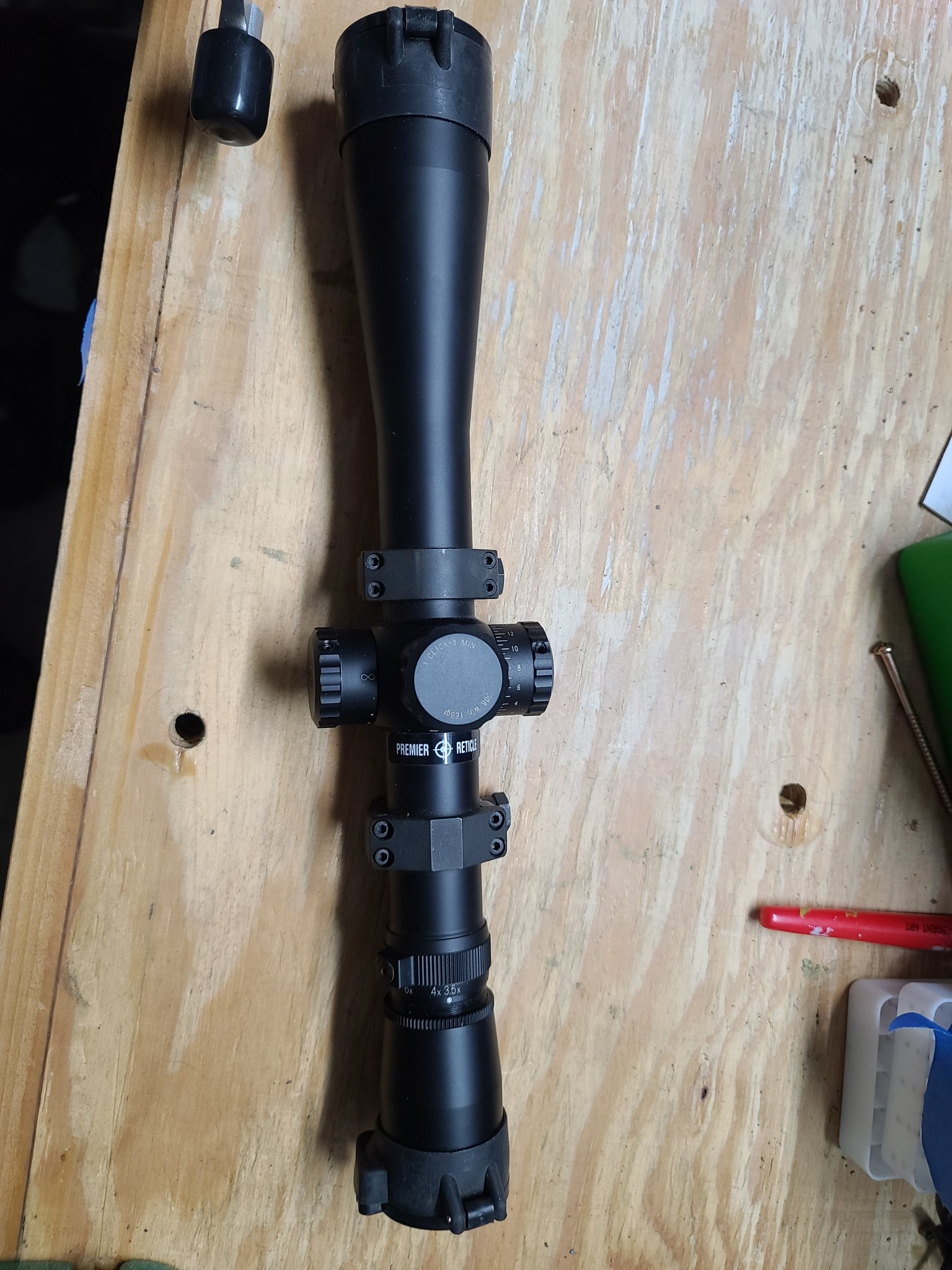

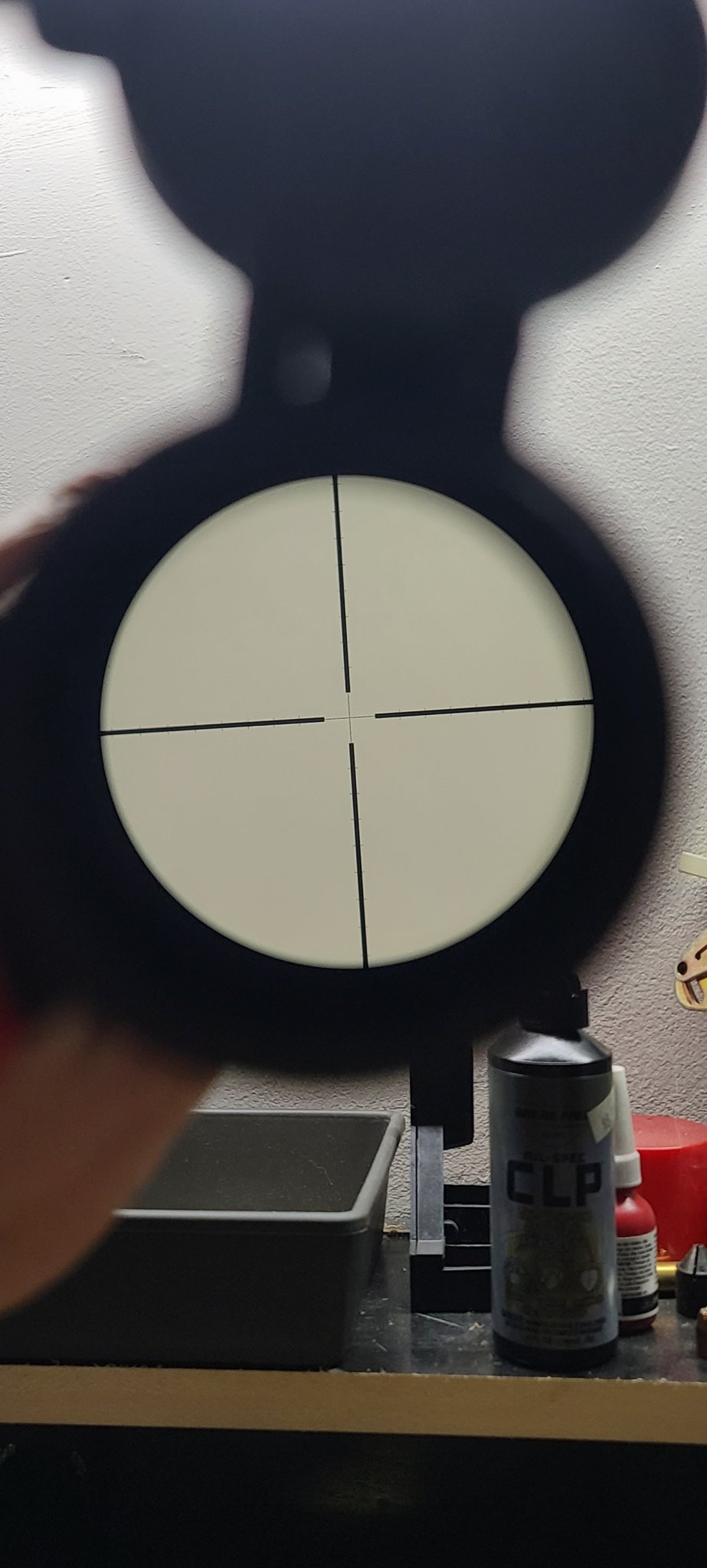

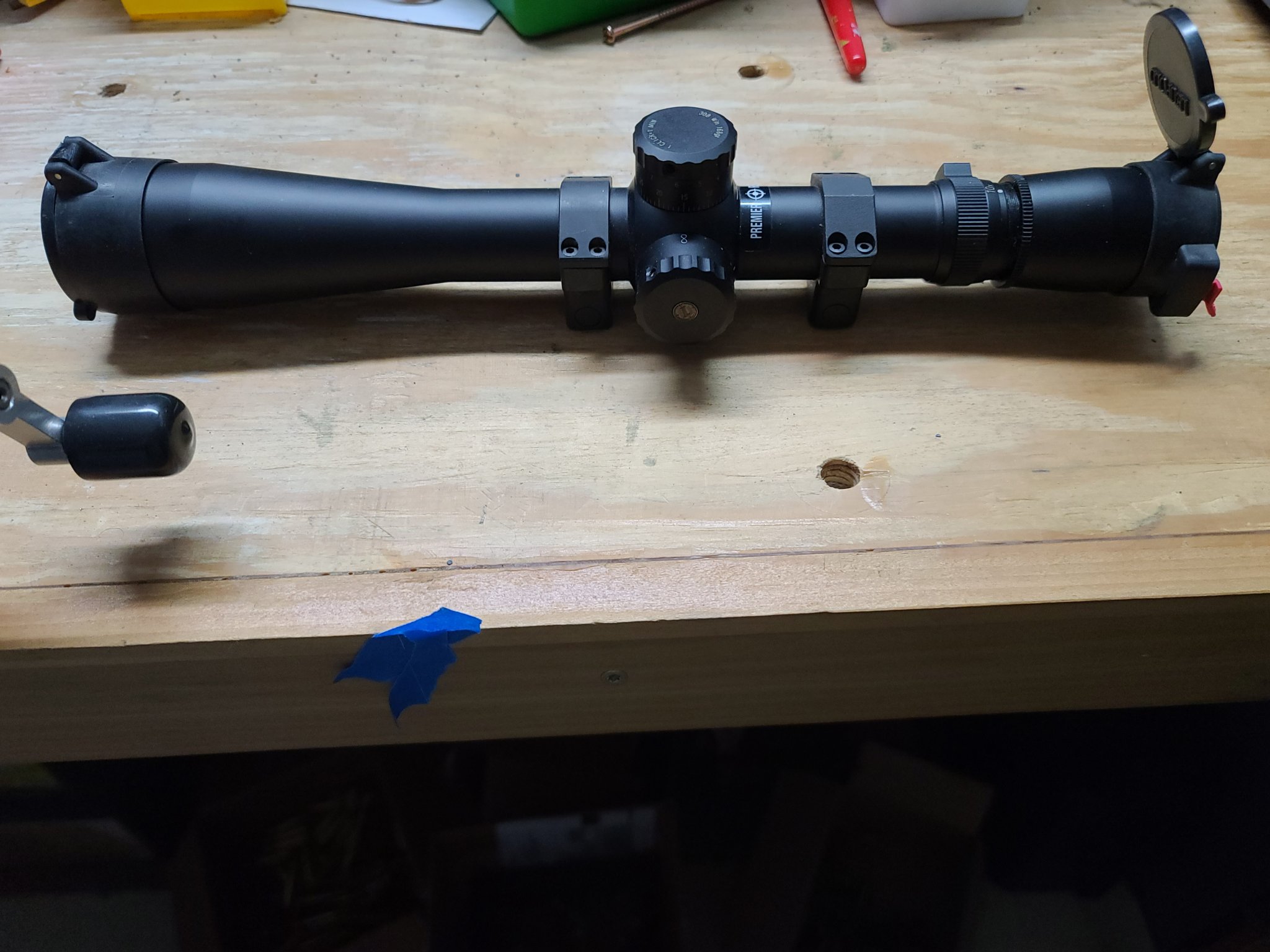

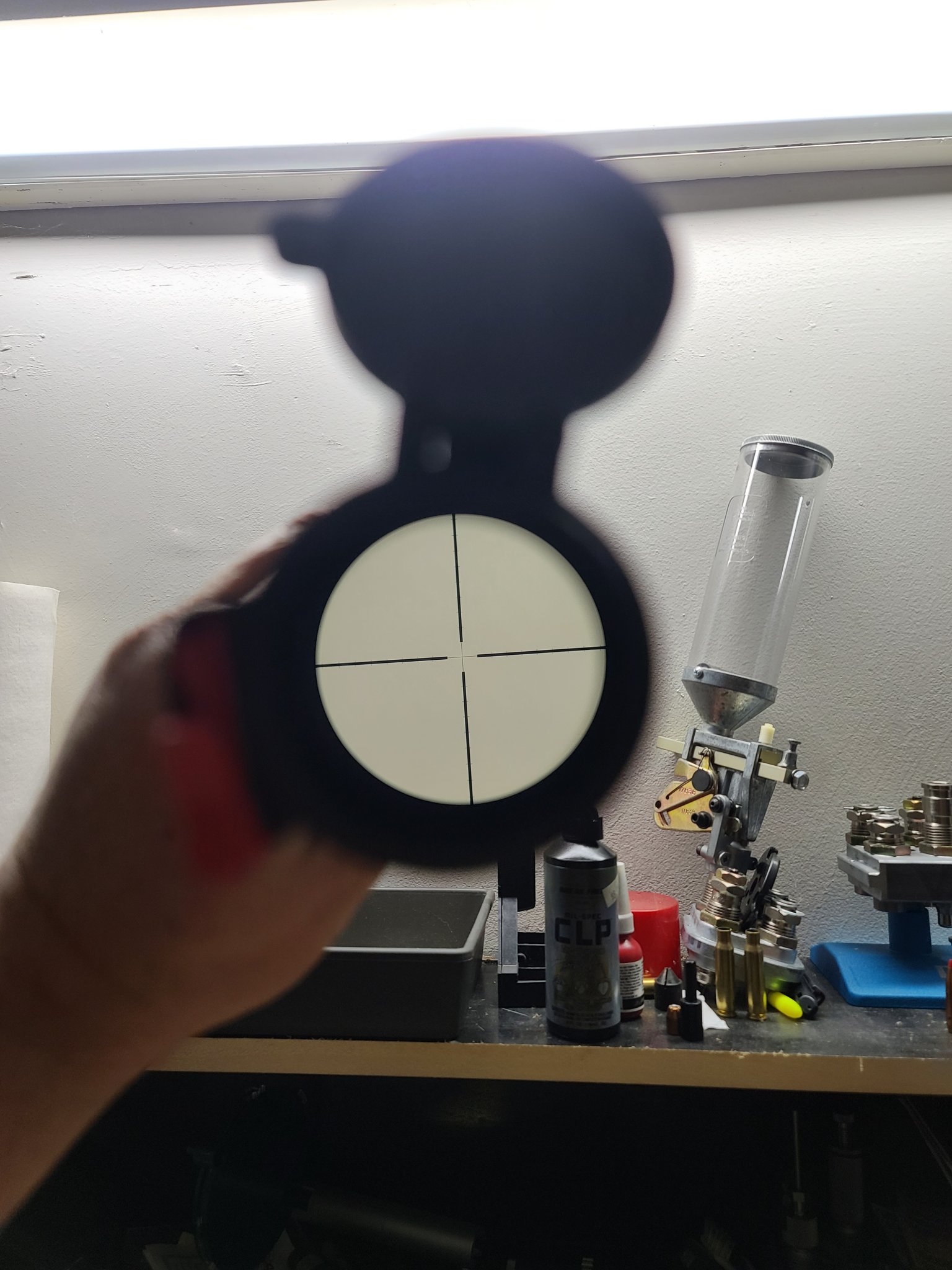

Hello all,
I have a Leupold MK4 LR/T 3.5-10 FFP with a premier reticles reticle. Does anyone have the specifics for the reticle? Most of the subtends are obvious but I'd like a little more info on it if anyone has some. Thanks!

Have you tried Leupold website,I'm guessing you might find it. Or you can call them and ask I'm sure they can help you out.
Thanks for the reply. The reticle is by a company called Premier reticles who is no longer in business. It's not the reticle that was in it when it left the Leupold factory.
Premier had a relationship with Leupold for some time but that evaporated.

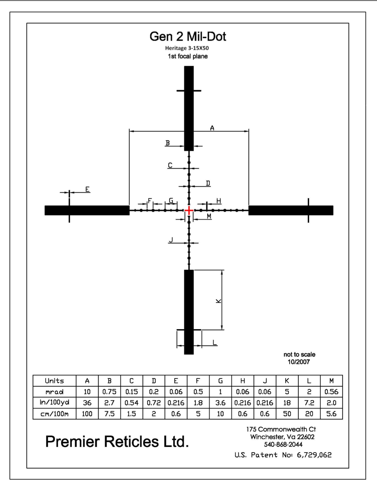

I can’t see the detail clearly. From what I can make out, it looks like it could be a Gen 2 mildot.
Does it look like this?
Or maybe call TT in Canada. Can't remember but when Premier stopped making scopes isn't that how TT started?
Reactions: kml990
Yeap mildot. I had one and sold it kinda regret since they are neat scopes for a 223 or 308 AR, or M1A.
Just kind of stumbled into it. Have it on an AR 308 right now. For an older scope I have to admit it's pretty neat.
