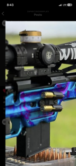

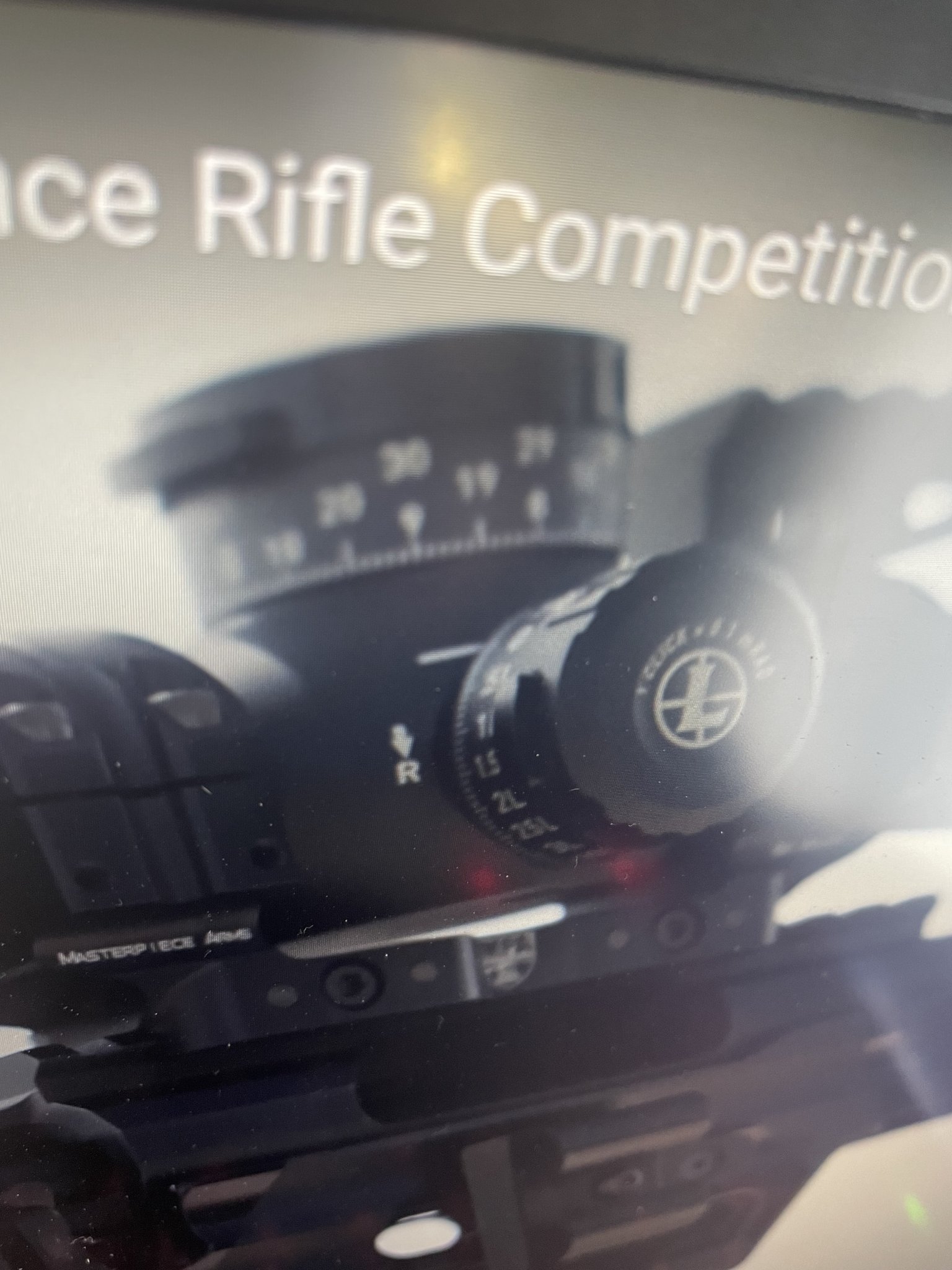

Anyone know about these locking windage knobs on the mk5

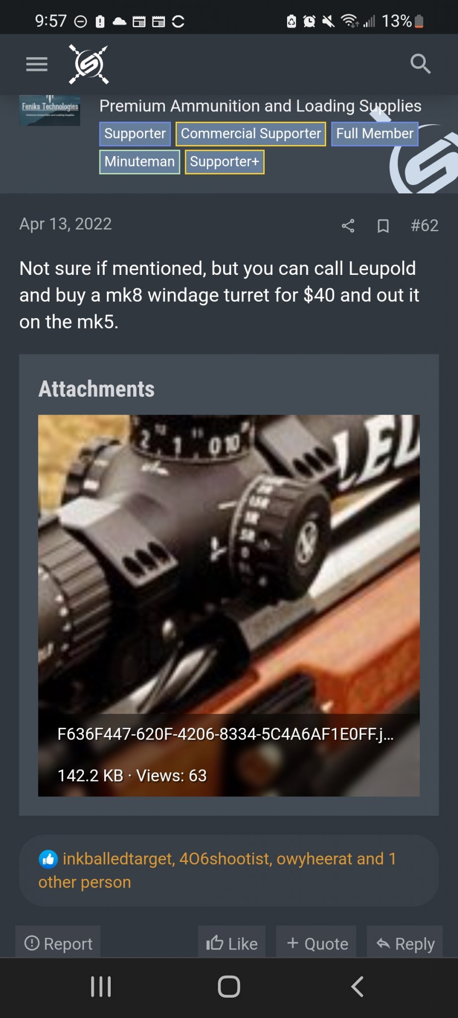

Oh look, a way to know you’re actually on zero on the windage of a Mark 5. That’s a first. Guessing those aren’t available to the masses.
After further looking it appears people are using the windage knob off of a mk8. But I haven’t positively confirmed it yet.
Doubt you could just swap them over. The locking feature uses a raceway under the cap that is part of the turret. Wouldn’t work without it.
3.6-18 with pr1 or 2 mil and locking windage would be a hell of a crossover, hunting, or light tactical scope. I did feel the 3.6-18 had noticeably less IQ than the 5-25 version however.
Maybe the lock doesn’t, but it gives a larger turret. Idk. But there is a thread on here saying that’s what is being done. I messaged those I’ve seen with it. And awaiting responses still
I saw a post with a picture with a MK8 knob on the windage but I can't remember for the life of me who did it. But I will be grabbing one here shortly when my MK5 arrives
So I found it here ya go*
So I found it here ya go*View attachment 8131667
Same thread I saw. However I would like a little more confirmation then this. Especially due to last experience from that particular individual
