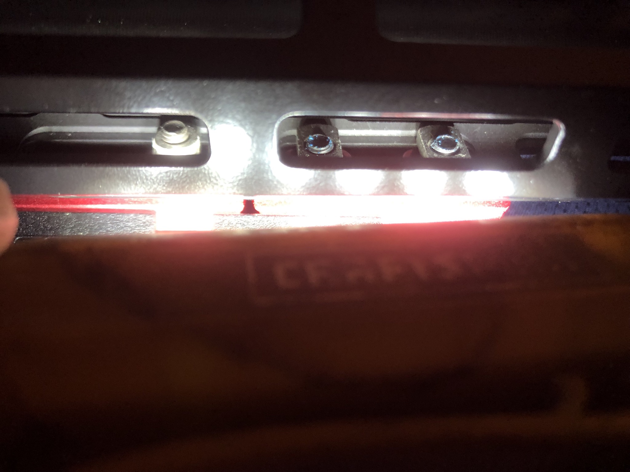

Howdy, thank you for this thread as it helped me out and I would like to share what I found.
I have used McMaster-Carr in the past and when you need a hard part to find they are the go to...

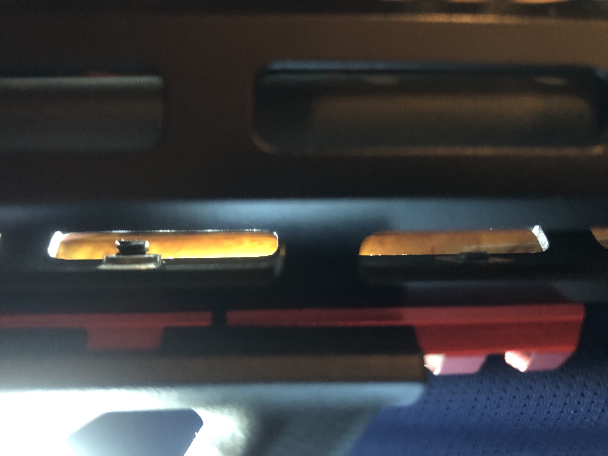

I got two sizes, 5/16” and 3/8” and was trying to get torx-plus but could only find them in 3/8”... the thread pitch is 10-24...
So the 5/16” hex head #91255A234 was the perfect size for my project and is almost flush with the t-nut... In the attached pics I replaced the screws to the right to show the difference from the screws that came with the rail attachments.

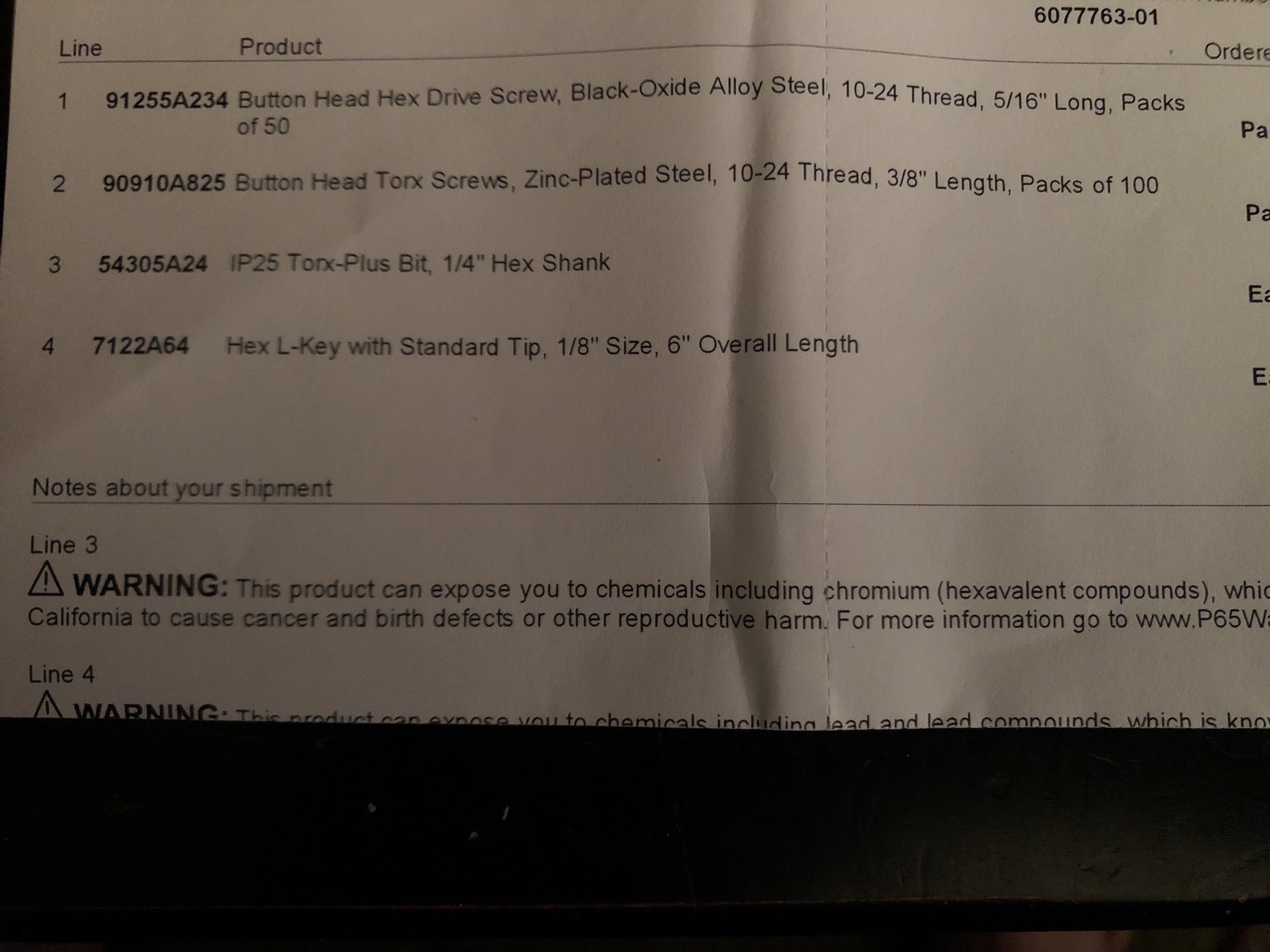

Also I called MAGPUL as suggested and they sold me 20 t-nuts for .98 cents each(I wanted a few extra)...
I will also send a pick of my order list as I got a torx-plus bit and a 6” 1/4 hex key(for a better fit)...
