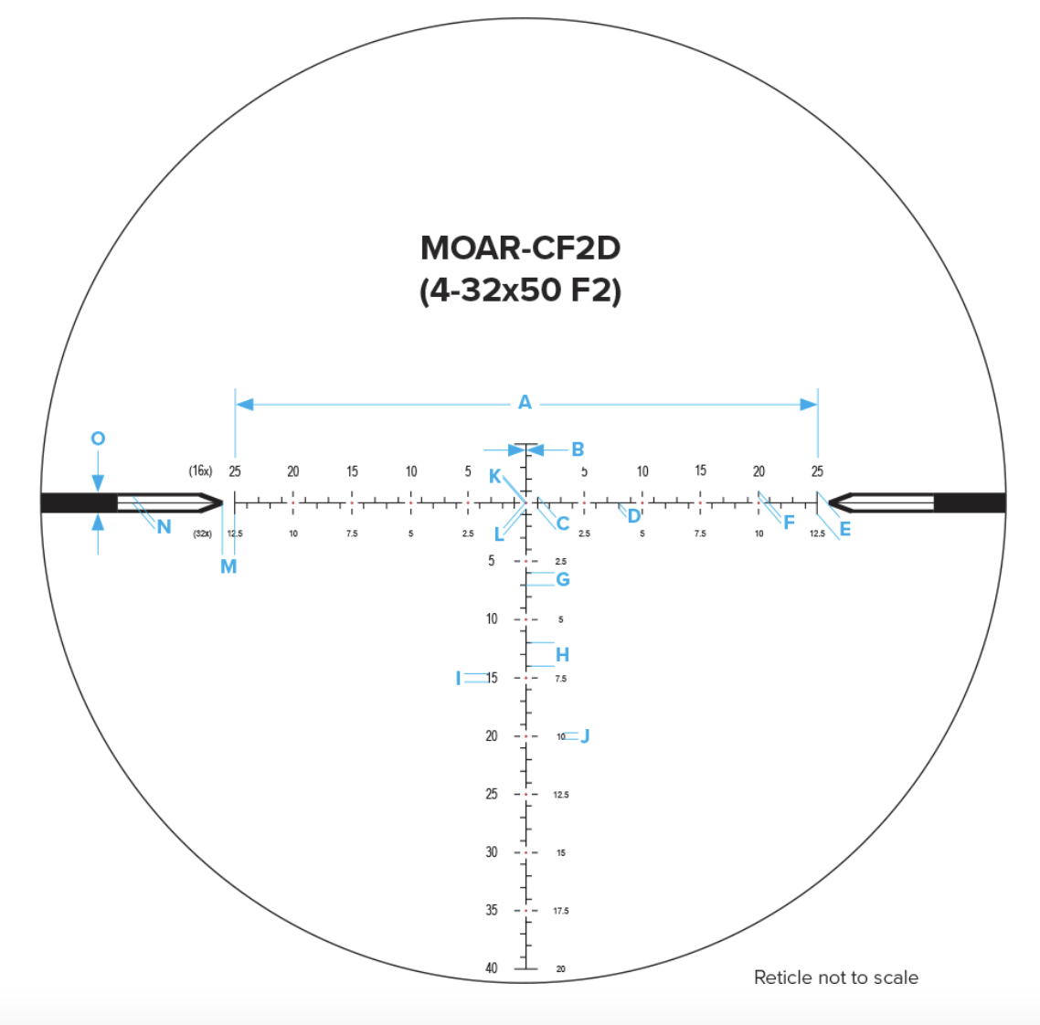

Negative ghost rider. You CAN dial, even if not on the zoom that is "correct" but you should know what you are doing. For example, if your SFP reticle is "correct" at 20x generally, it is two times that correct at 10x. Here is an example of one.
Even an old 3-9 duplex second focal plane scope with the capped turrets can be "dialed" for elevation by using the zoom feature. But you gotta know how far down the top of the arrow on the fat part of the reticle is. You can fairly accurately guess 1/2 or even 1/3 or 1/4 of that reticle. If you shoot it at say 3x at the top of the fat part and then again at 9x, your bullet will impact in different places. If you figure that out at 3x, 6x and 9x and then take some practice shots at each of those zoom levels for 1/4, 1/3, 1/2, 3/4 of the reticle and write that shit down, you can use a laser range finder, look at your DOPE, choose the zoom and hold...
MOA scopes typically dial in 1/4 MOA clicks which is a more fine angle than 1/10 MIL. This makes MOA better for benchrest. With MOA reticles, however, they *typically* have hash marks every MOA which is equivalent to hash marks every .29 MILS which makes MIL scopes with hash marks every .2 MILS more fine. This makes MILS better for PRS where you tend to holdover for wind and follow-up shots.
MOA scopes typically dial in 1/4 MOA clicks which is a more fine angle than 1/10 MIL. This makes MOA better for benchrest. With MOA reticles, however, they only have hash marks every MOA which is equivalent to hash marks every .29 MILS which makes MIL scopes with hash marks every .2 MILS more fine. This makes MILS better for PRS where you tend to holdover for wind and follow-up shots.
Quite literally 2 posts up is just one example of an MOA scope that has stadia marks at 0.5 MOA.
Negative ghost rider. You CAN dial, even if not on the zoom that is "correct" but you should know what you are doing. For example, if your SFP reticle is "correct" at 20x generally, it is two times that correct at 10x. Here is an example of one.View attachment 8319661
But you stated that it works "no matter what the zoom is set at" on an SFP scope.
It does matter what the zoom is set at if you are using the reticle to measure the amount that you need to correct, and dial accordingly. If the zoom is set at a value that makes the reticle 1:1, then dialing or holding will work. If it is not 1:1, and you are going to correct by dialing, then you need to know the ratio and do a little math.
