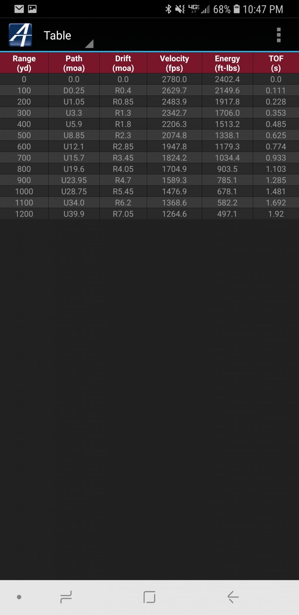

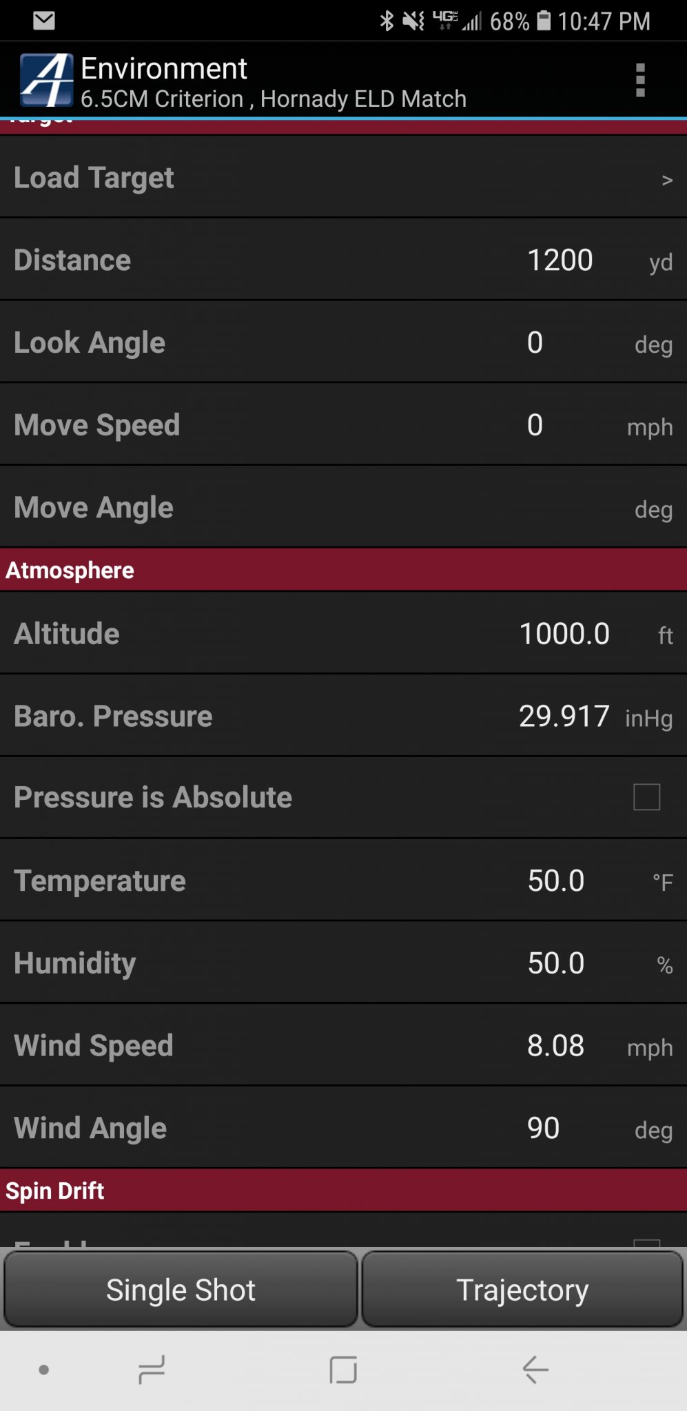

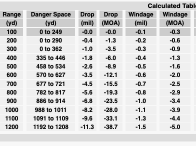

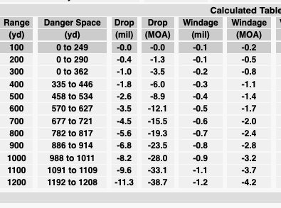

    Wind 400yds = 2moa per 8mph (AB says 1.8MOA)
    600 = 3 moa per 8mph (AB says 2.85 MOA)
    900 = 4.5moa per 8mph (AB says 4.7 MOA)
    I ran the above mentally first using above method and then put in the calculator created to check:
    Inputs:
    I've run this with 69TMK, 77 SMK, 88 ELD, 123 SMK, 140 VLD, 140 ELDM, 175 SMK at various speeds and in all but extremes (very fast/light or super high elevation 5000+) it's within about +-1/2 moa on most bullets within the first 75% of supersonic flight. It will start to diverge a bit when approaching transonic range AND/OR when using midweight bullets for the caliber.
    Thoughts?

    @Subwrz300, I like it.
    I took the "hunt and peck" approach - entering different direct crosswind numbers in the ballistics software until I got a "wind-cheater" value that lined up with 1/2 MOA wind drift every 100 yards under a 1/4 MOA resolution.
    I wonder if your approach to add the G7+ G1 numbers works across different long distant bullets/cartridges. It would not surprise me as software is driven by those inputs.
    At the end of the day this method is an easy way to come up with a good "SWAG" for wind. Shooters will need to do some truing and a lot of field verification. But it is a great way to start.
    This will work for the MOA guys. Its easy to explain and everyone can remember that 9 mph = 1/2 the distance in MOA wind call.

    @300ATT I ran it for several bullets in .224, 6.5mm and .308 Cal. Most worked perfectly but the midweight bullets for their diameter usually overestimated wind at shorter ranges (.75moa or so) and started lining up better at 30-40% of supersonic flight.
    3-oh-hates understimate wind until you get to a 200gr bullet or so.
    I have yet to find software that doesn't underestimate wind for the 3-oh-hate. Easy fix:
    Start off with start a lower wind cheater number ( 7mph ) and hold 1/2 the distance in MOA and use the "hunt and peck" method with software to fine tune the base number for your .308.
    There is a noticeable difference in wind-cheating between my 16" .308 and 29" .308 Palma rifle ...
    Here's my take on this, with MILs I find the point where I'm at 1 MIL drift at 1k, winds up being 8mph and within a tenth lines up at all yard lines. So with an 8mph wind I'm at .4 at 400, .7 at 700, etc.
    Then it's just a matter of multiplying or dividing based on conditions. If it's a 4mph wind then I'm at .2 at 400, .35 at 700, etc.
    It's definitely weird with MOA, but if you find the point where it lines up at 500yds but twice the value, you can do the same thing. So for my gun 5mph gets me 1 moa at 500, 2.3 at 1k, etc. It's basically double the yard line. So at 300 it's 0.6 moa, 800 is 1.8 (1.6 is close enough).
    It's not perfect but you're close enough if doing this on the fly via the quick n dirty approach, which I think is the goal, right?
    If we're within a tenth of a MIL or one or two tenths of a minute, that's small enough a difference to be "in the noise"
    If time and opportunity allow it, use a kestrel or a chart. If those aren't available for some reason, doing it this way with either system is simple and gets you damn close.
