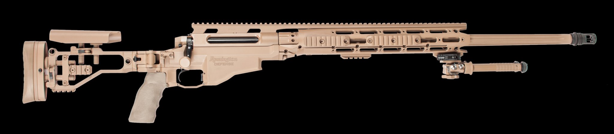

    So, I bought one of the last Remington MSR's that anyone has in stock across the country as I understand it (and have been told). Remington halted production on the MK21 right after they lost the SOCCOM PSR contract. I say lost whereas it was more of a "I give up" sort of situation there. What remained was deployed, the rest sold to parts houses, armories and distributors. Remington Defense didn't even want to hear the name MSR - in fact they transferred me to person that has the job of telling people that they no longer "manufacture, support or distribute any item or service for the MK21 as of this time". I think they "do ammo" now, that's it. Surprising considering the ASR contract hasn't "officially" been awarded. Well, publicly anyhow.
    And we thought original AW skins were hard to find...
    PITA #1: Barrel extensions. These are like unicorn teeth. Dave Tooley has been kind enough to inform me that he has some left over from his original involvement. He is spinning up a 300NM/338NM barrel(s) for me once he has blanks available.
    PITA #2: It has a proprietary mag well, measured it 40 times. I was in disbelief the other 39. The magazines are no where to be found - no where. I have 1, 338LM. It looks identical to a SSSF AWM magazine with a follower insert, except as wide as a AW DSSF and 4.2" long. By the luck of contact, Accurate was the company that designed them specifically for the MSR/PSR. They are going to make me 2 more... whew! It seriously took me 2 days to track this down through various channels.
    PITA #3: Fire control. Sure, I'm a fan of the M24 trigger; on a M24. I worked a little magic and got it down to about 4 pounds but that's it. I'm not going to start stoning it or anything like that. I really want a 2-stage trigger anyhow. Luckily out of everything this has been the easiest item to procure. Tom Myers, owner of X-TREME Shooting Products (if it sounds familiar, his company is responsible for the AI Competition Trigger), along with the highly-respected MOD21 and MOD22 triggers originally worked on the PSR solicitation with Remington. He is making a custom MOD22 trigger that will fit this rifle; the second to ever be made, other than the one in his own MK21. Tom is a great guy to talk to also, absolutely packed full of knowledge. I personally think his products are hard to beat.
    PITA #4: Barrel changes. Although not a problem, what a true pain in the ass. AI has ruined me with their barrel change system. AI absolutely has the best system in place out of any quick-change system today. The method for the MSR is just cumbersome. This rifle will live it's life as a 300NM and 338NM most likely though. Maybe even just one of those, considering.

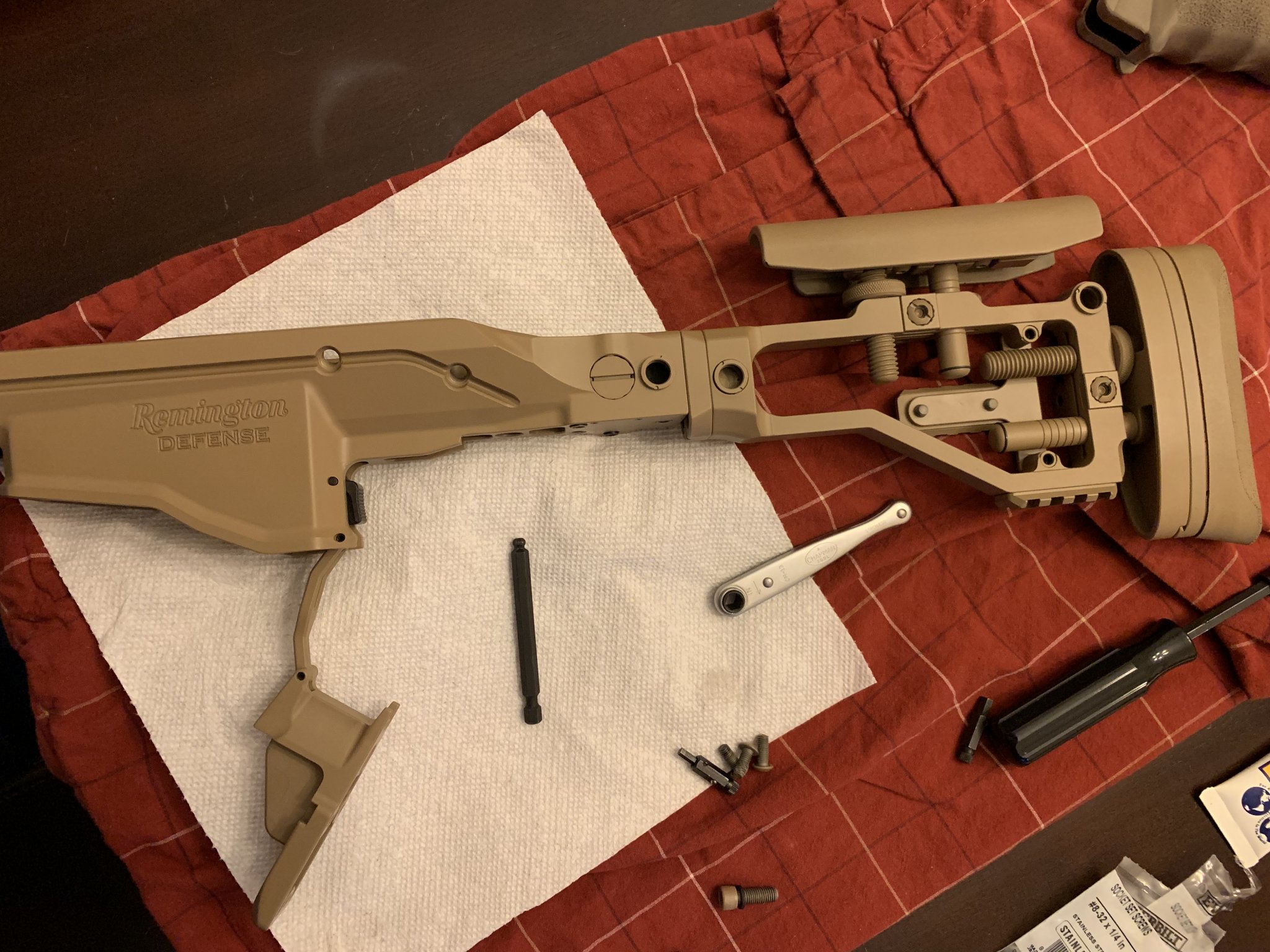

    PITA #5: Parts. Yeah, the RACS chassis can be had if you really wanted to spend that money to get replacements (stupid expensive). Bolt heads and the firing pin assembly may be an issue. I'm still trying to see if I can track a spare 338LM bolt head and a firing pin assembly down. I don't expect any luck though there. I might make a mold of it or take some detailed measurements in case I ever have to have one custom machined.

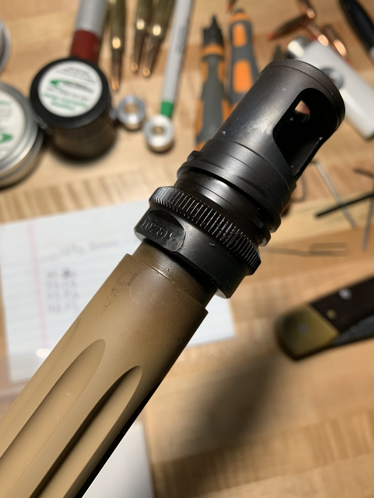

    Looks like this AAC QD brake is going to get cut off of the factory barrel too. Small, careful slit right above the barrel threading should relieve the tension. Not that I really care about the factory barrel (only the extension). Worst case, I'll chop it down and turn it into a subsonic tube. Heat, torque, more heat, soaking, more torque... it's not coming off. Gave up at 500 ft/lbs (yes, not kidding).
    I can only assume that it's been affixed with Rocksett AND Loctite Red, on top of that I believe it's been nitrided on there. 1st time I've ever encountered a muzzle device this stuck and I have had some crazy ones.

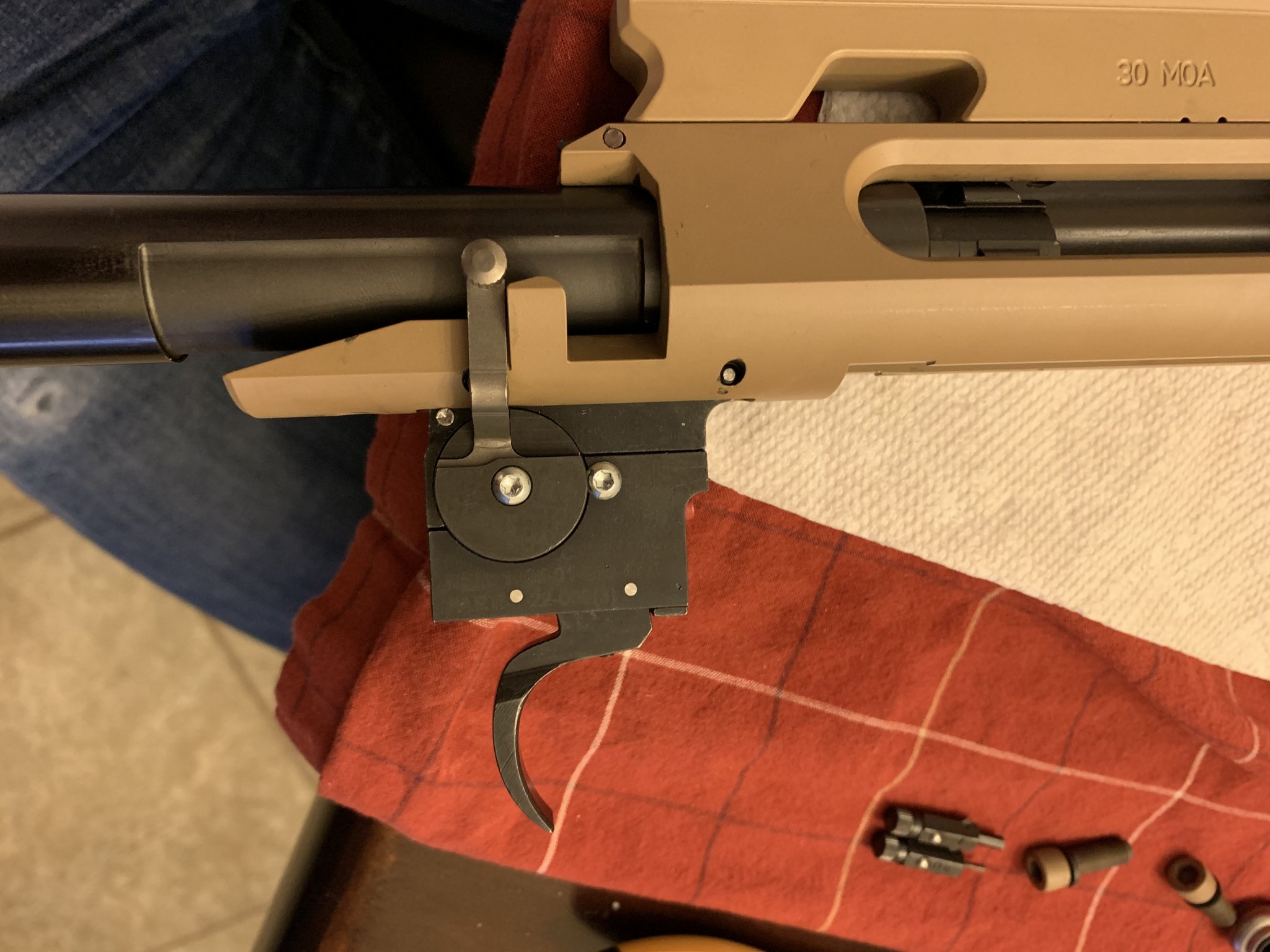

    Trigger install went as planned. "Thank you" to Tom Myers for working up a MOD22 trigger pack for this platform.
    7057407
    7057408

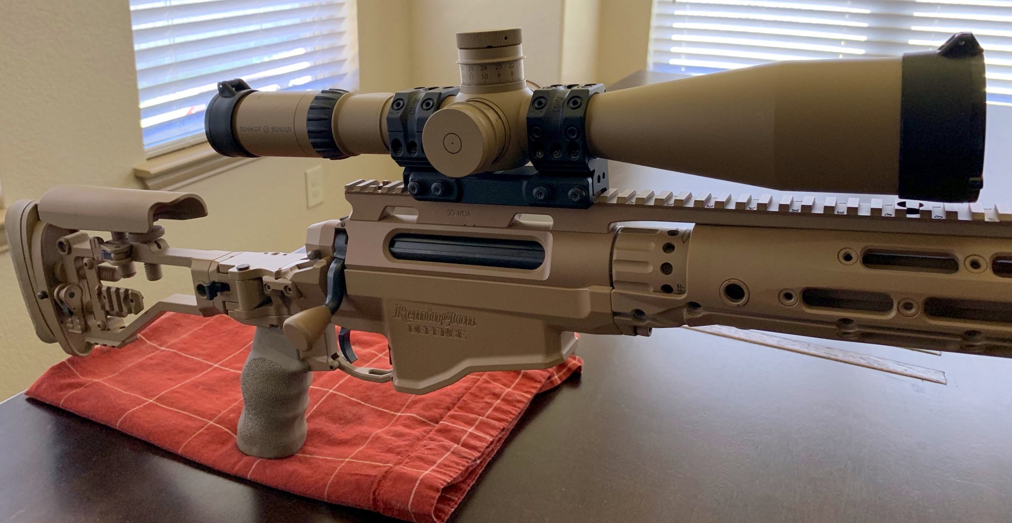

    Well, it has glass on it now. Thanks @jb1000br as usual for taking my money and in return sending me this S&B 5-25x LRR-MIL. Just checking out the reticle here in the house prone behind the rifle I can feel that it's a perfect match for the intended usage. I'm liking it before even sending a shot with it so that's a good sign. We will see how it holds up in vegetation.
    That's a Spuhr SP-4302 that it is mounted in. It's a damn shame these (still) come with Butler Creek caps. As soon as (by that I mean the exact minute I get the notification e-mail) Tenebraex caps are back in stock it will be getting a set just like all of my others.

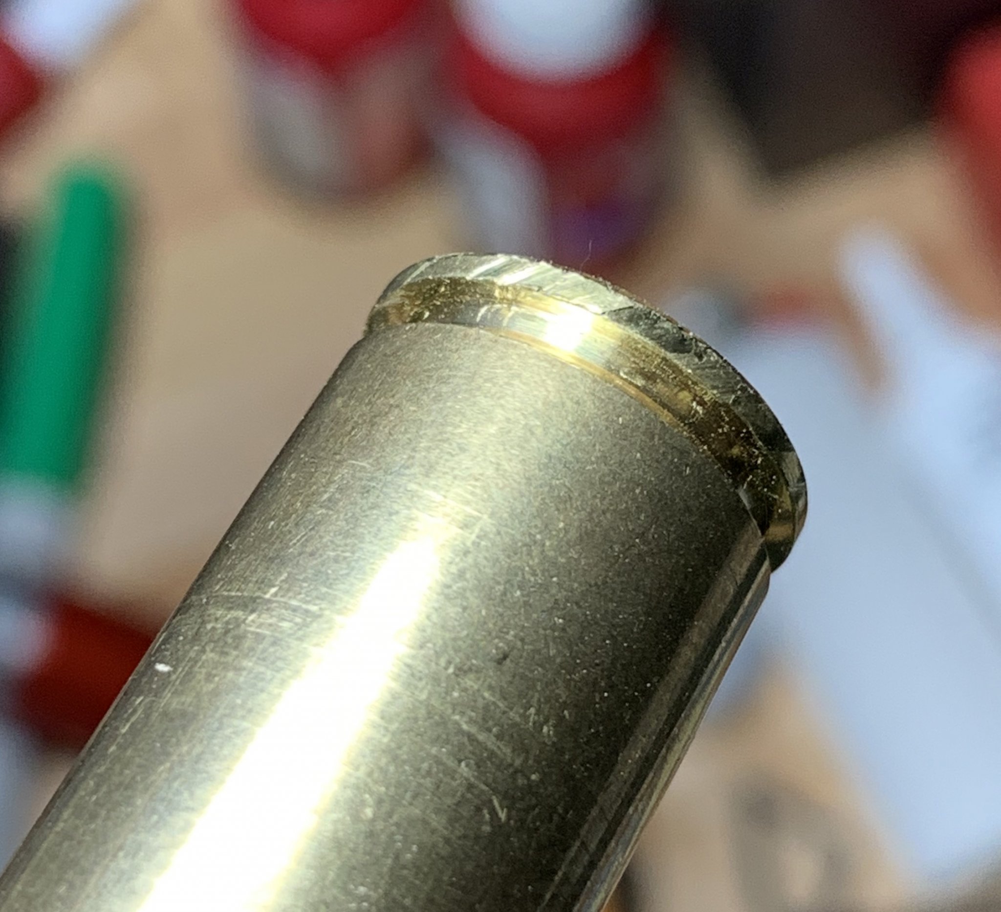

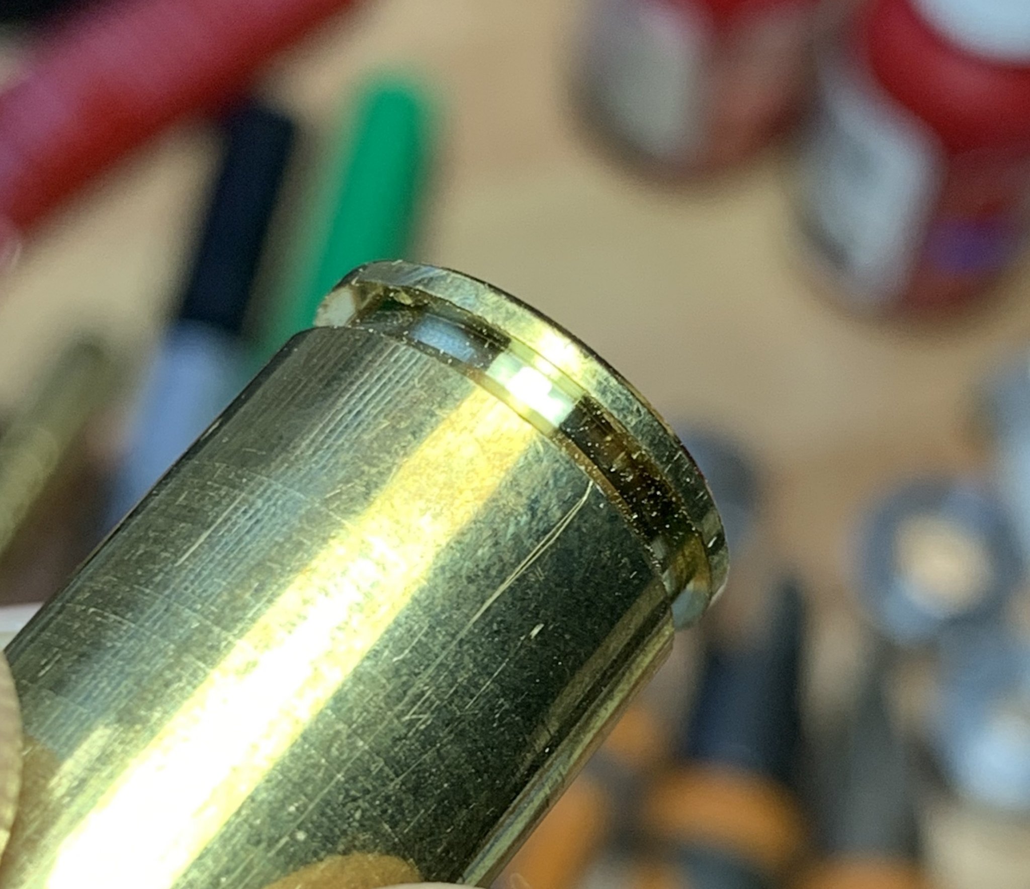

    After installing one of the barrels, I noticed some random difficult bolt closing utilizing the same piece of brass while performing some measurements. Felt the same (randomly) with both an unfired piece of Lapua and Norma - my only pieces of those. Noticing extreme notching on two faces of the rim (and a brass particle covered bolt-head) I could tell that the extractor was going to need some work. Simple procedure: Knock roll pin out for extractor, stone a 45 degree angle on each side of the extractor, debur where applicable. Keeps the extractor from grabbing the rim and trying to rotate the entire cartridge in the chamber.
    Before - 15 chamberings:
    After - 15 chamberings:
    Process is simple and problem solved. Same as any other M16-style extractor. Used a random extra-fine sharpening stone that I had around. I am really surprised here, because this would have been a small problem for a fielded rifle. Not a stoppage, but significant force was required to go into battery.
    I originally though that perhaps this Peterson brass was out of spec on the rim, but turns out it's not. At least not enough to matter. (It's thinner by about 0.015" if I remember). More on this Peterson 300NM brass debacle...
    So I knew that Peterson version 1 300NM brass was slightly out of spec at the web and in headspace. I didn't quite think it would be such a problem so I didn't initially go through my typical fire forming process, but it turns out that it was. Performed some H2O measurements and plugged a few numbers into QuickLoad. I loaded up a few rounds and headed to the range. 225g ELD-M, .010 off the lands, 85g of Retumbo. New brass is about .020" short in headspace (verified with a fire-formed case). Firing these resulted in massacred primer pockets, and obviously the bolt face took the entire slam force of these few rounds that I fired. Unfortunately I didn't photograph those cases as it was about 105 degrees that day and I had a lot going on. I did not fire the rest that I had loaded and pulled them down.

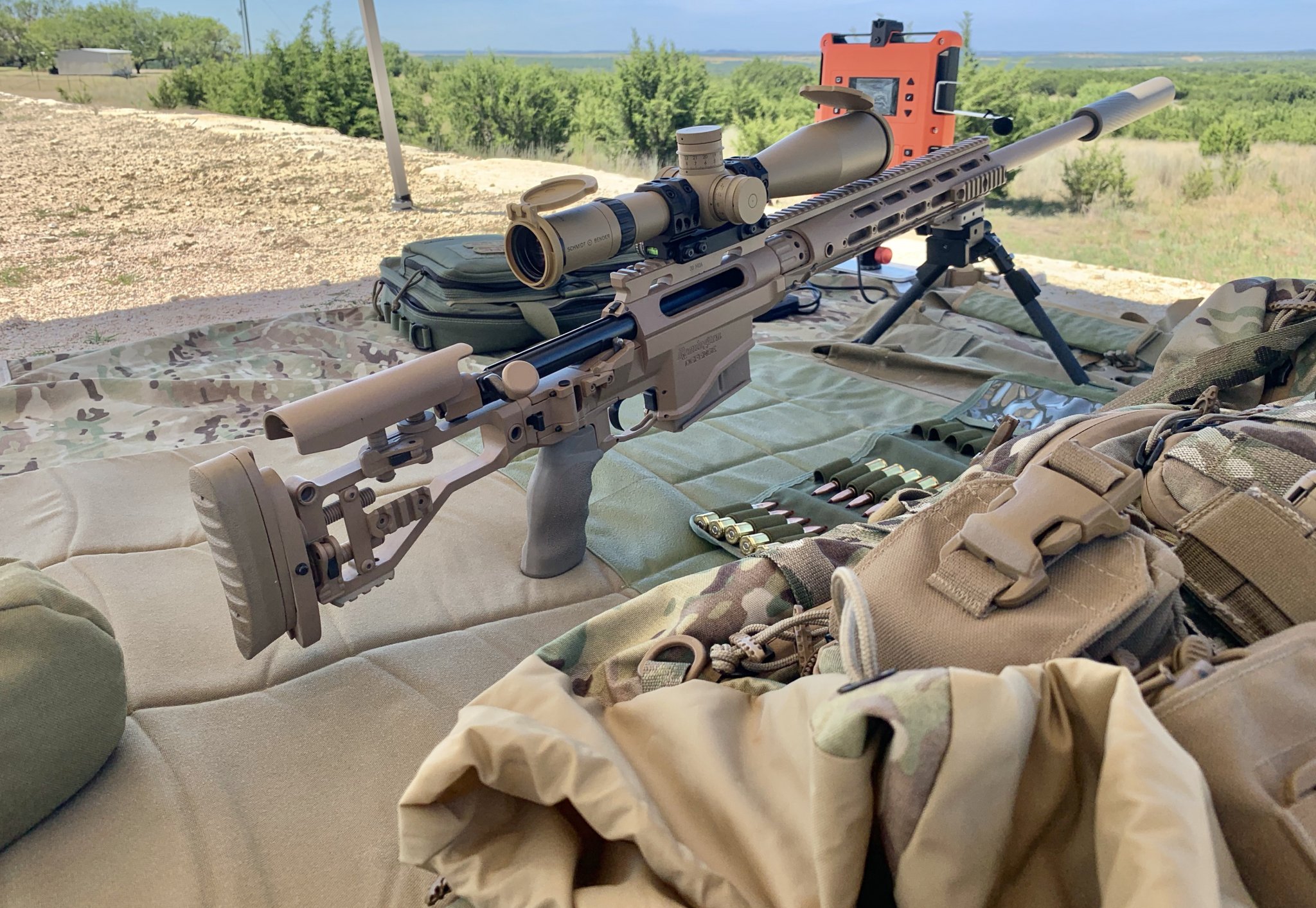

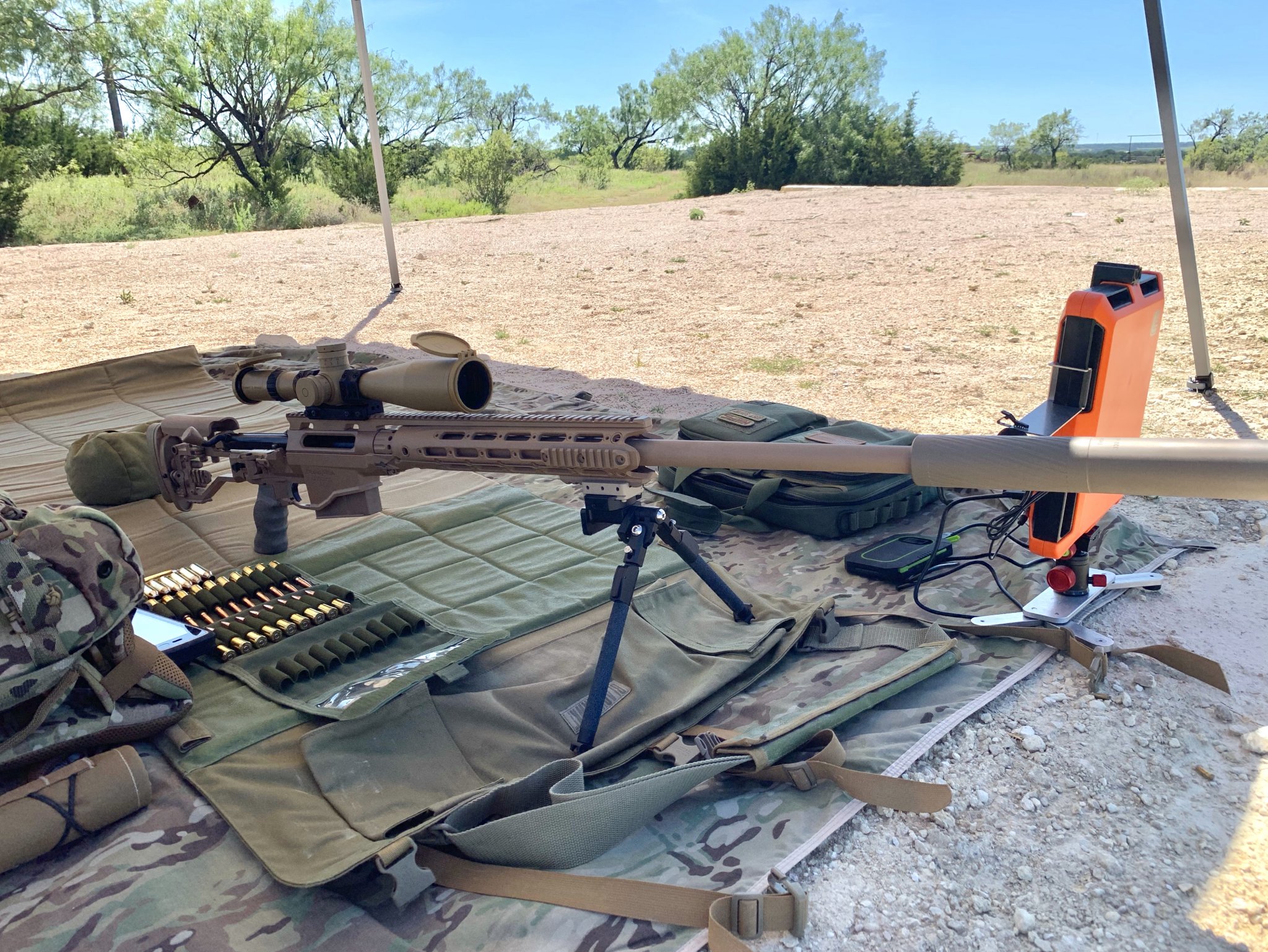

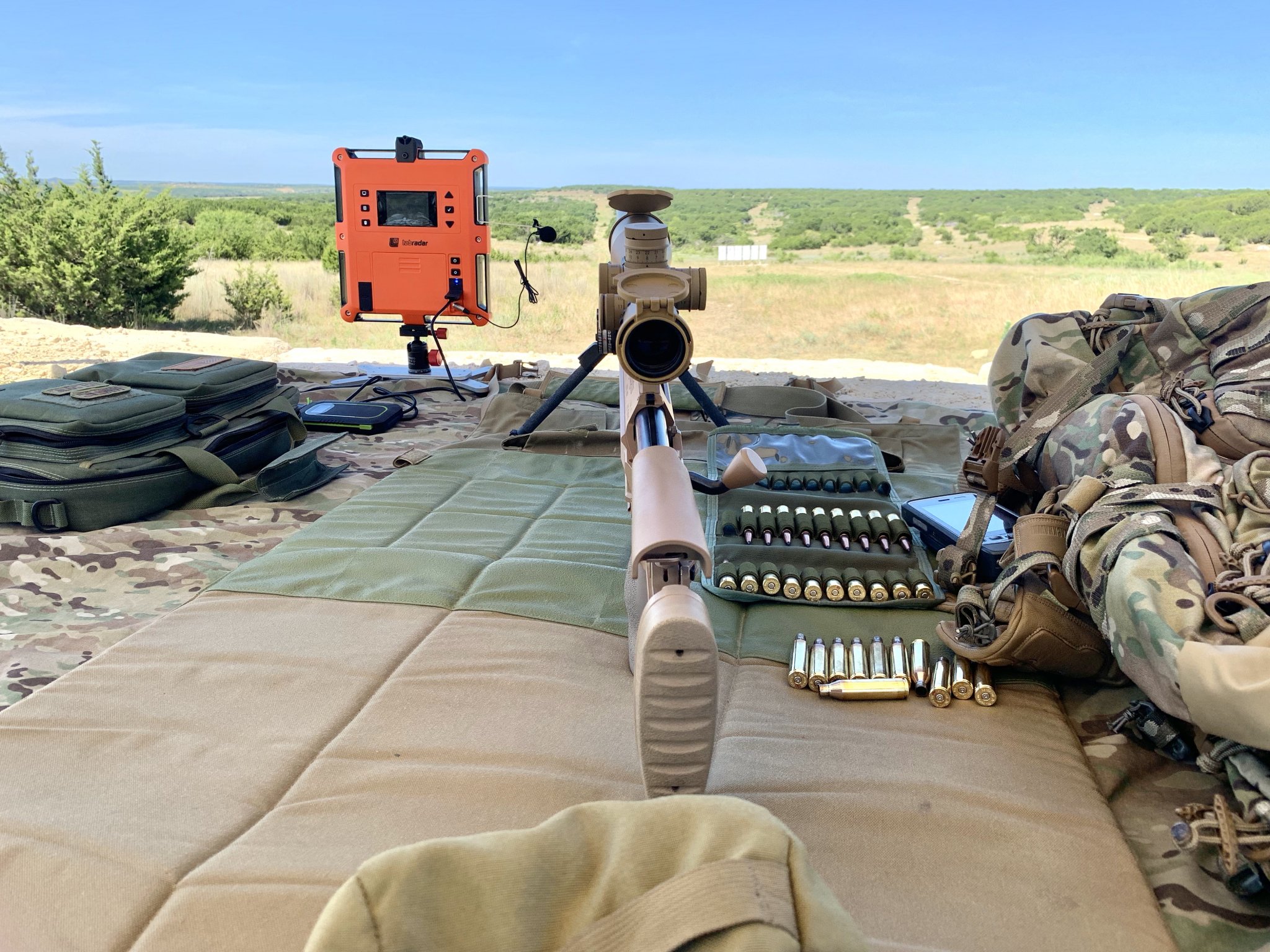

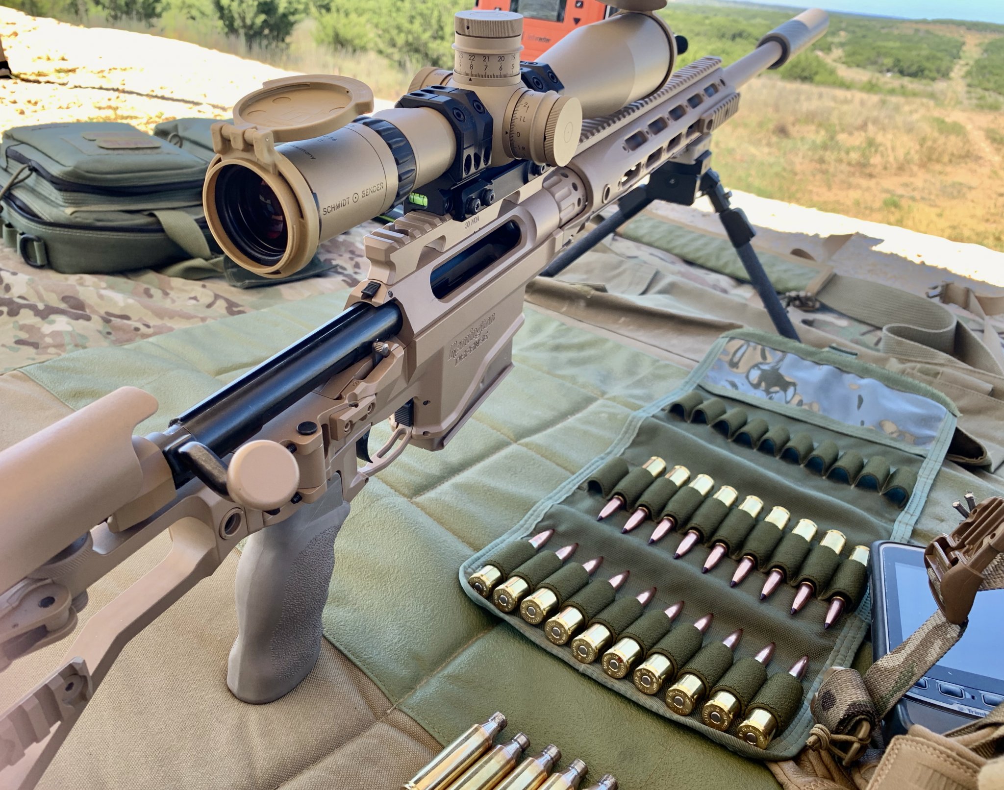

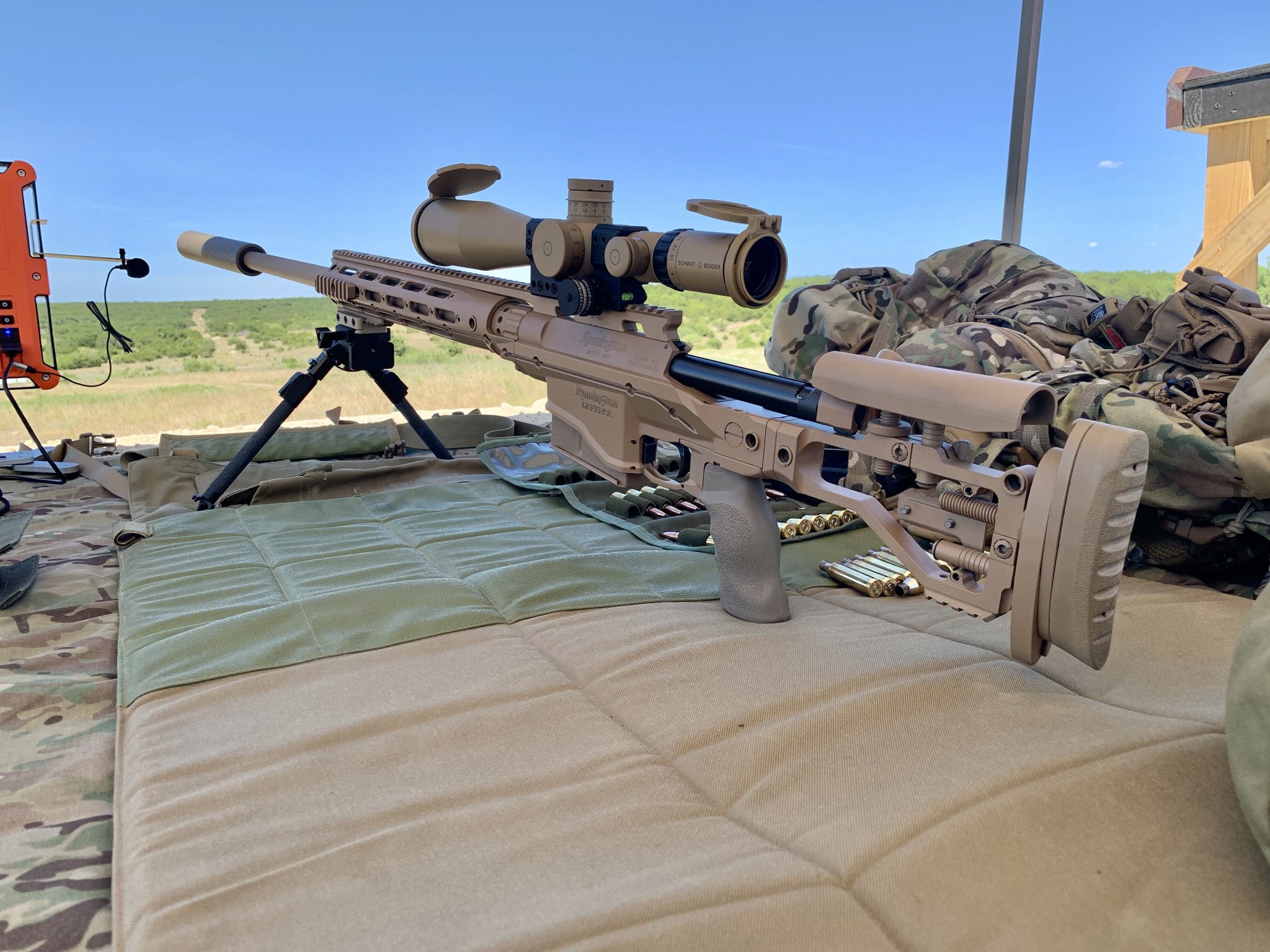

    A few pictures of the finalized rig.
    So after running some numbers and calculations this week in QuickLoad and judging by the case capacity differences between formed and unformed brass, 83.5g to 84g of Retumbo is going to be the ticket for 225g ELD-M's out of this barrel.
    Will test with -0.020, -0.010 and uncle touchy seating depths this weekend. I'm not opposed to jamming +0.020 - like I said before, those were absolute winners while fire-forming... all other variables aside.
    Turns out 84.5g yielded the best results with Retumbo on these 225 ELD-M’s. 3015 fps average, SD of 6. Seated .010” off. .005 and touching yielded very similar results, slight fps increase and slightly pronounced ejector marking. Nothing alarming.
    Very little difference between fired Lapua and fired Peterson (new Peterson is a PITA as noted above - must be fire-formed at a reduced charge/jammed). No appreciable difference between CCI 250’s and Federal 215M’s noticed.
    Extremely repeatable out to 1 mile.

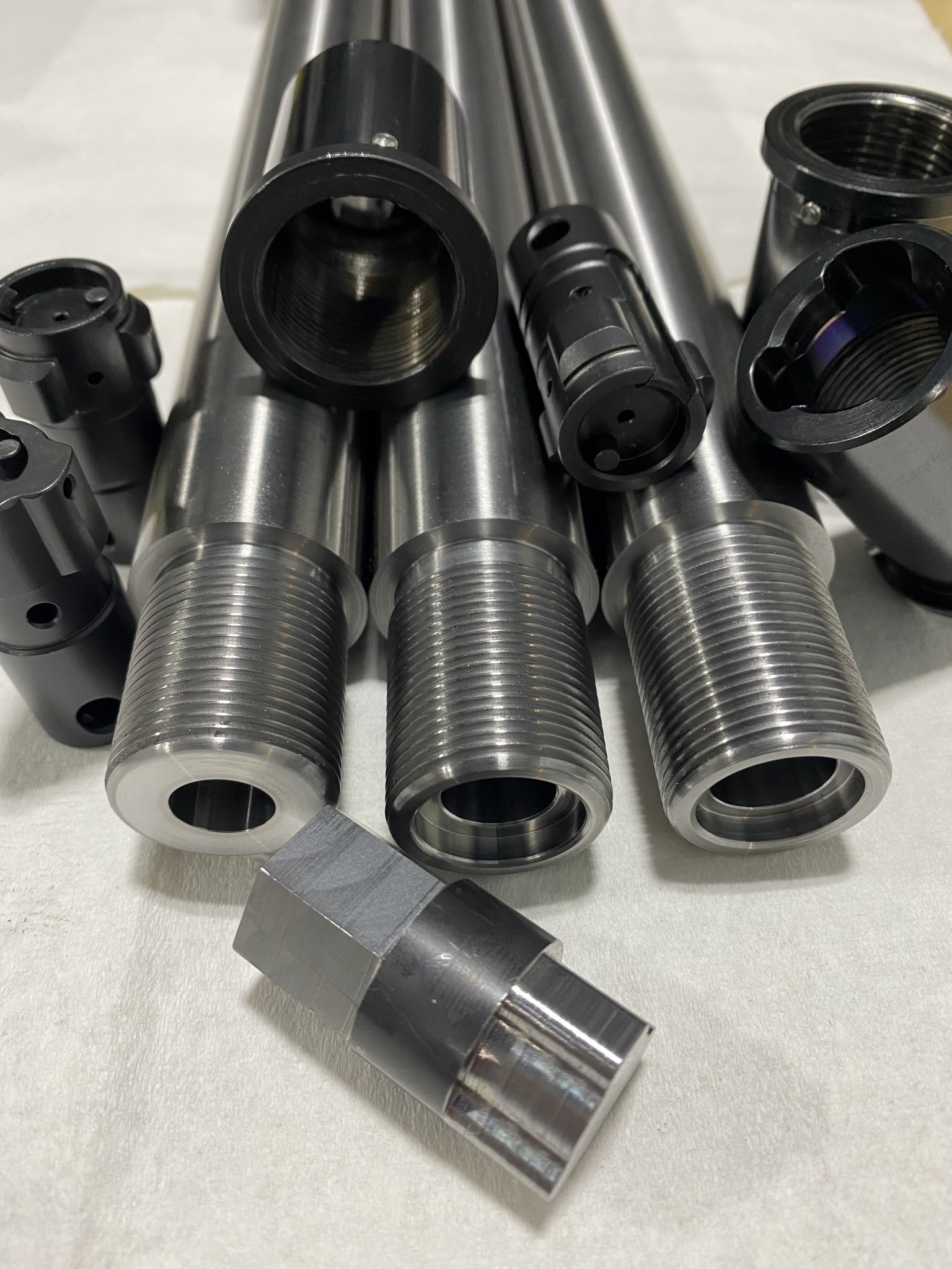

    There are a few threads on the PSR/MSR, but this seems to be the best to post this on… I’m not sure how many of these are floating around out there / who may be looking to upgrade their factory barrels, but Marc from Spartan Rifles just finished swapping them out on my rifle. He also saved the CNC programs (based on my extensions + the 308, mag, and Lapua bolt heads) to make it easy to chamber new barrels going forward.
    Assuming big green held everything to a reasonable tolerance, this means we’re looking at an option for MSR prefit barrels. If anyone has experience with the consistency (tolerances) between these actions, bolt heads, and extensions it’d be good to hear.
    Marc also machined / is sending me a tool to remove and attach the barrel extensions (see picture). Pretty solid knowing that finding extra extensions is like finding a unicorn. He is also considering cloning the extensions, if there is enough interest.
