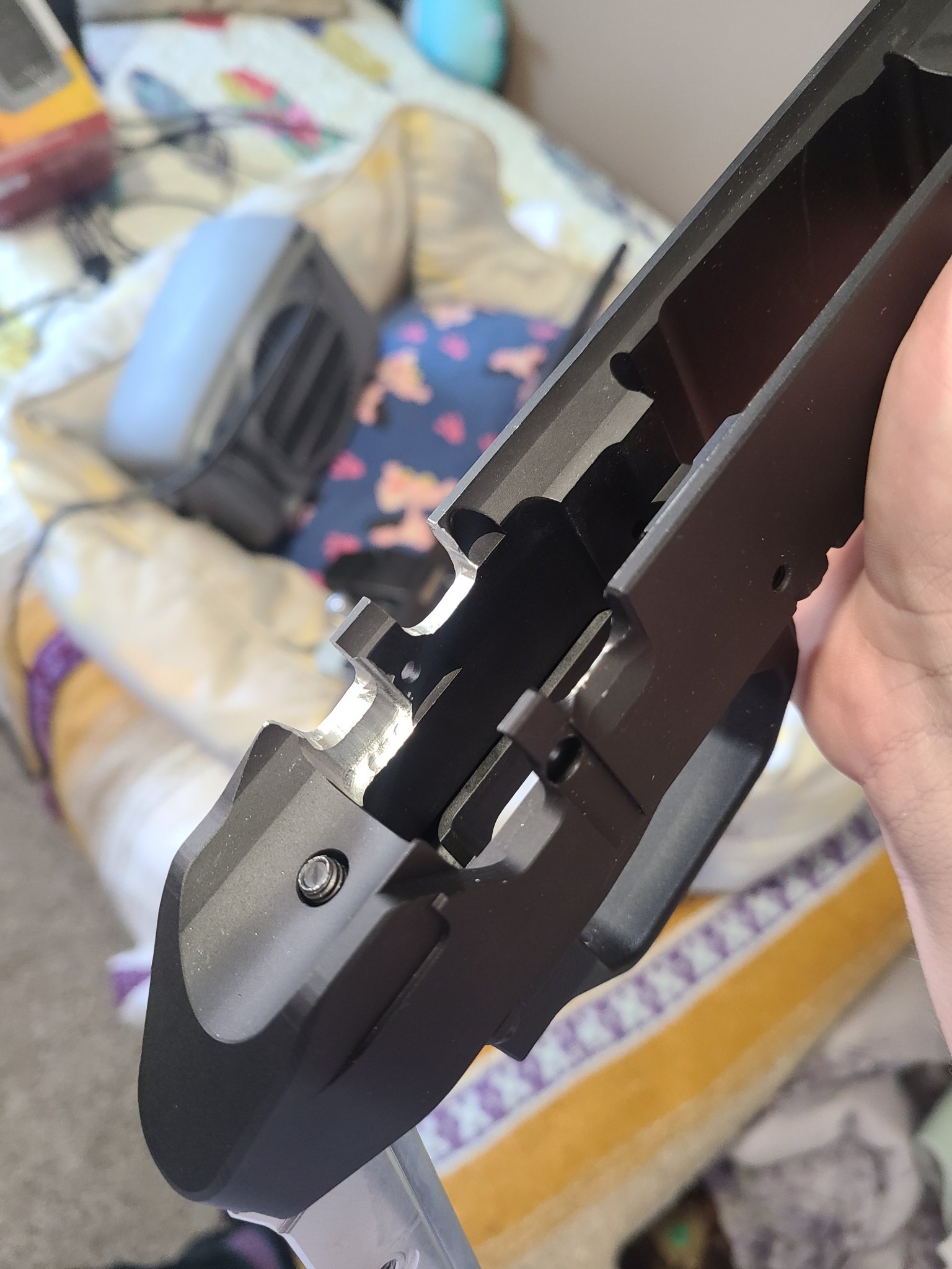

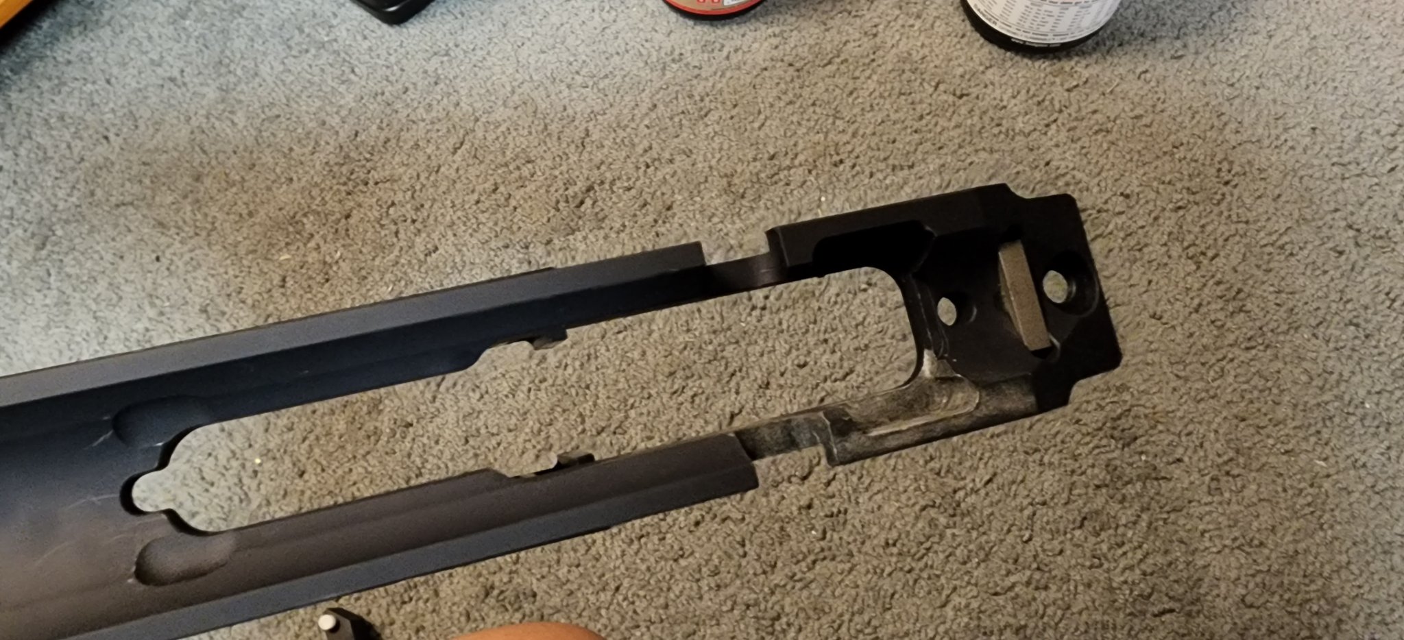

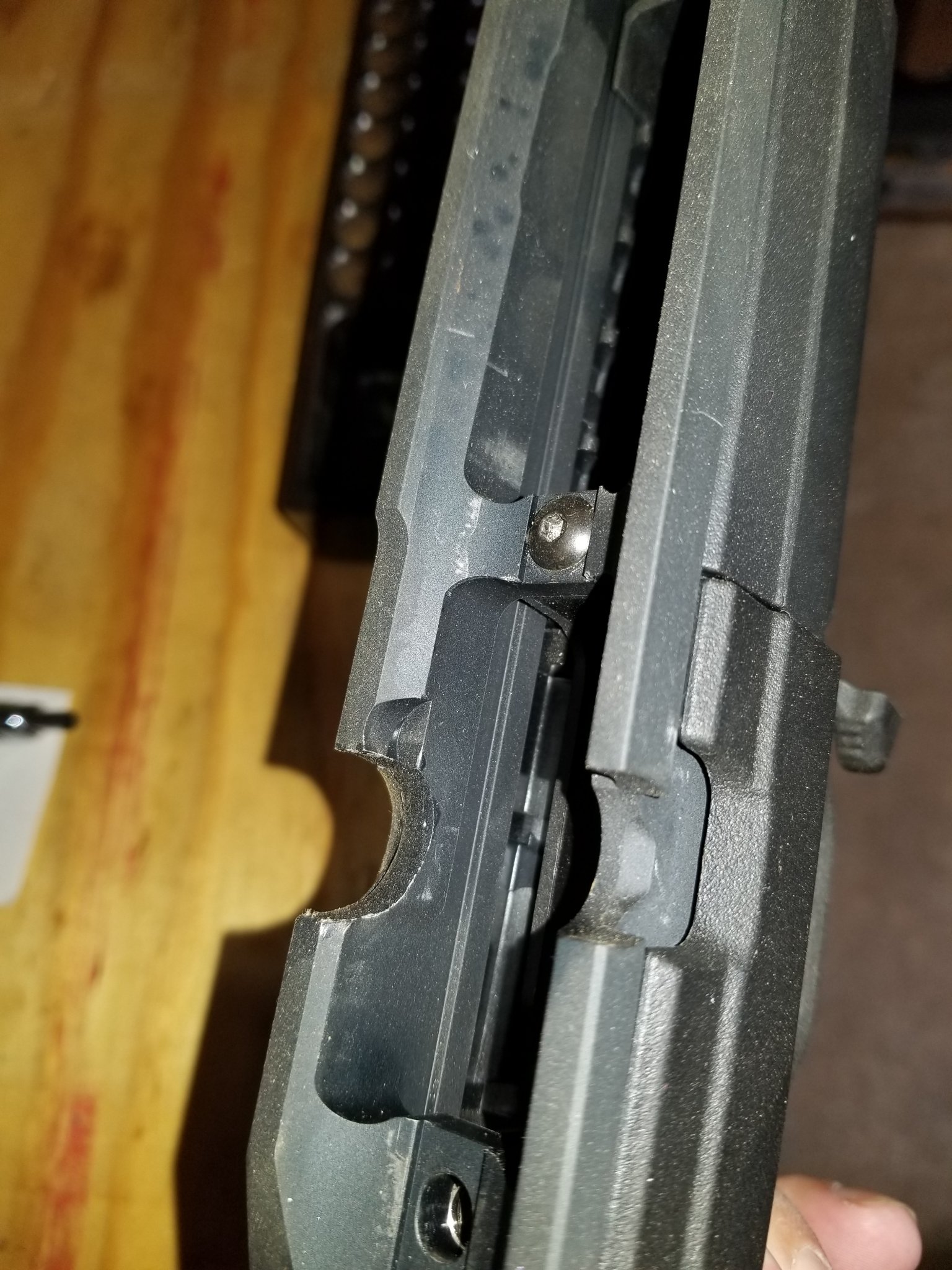

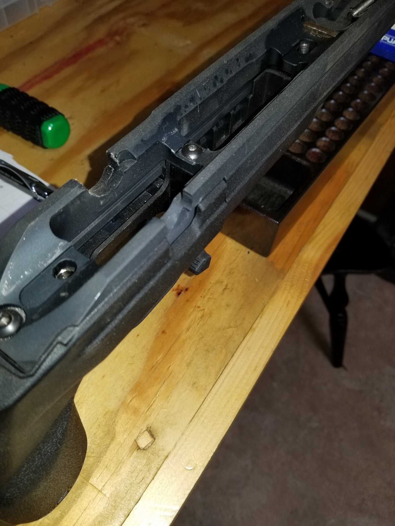

These are the only pics I have of it right now. I'm out of town for a little while, but I can get some more pics when I get back.

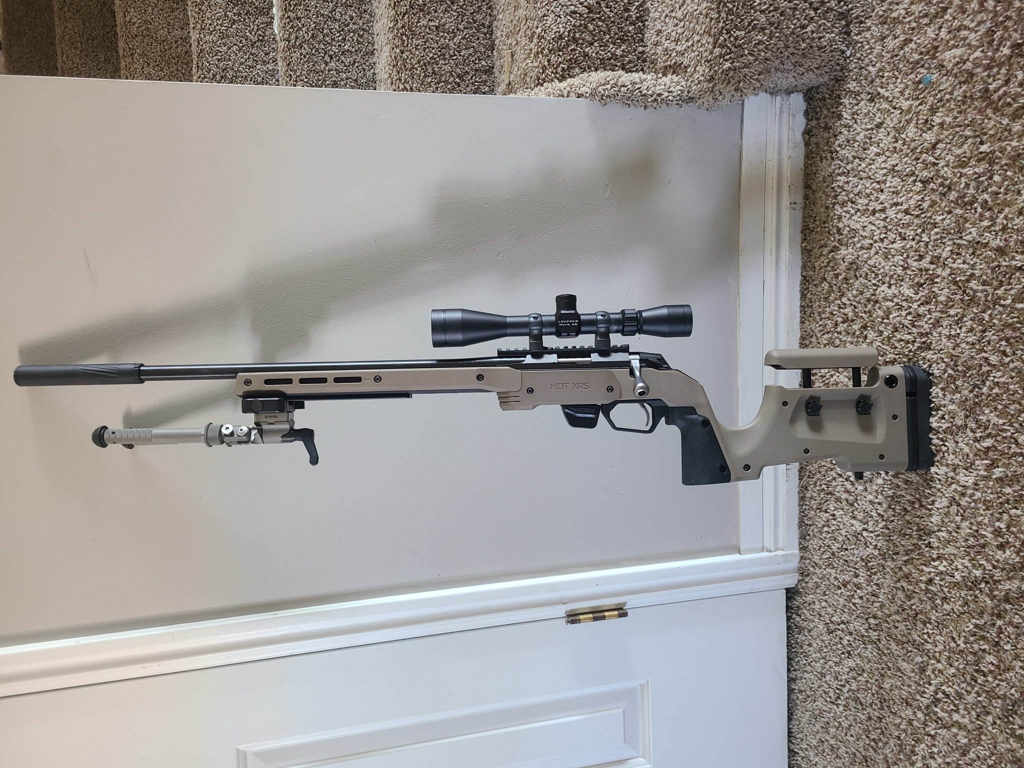

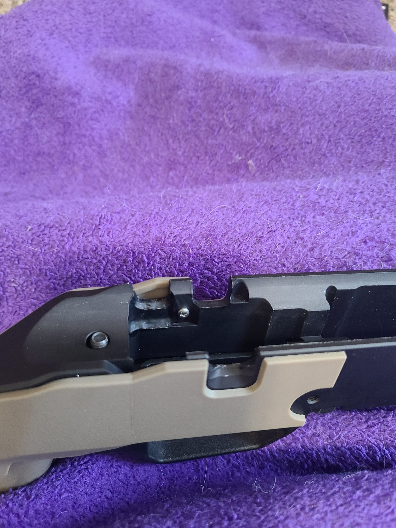

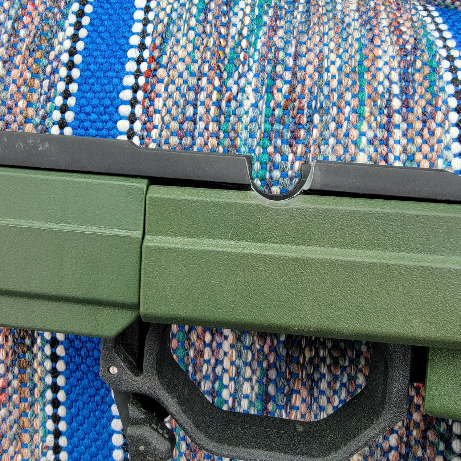

My whiskey is left handed now. Just bolt handle cut.
From when I modified my Mdt Xrs for my t1x. There was more to do on this one. Safety clearancing.
Need updated pics of my t1x. Have an ep5 on it now.
