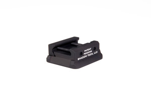

m1match Sergeant Full Member Minuteman Jan 2, 2003 871 612 Western US Apr 14, 2020 #4 Apr 14, 2020 #4 The Hogsaddle guys make a plate that works on Manfrotto RC2 QDs and on Arca clamps Tripods & Ballheads Shadow Tech, LLC, HOG Saddle, Slik, Sunwayfoto, Shooting Tripods and Ball Heads stores.hogsaddle.com For a rifle with a Pic rail on the bottom, this looks like the ticket Picatinny MARC Plate stores.hogsaddle.com
