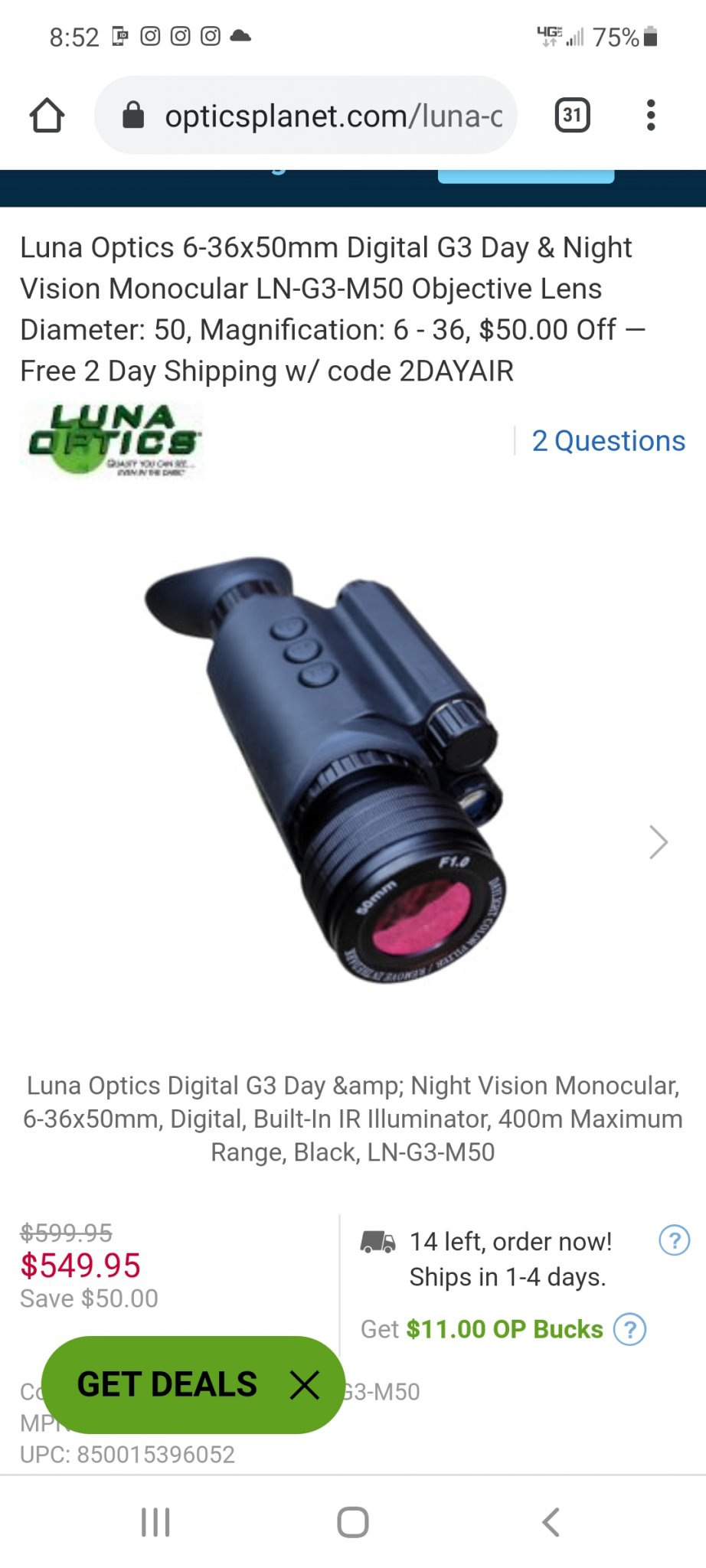

    I am about to buy a cheap NV monocular.
    Does anyone have any suggestions for that 600>700 price range that would work better? Also the data sheet on specs? FOV, mag, generation.
    Uses are just handheld spotting coyotes and raccoons in the field. Looking at stars and scenery. Exploring the night.
    Don't need to video record but couldn't find many that don't.
    Thanks!
