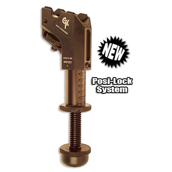

I saw the CTK precision monopod that I could put directly on my stock but see very little written about it here.

Schwazche, we make a sling stud that replaces the fixed loop on your A2, then you can attach our BT01, BT04 or BT05 with or without the Quick Knobs.
I've taken the liberty to attach a link of a young mans shooting success using a bipod and one of our monopods. link
If approached with an open mind, you can have good success replacing a bean bag with a monopod and eliminate the possibility of leaving/forgetting your bean bag.

Schwazche,thanks for giving us a try. Here is a method to experiment with; When shooting, I always keep my off hand on the monopod knob, with the heel of my hand contacting the deck. If I'm trying to shoot for group, I squeeze the knob more or less, making that muscle on the heel of the hand contract(raising) or relax (lowering) which makes the smallest final adjustment in the sight picture. I've seen guys adjust the monopod, then remove their hand from the monopod and put it elsewhere which makes no sense and ruins the desired shooting form. The Accu-Shot monopods were designed to become a "control handle" for the rifle, so hold it to control it!
longrange30, I thank you for giving us a try and I do not question your results. In fact I use to tell people that you could get better groups shooting off sandbags, but the portability and consistency of the bipod/monopod setup was the offset. However, when you get testimonials like the one posted above in the "Link" it becomes hard to make that argument.
