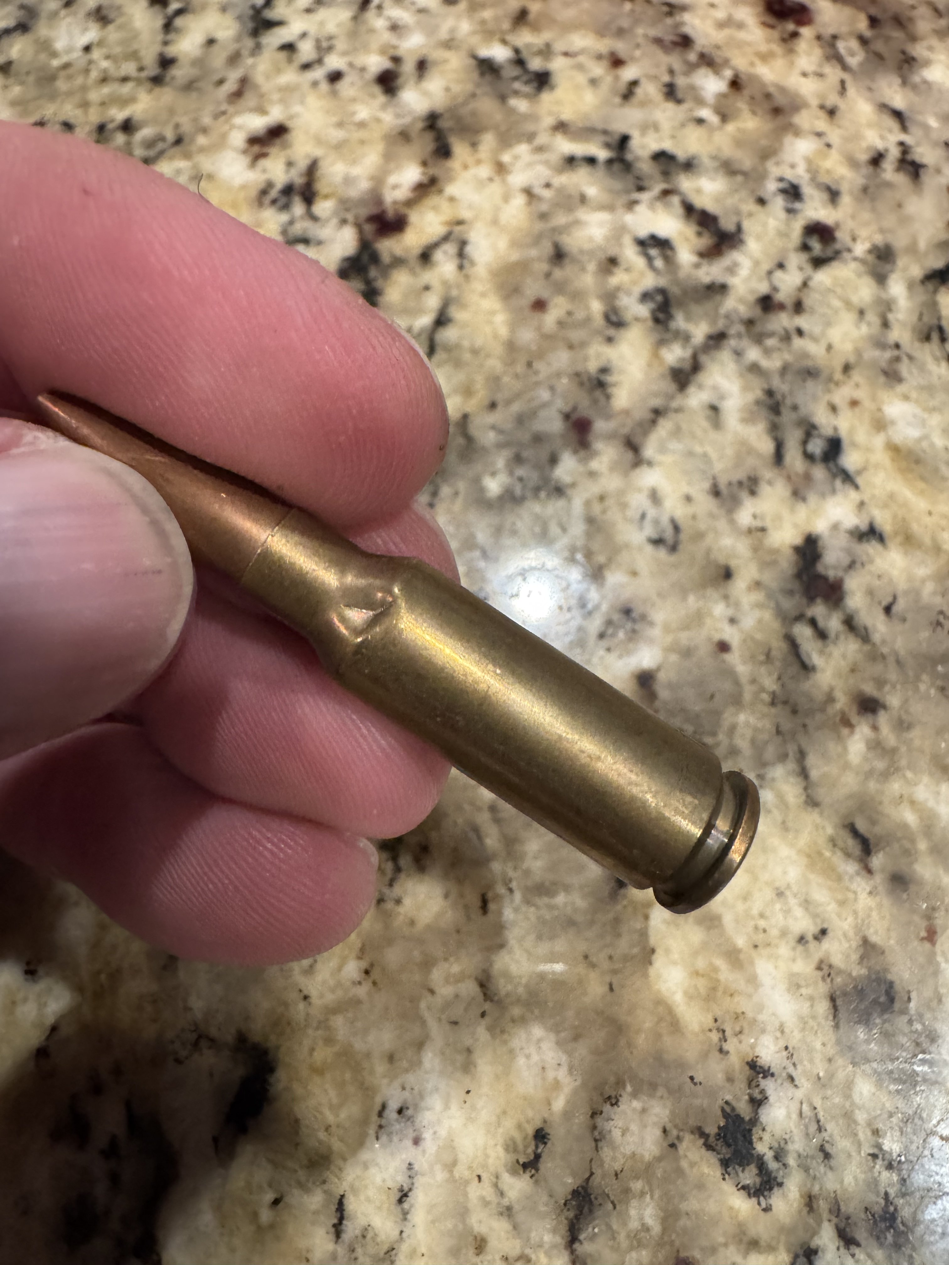

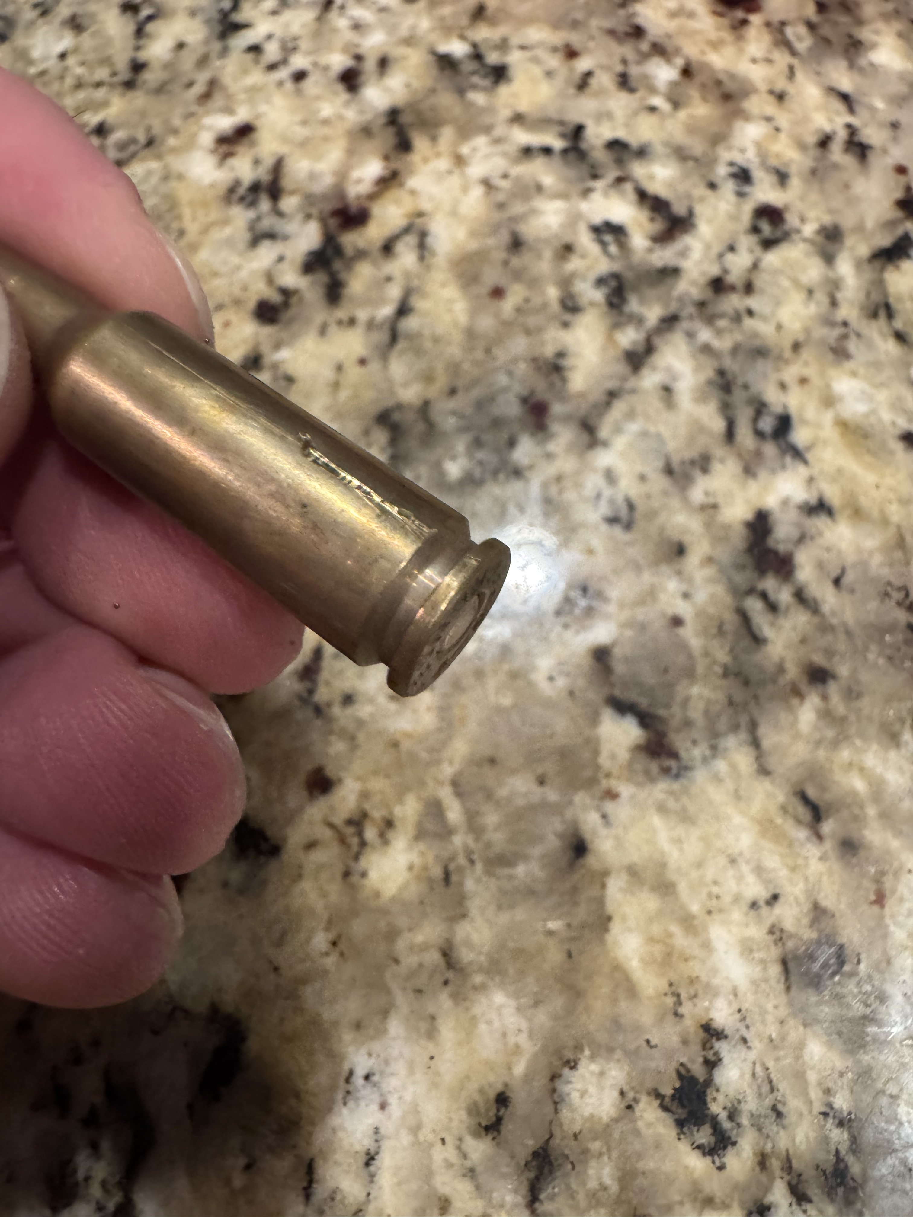

I’m using a Rexus ultrabolt. The rings are removed. Here is a pic of one the cartridges that was jammed forward. Several had the case gouging and dent in the shoulder. I’m really thinking you guys may have hit on too much gas…
I just assumed the gas port would be drilled appropriately, the A5 system would help with additional “room for error” and the Velos LBP 762 shouldn’t have any additional back pressure.

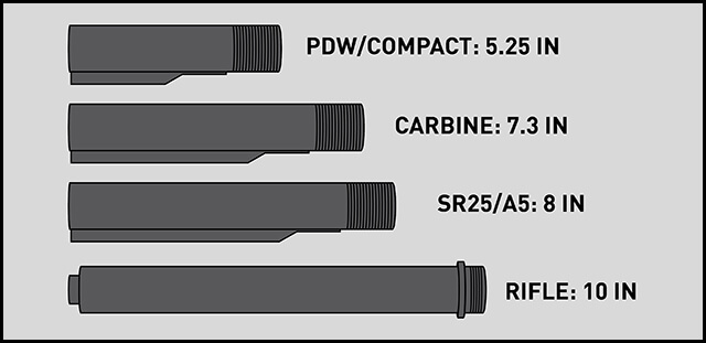

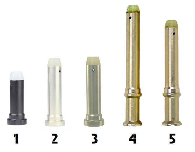

Nope. It's probably the spring rate ramping up as it gets near coil bind.
A carbine buffer in a rifle legth tube wouldn't make the coils bind. A rifle legth tube is longer than a carbine tube. Using a carbine buffer In a rifle tube with no spacer leaves room for the carrier to run into the end of the buffer tube. I.E something like the gas key stops movement instead of the polyutherane on the buffer.

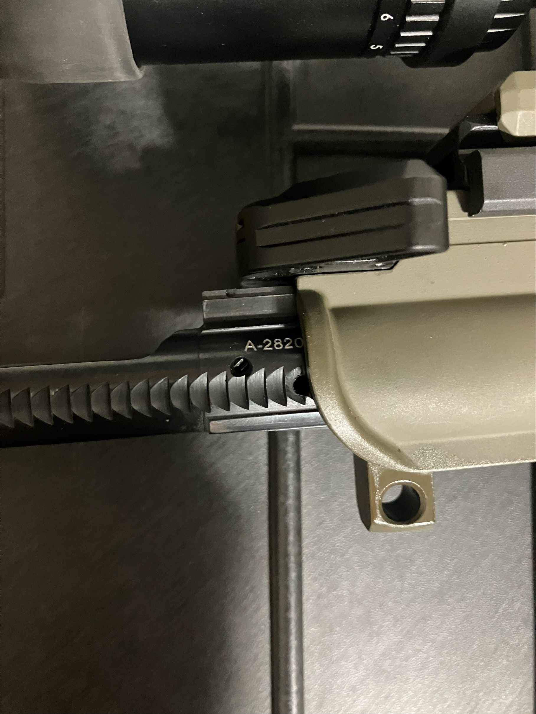

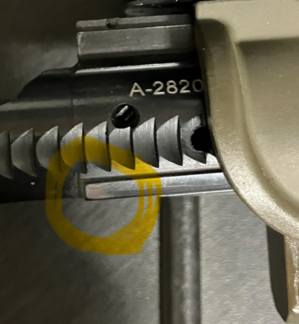

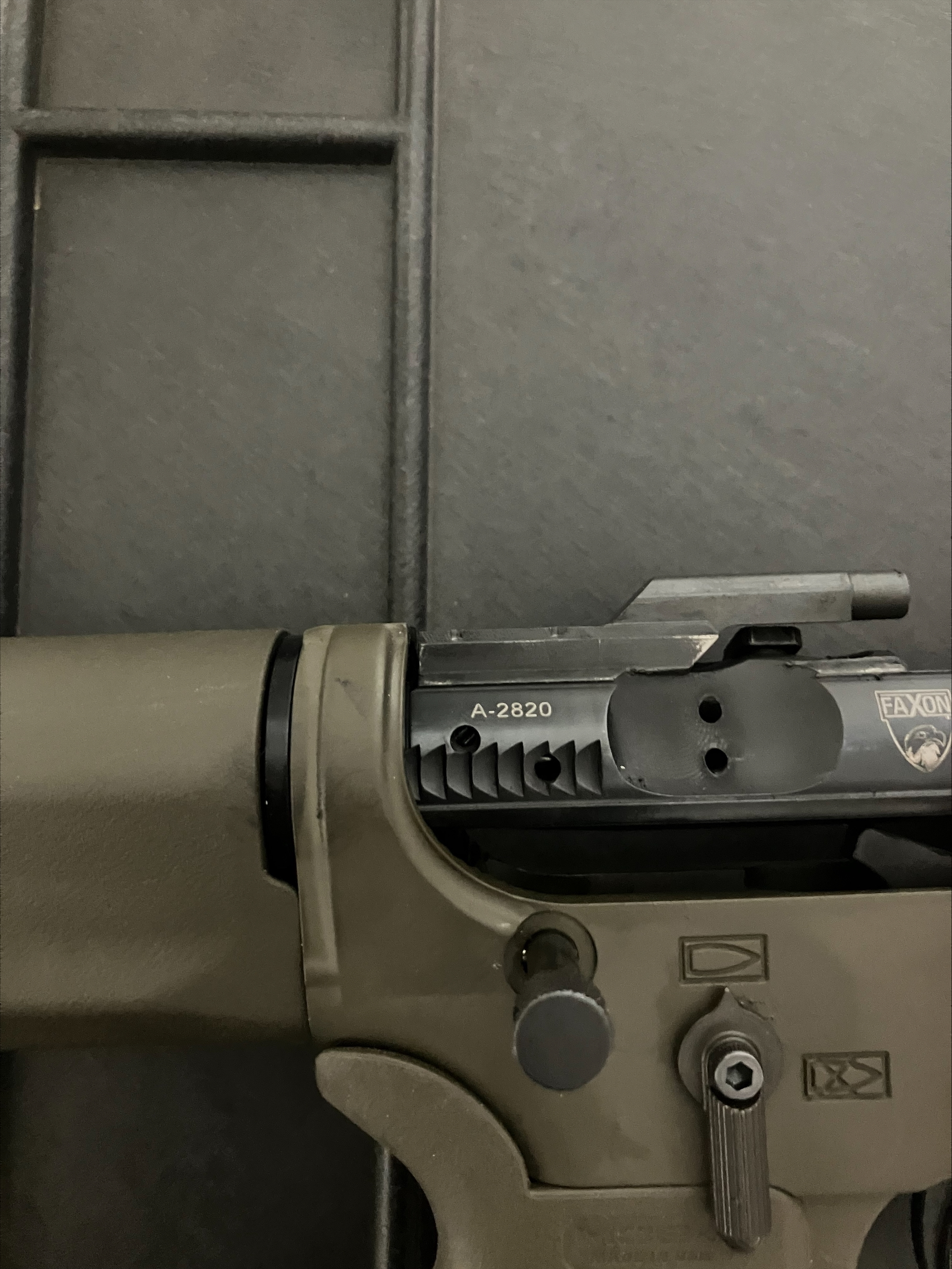

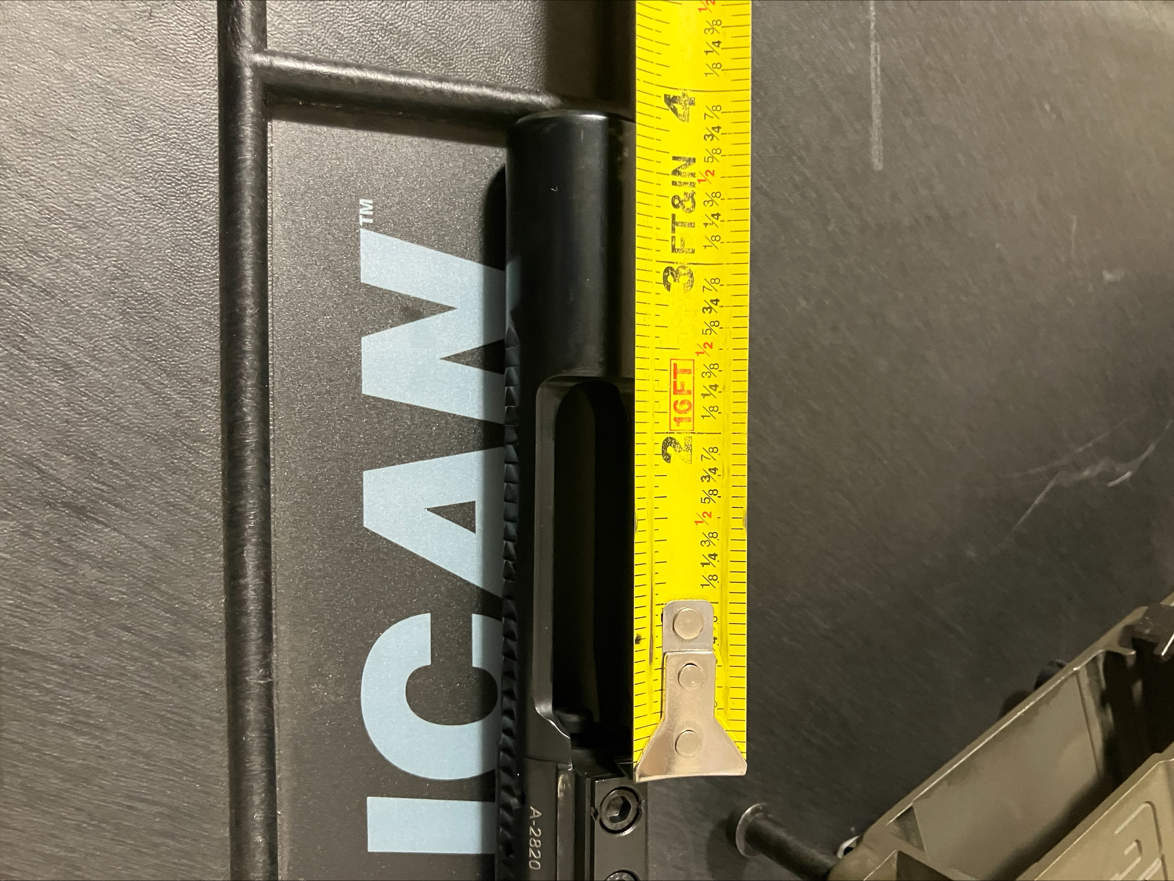

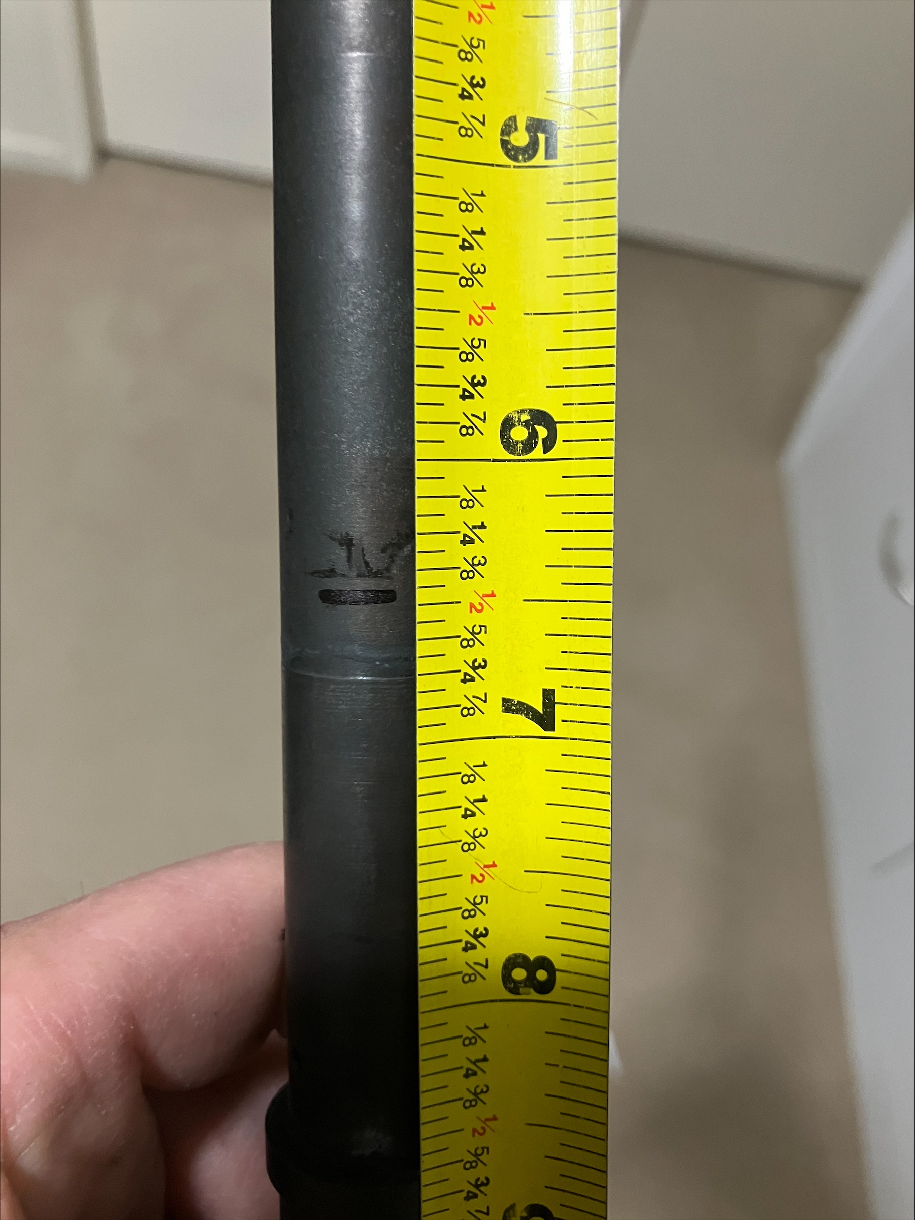

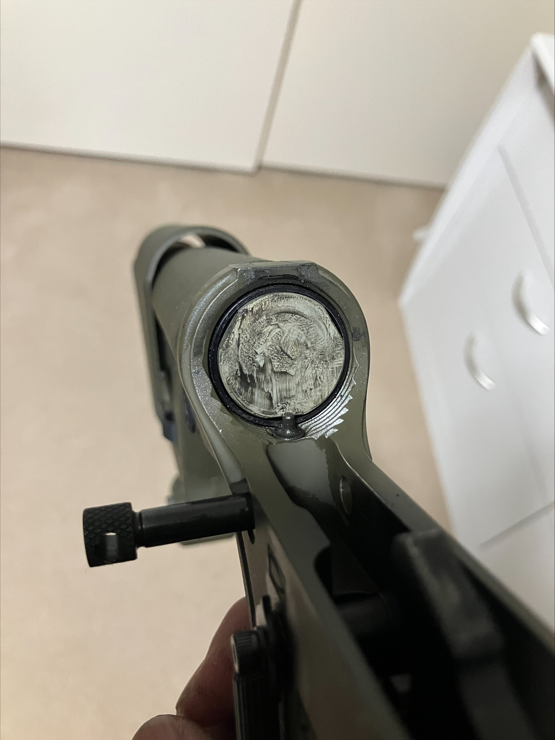

Out of curiosity, I inspected things. Here is what I found. As assembled the carrier travel is limited by the gas key bottoming on the charging handle. Here is where that interference occurs. Apparently the spring rate is coincidentally just right to cycle and lock back on an empty mag without bottoming.
Here is where the back of the gas key would contact the lower receiver,
Here is the total travel of the buffer before bottoming on the polyurethane bumper,
And here is the length of the carrier to the key.
Out of curiosity, I inspected things. Here is what I found. As assembled the carrier travel is limited by the gas key bottoming on the charging handle. Here is where that interference occurs. Apparently the spring rate is coincidentally just right to cycle and lock back on an empty mag without bottoming. View attachment 8776710
Now, look at the base of the receiver extension tower for damage caused by this corner on your bolt carrier. It will exhibit as small triangles on either side of the tower…
