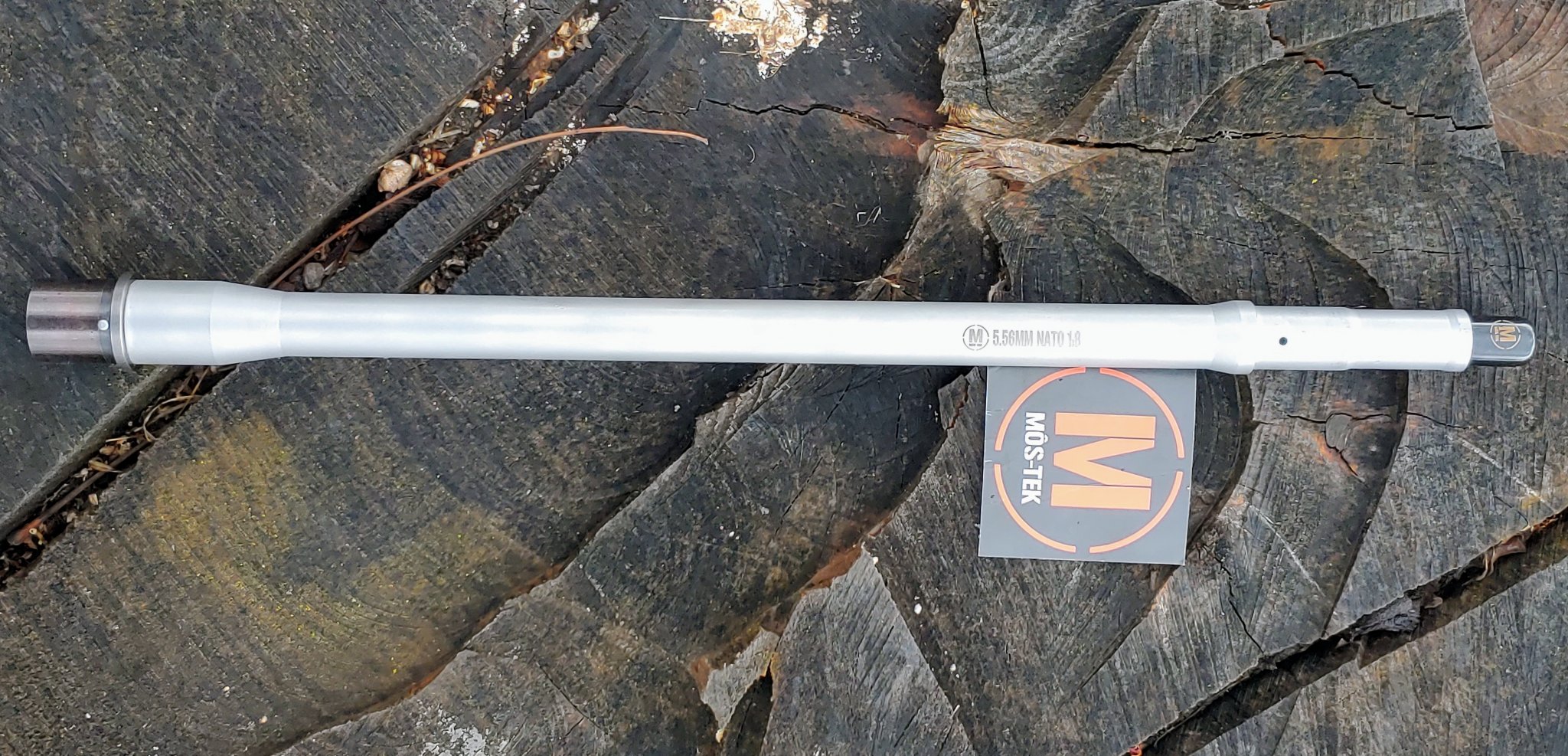

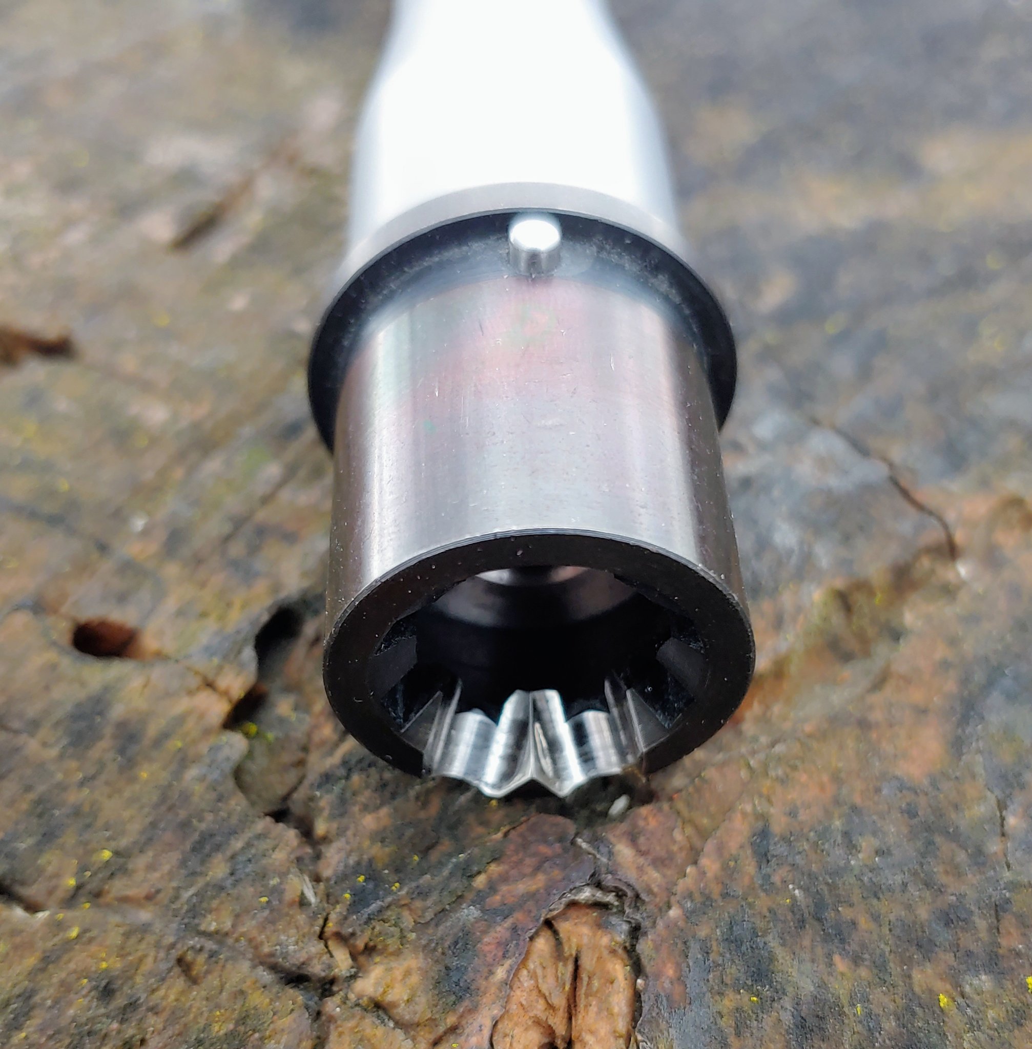

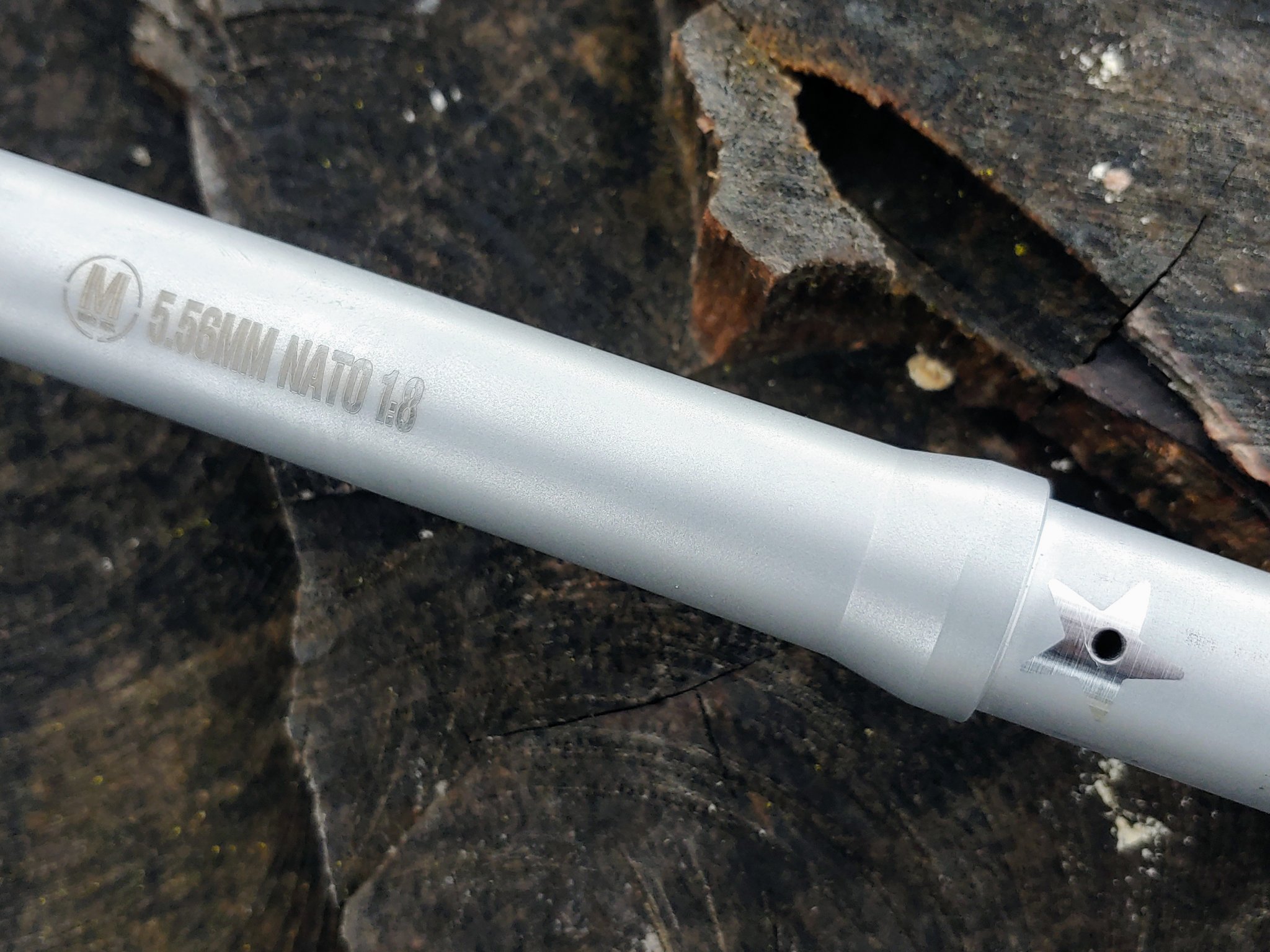

Well it's in. 17" RLGS +1", light contour. Looks great, extension was very snug in a few different uppers I tried it in. Feed ramps were polished out of the box.
GB journal is apparently on the large end of spec, a couple different blocks were too tight without either a press fit or some hand fitting. Forgot to weigh it before install. Pretty excited to see how it shoots but this rifle build is low priority so it'll be awhile.

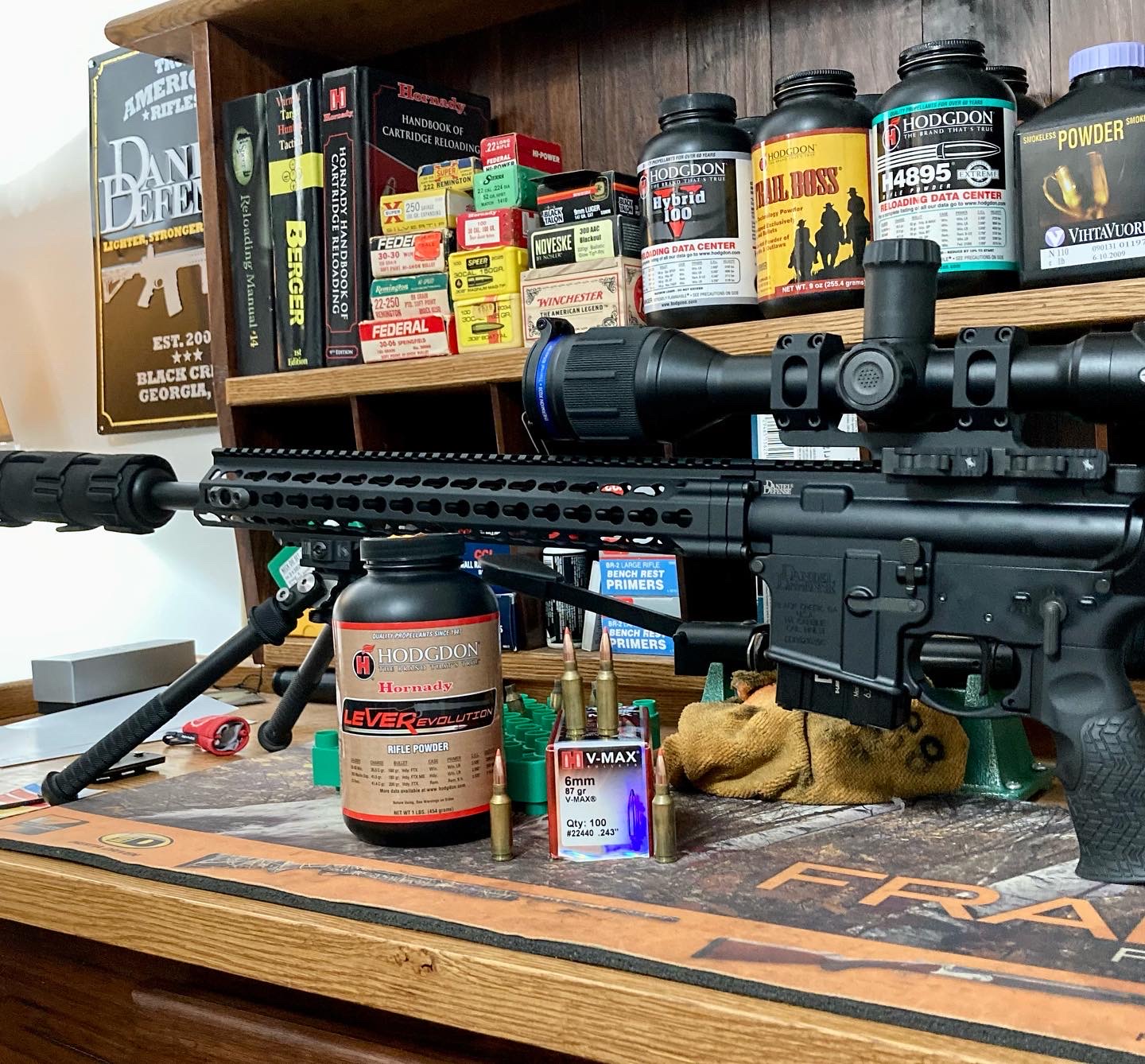

I have a 18” 6mmARC barrel from them. It shoots 87 - 108 grain bullets really well. I am using the 87’s for night time predator hunting. Off a bench it is sub-MOA and from a tripod I can hit 6” steel plates at 500yds. I would recommend them and wouldn’t hesitate to buy from them again!

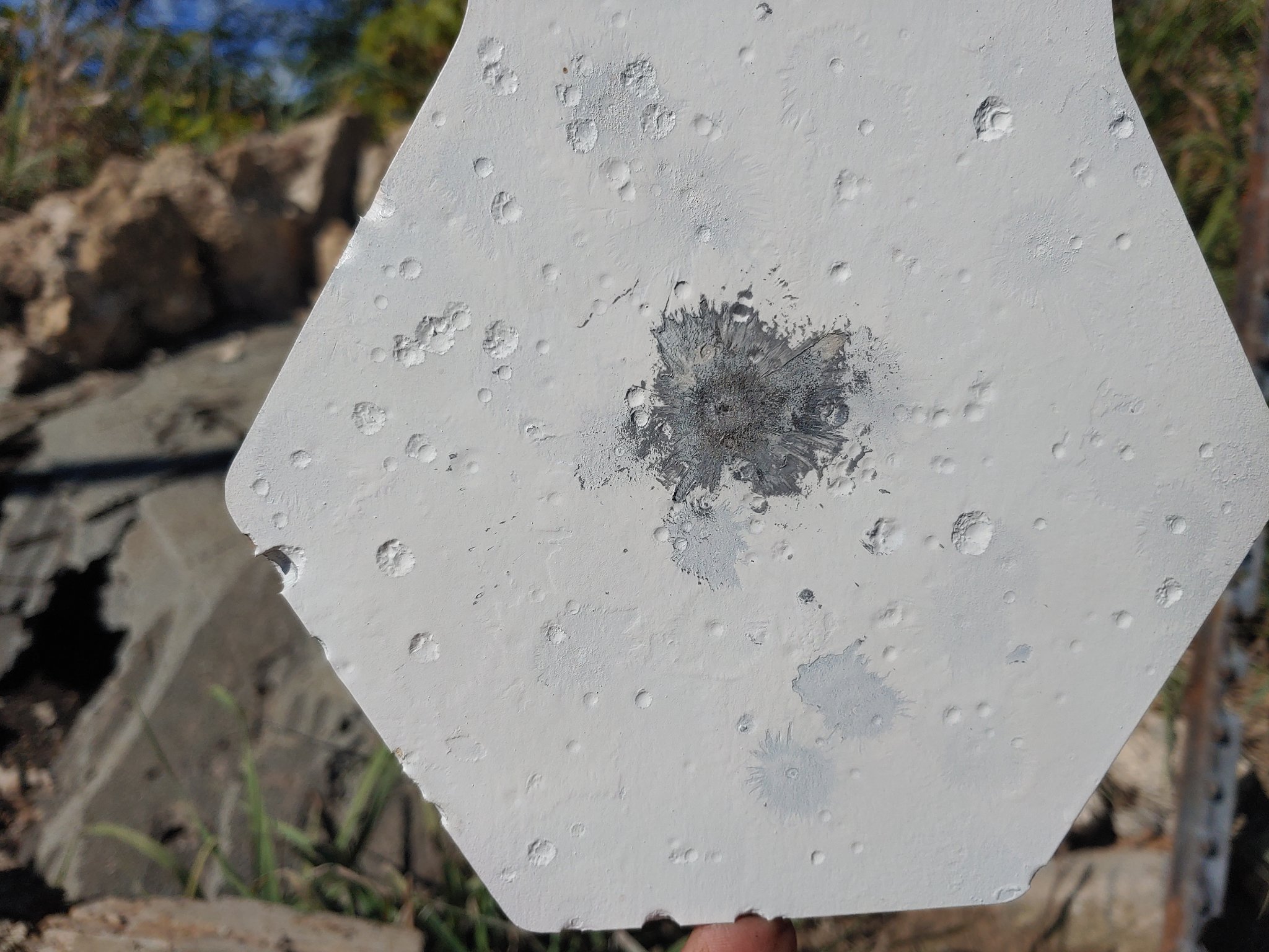

This was with around 60-80 down the barrel. At the time I had a NXS 3-15 on it and was deciding what I would use the rifle for. Turns out, it liked 87gr VLDs and VMAX’s just as good, if not better. The rifle now has a XQ38 Thermion on it, shooting 87gr VMAX’s at 2790fps.
It’s a 18”, SPR/Med Contour, Rifle Length gas with a Superlative Arms gas block.

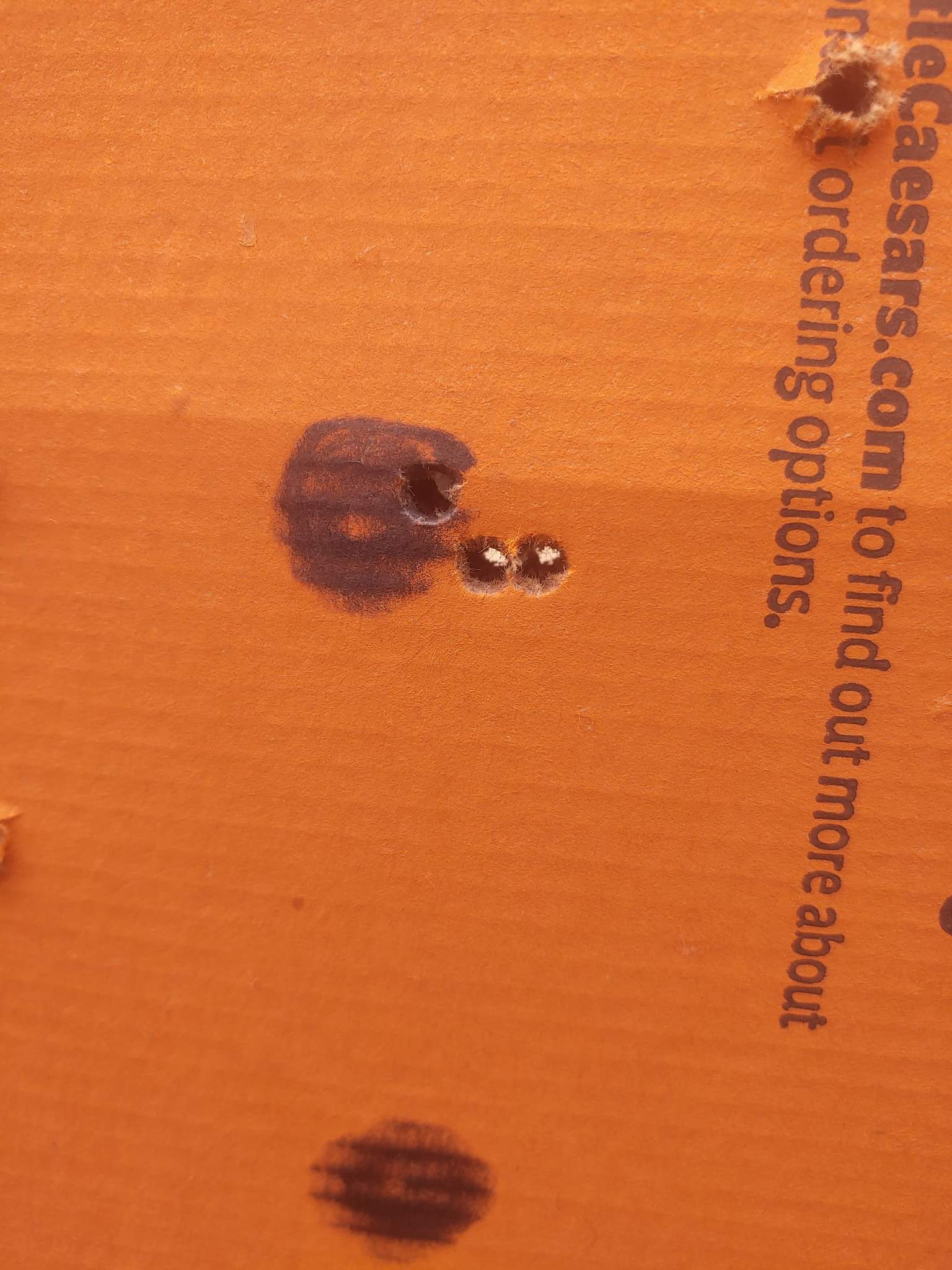

Kinda forgot about this thread. Threw a spare PST 1-6x on the upper and got a rough zero with 55's. Loaded up four rounds of 69 SMK handloads and shot 3 into paper at about 65 yards, guessed holdover and put the last one centered on a 10" plate at 400 yards. I'd say this barrel is off to a good start.

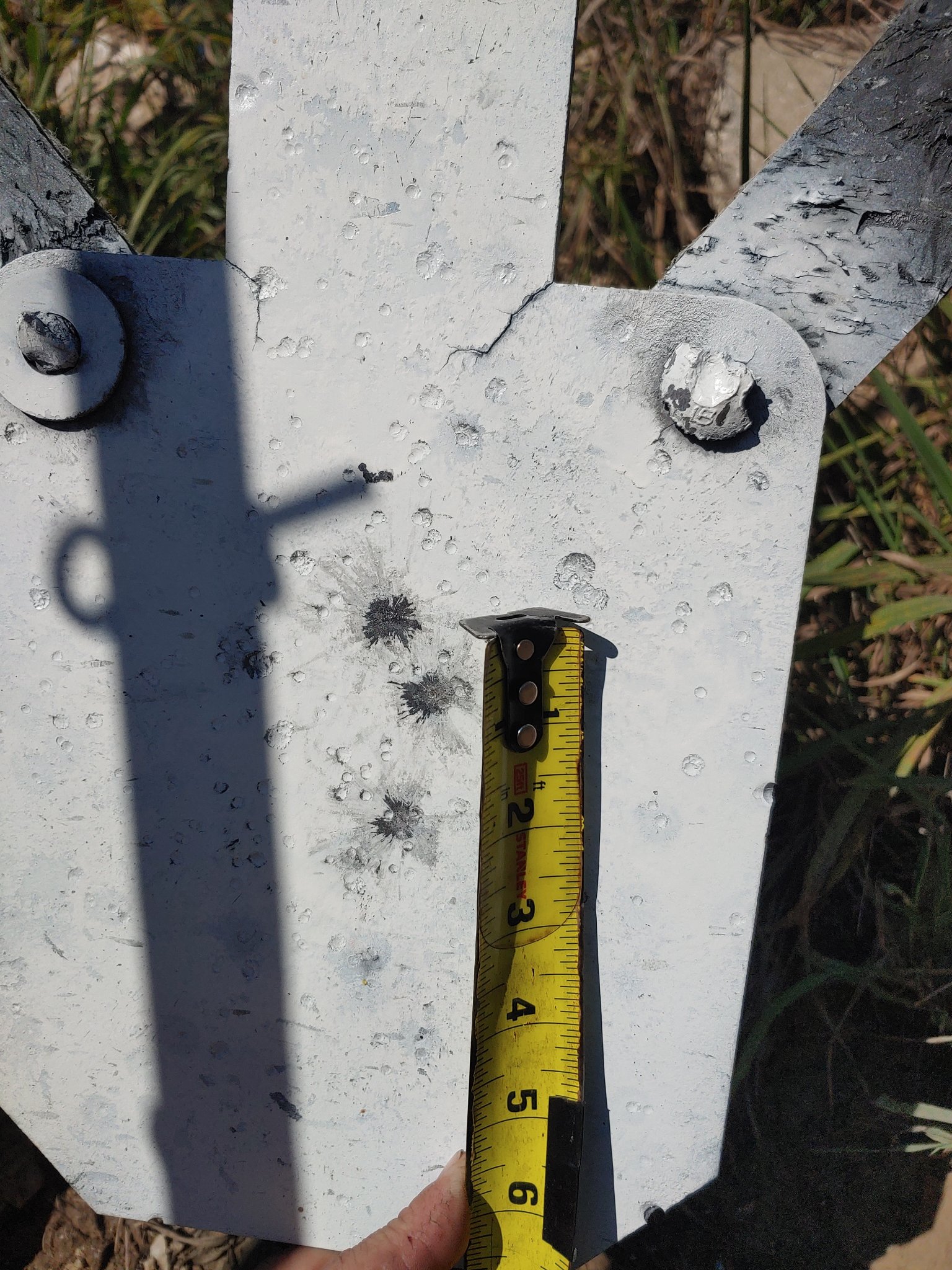

Still haven't done a real accuracy evaluation yet but this is good enough for now.

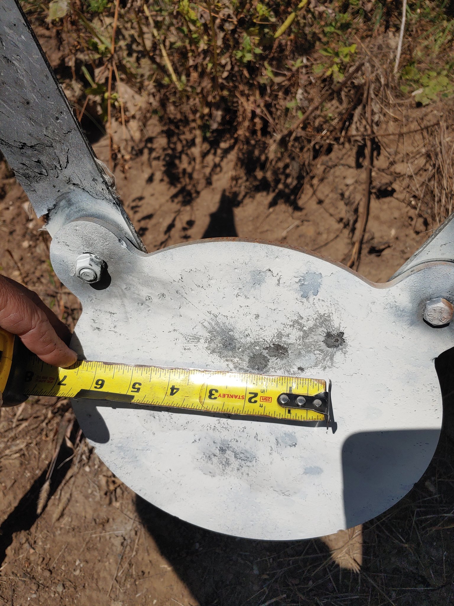

Zeroing at 220 yards yesterday, Magpul bipod and a little rear bag, out of a truck bed, using a 6x scope with a 1.5 MOA center dot. Just my generic 69 SMK load, nothing tuned for this barrel.
4 shot group, 2.5", but the target is actually at about a 30° angle from my shooting position so the actual horizontal spread is sub 2".
3 shot group at 2". Target is a 1/3 silhouette, it's easy to get a repeatable aim point left and right but harder to shoot the same elevation, I pretty much always have vertical stringing on a target this shape.
Best 2 round group of my life. My spotter verified in real time that I stacked them.
Considering my reticle covers over 3" at that distance I'm pretty happy with it.

That said, no one can say those are cherry picked, those are 9 consecutive shots to verify zero, not multiple groups with a picture of the best.
