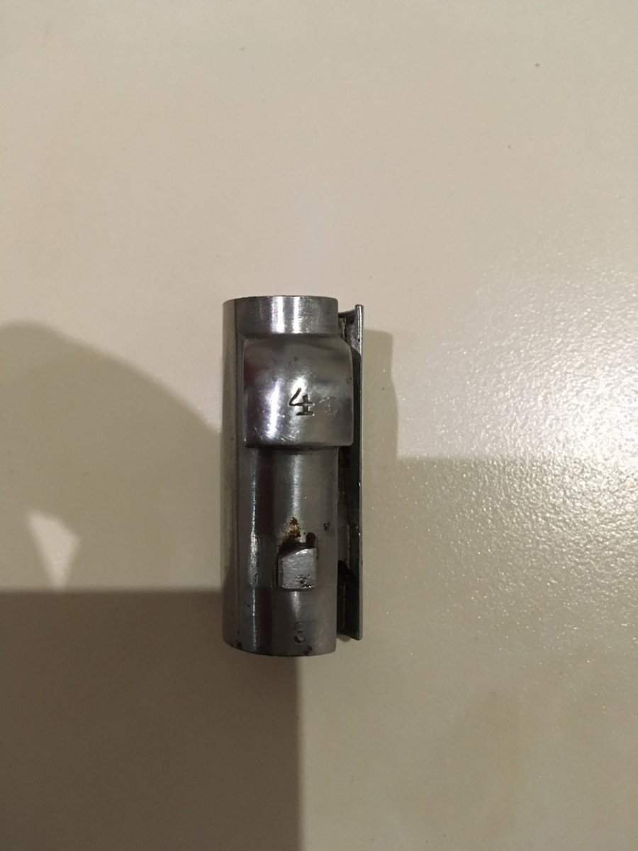

If you think the bolt is excessively worn, there are over sized bolts out there that made for that problem. The bolt image below is numbered, from what I have been told they vary from 2-4 in size. I myself, have yet to find one marked, but I have a half dozen bolt heads or more at home and started checking them and found ones with larger and smaller diameters. This may help with your problem.
Never heard of bolt head diameters numbered by diameter; but that isn't related to the OP's question.
He was referring to "play" when seated in the connector bar, which is irrelevant as the bolthead is detached from that assembly.
I've got a small box full of boltheads (I just wish they had extractors!) that I'll swap out to change/decrease headspace when needed but never seen a reason to check diameters.
My misunderstanding on the connector. As for different bolt head diameters, I also checked mine and I have found that there is a degree of variation in them from being slightly over sized in relation ship to the bolt body to slightly undersized. The image comes from someone who is both on Ebay and Gunboard. He lives in Ukraine and typically sells a lot of tools for various weapons of that era. As I have read some of his other posts, I doubt what he has put out as he access to a lot of things that haven't been translated to English that I don't have. I will say outside of his image, I have never seen a bolt with a marking like that. There may be a warehouse in the former Soviet Union or Eastern Bloc that is full of these, one day they will inundate the mil surp market. Or they sold as scrap and we now use them for shaving razors.

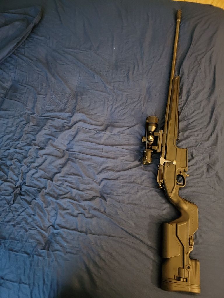

Honestly it runs like a champ and is surprisingly accurate. Well inside any hunting need as far as accuracy.
I just wanted to make sure I wasn’t looking at a potential safety issue.
