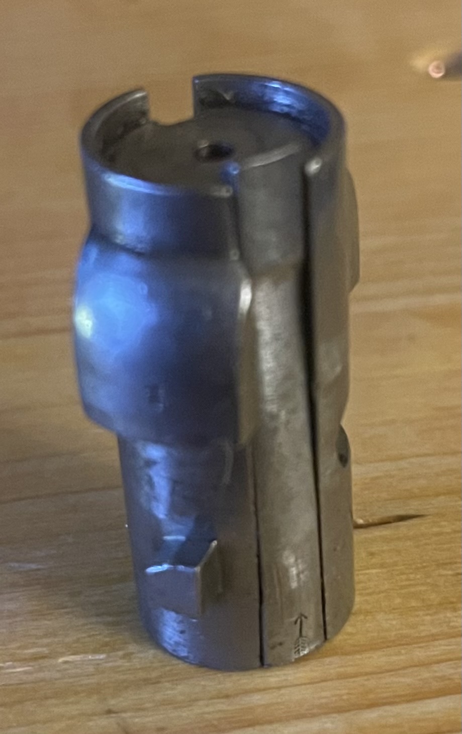

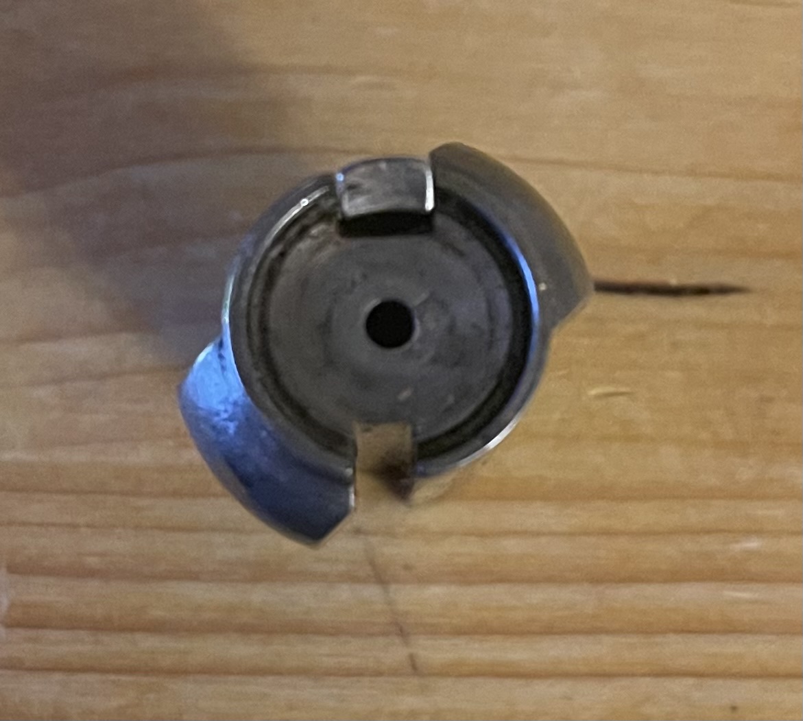

I just bought a 1940 Finnish M91 and it's having some issues when it comes to extracting the spent casings. If I throw 5 bullets in and just rack through them they all eject, but when I shoot them it's hit or miss whether casings get extracted. I will pull the bolt all the way back and the casing is still there in the breech, so I run the cleaning rod through it and the casing comes out with little resistance. The extractor looks a little bent, but I don't have another to compare it to so I don't know for sure. If anyone has any suggestions I'm all ears. Thanks!
If this is happening only on fired cases as the gun heats up, it's probably "sticky bolt syndrome".
What's that status of the rifle- has it ever been thoroughly cleaned?
I've worked on hundreds of MNs, can't tell you how many that have come in are still dripping fucking cosmolene from the action.
If there's cosmolene still there, when the rifle heats up it liquefies and causes the cases to stick.

Extractor looks fine from what I see. However, same potential problem due to cosmo/crap- make sure the extractor flexes freely, push on it with a punch. Sometimes it will literally be stuck to the milled slot in the bolthead.
Did you check headspace?

I tried pretty much everything suggested: I used a 20 gauge brush with mineral spirits. Headspace is good. I went to shoot it and the same shit happened. I replaced the extractor today and now there are no issues. Thanks for all the suggestions!

Glad to hear it. I still don't see anything obviously defective with the extractor in your original pics. They are "bent" (as in, not flat) as you said to angle in so they seat flush against the groove milled in the bolthead. Top lip is angled a bit downwards so that when pressed against the rim when bringing the bolt into battery they're pushed outwards then snap back over the top of the rim. Typically very reliable, perhaps the underside of the lip was worn to where it could get pushed back out in primary extraction. Just curious- were you able to determine exactly what the problem was with the original when you put them side by side?
