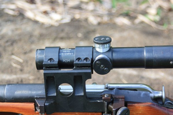

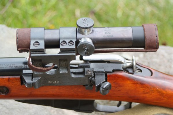

Just for visual reference, the first is a repro scope, the second is original. Note the flat screw heads on the repro and the round ones on the original.

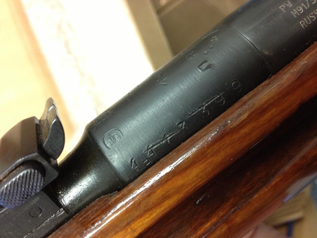

Here's an example of an Izzy ex-sniper's barrel shank.
What Devious said, except the scope number is on the left side of the barrel shank, as shown by aur0ra145. It's also possible for an "ex-sniper" to have had the scope number removed, stamped over, or lined out and then another number added (I think I've seen Izhevsk snipers with remnants of as many as three different scope numbers). However, most of the rifles from Samco are usually referred to as "scopeless", instead of "Ex" snipers. This is kind of a technicality conjured up by collectors to differentiate between two different scenarios. A "Scopeless" sniper would still have the original holes open, whereas what is usually referred to as an "ex-sniper" would have had the holes welded over with the ends of the screws/pins still in place. The Soviets returned many sniper rifles to "standard" rifle status by doing this and replacing their bent bolts with straight ones. The Samco "scopeless" rifles were obtained from Yugoslavia, where they didn't weld over them. Now, if you're not confused already, I'll go on to tell you that Samco has also had some "ex-snipers" with welded holes. So, not all of the snipers from them are the Yugo scopeless rifles.
