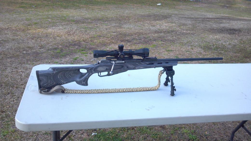

Hey guys,
I'm starting on a project with one of my 91/30s. I've decided to go with the boyds thumbhole featherweight stock.
I think I'm going to go with the RSI mount and pillars.
I plan on bedding with devcon
Anyway, my main questions is for input from all of you on barrel length. From what I've seen, the stock barrel at it's full length has some harmonic and flexibility issues. The "magic numbers" i'm hearing are 22" or 24".
Thoughts?
Any other suggestions on my project are welcome too!

I don't have the highest of expectations for what this rifle will do. The main reason why I'm trying to optimize this rifle is that I have a fairly massive surplus of bulgarian light ball. I just want a decent stick to shoot some of it. Primarily it would be for training/hunting.
those are some nice looking mosins. I'll post some pictures up when I can get mine together.
My machinest called me and said that he squared the scope mount holes up with the elongated lower tangs of the receiver in the vice, but that once installed the mount looks slightly off center..... I went over to look at it, and sure enough it looked off. I saw the way he measured for the holes to be drilled and it looks like how i would have done it outside of using a clamp to square the mount with the flat bottom of the receiver. He said he would take care of it...
The barrel has been cut and recrowned.
If we can work out the scope mount issue, and I get the bolt back... It will be ready to go.....

OK. So, opinions....
The tang my machinist buddy used to align the scope mount holes is not matched to the centerline of the receiver. It is slightly off. So, since he used this as his reference the holes are off. So, he mentioned modifying the scope mount to slide it over.
Any opinions on the best way to fix this? I would much rather fix the hole locations on the receiver so that it's done right.

That became painfully obvious when he told me it was crooked...
I've found that the only true surface for reference is the flat bottom of the receiver.
My plan was to get the rifle back, take some matching screws and anneal them, install them with red loctite, peen the head, grind, file, sand and re drill with a reference to the bottom flat..
When I dropped by to pick it up I found that he had fixed it. Though not in as simple of a way as I had planned to go. He devoted himself and an employee for most of the day to fixing this thing. I think his pride was sorely hurt.
Anyway, they ended up lathing a spacer and adjusting the holes in the mount enough to center it using the bottom flat. he found that the mount (I ended up getting the ATI because rock solid was out and I was impatient) wouldn't sit flush with the receiver even with everything in the right place. So, he actually milled a slot/channel mating between the mount and receiver.
It's not exactly what I would have expected, but it's flush and will not move off center at all even without the screws in place. I'm satisfied.

I've checked everything over, and the holes are all in line with the correct placement of the mount. holes are drilled rearward of the chamber into the spot indicated in the ati instructions. The flat spot of the mount opening is aligned flush with the opening in the receiver.
