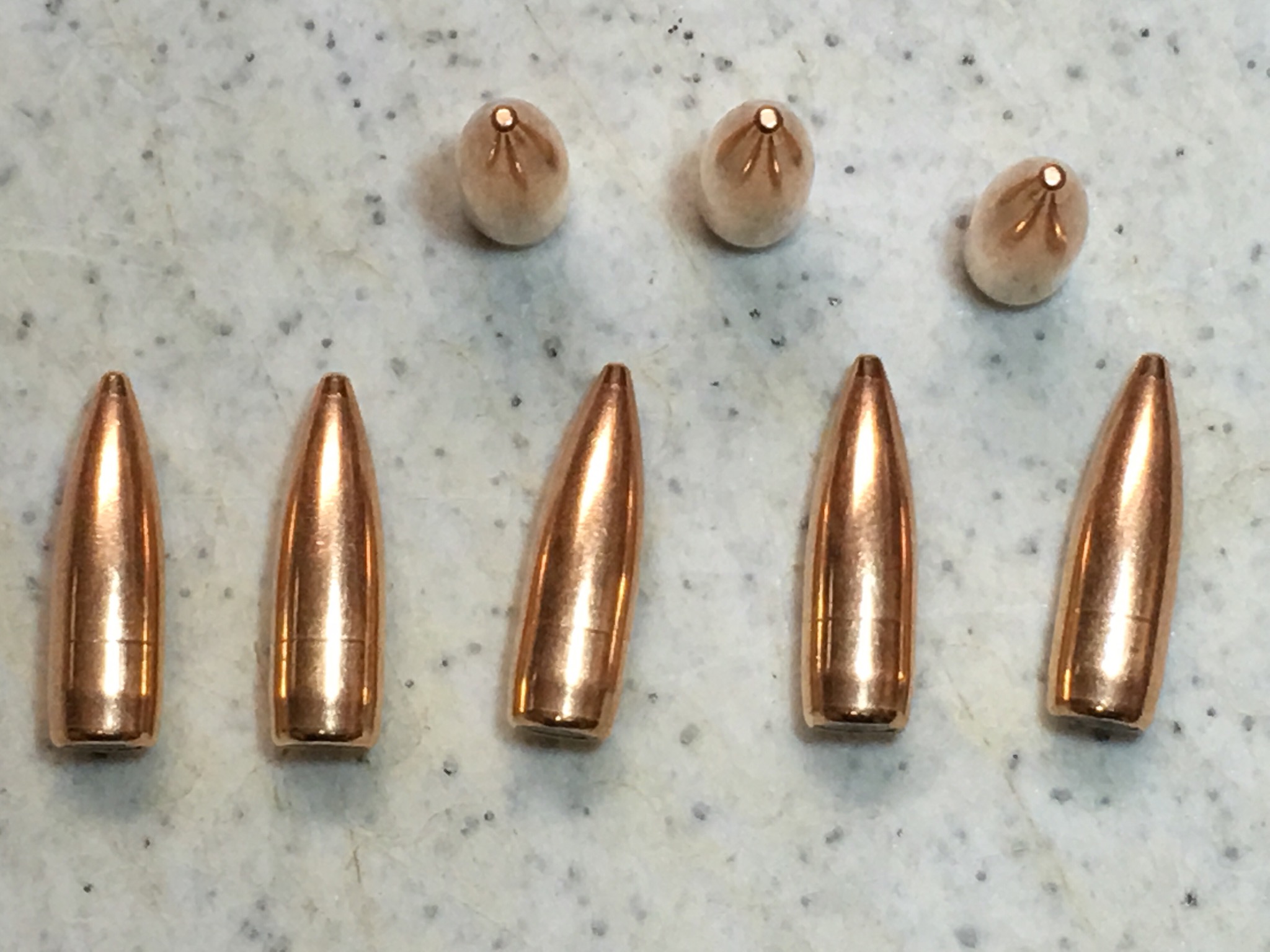

Have you tried Bob's Bullets? At $85/1000 shipped, I think they are going to be hard to beat for the price.
https://223bulkbullets.com/
https://223bulkbullets.com/product/223-rem-55-gn-fmj-non-cennelure-1000-count/

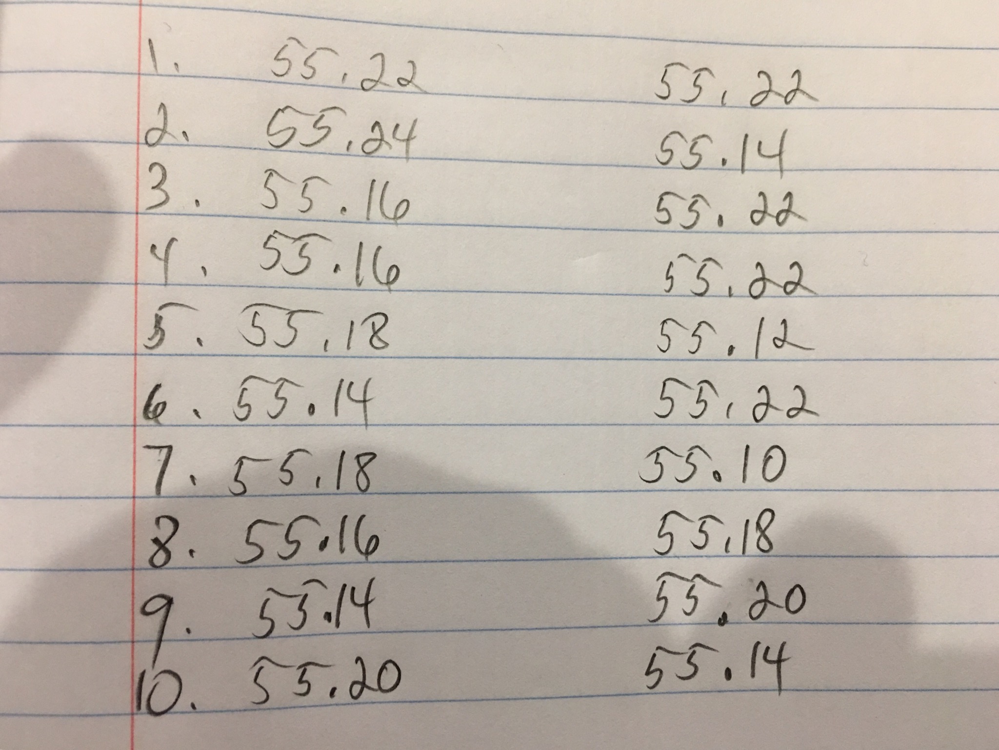

They have a non-canalure bullet that i think, so far, will be a darn good bullet. I bought 1000 of them and randomly picked out 20 and weighed them.
Those numbers look pretty good for bulk.

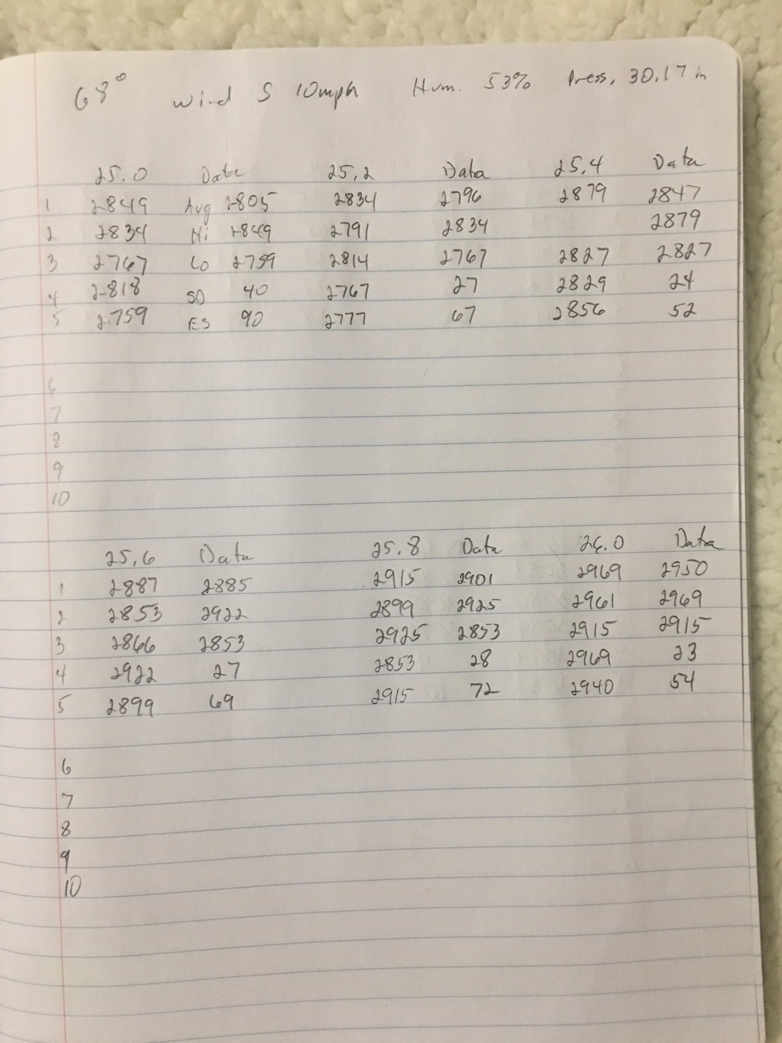

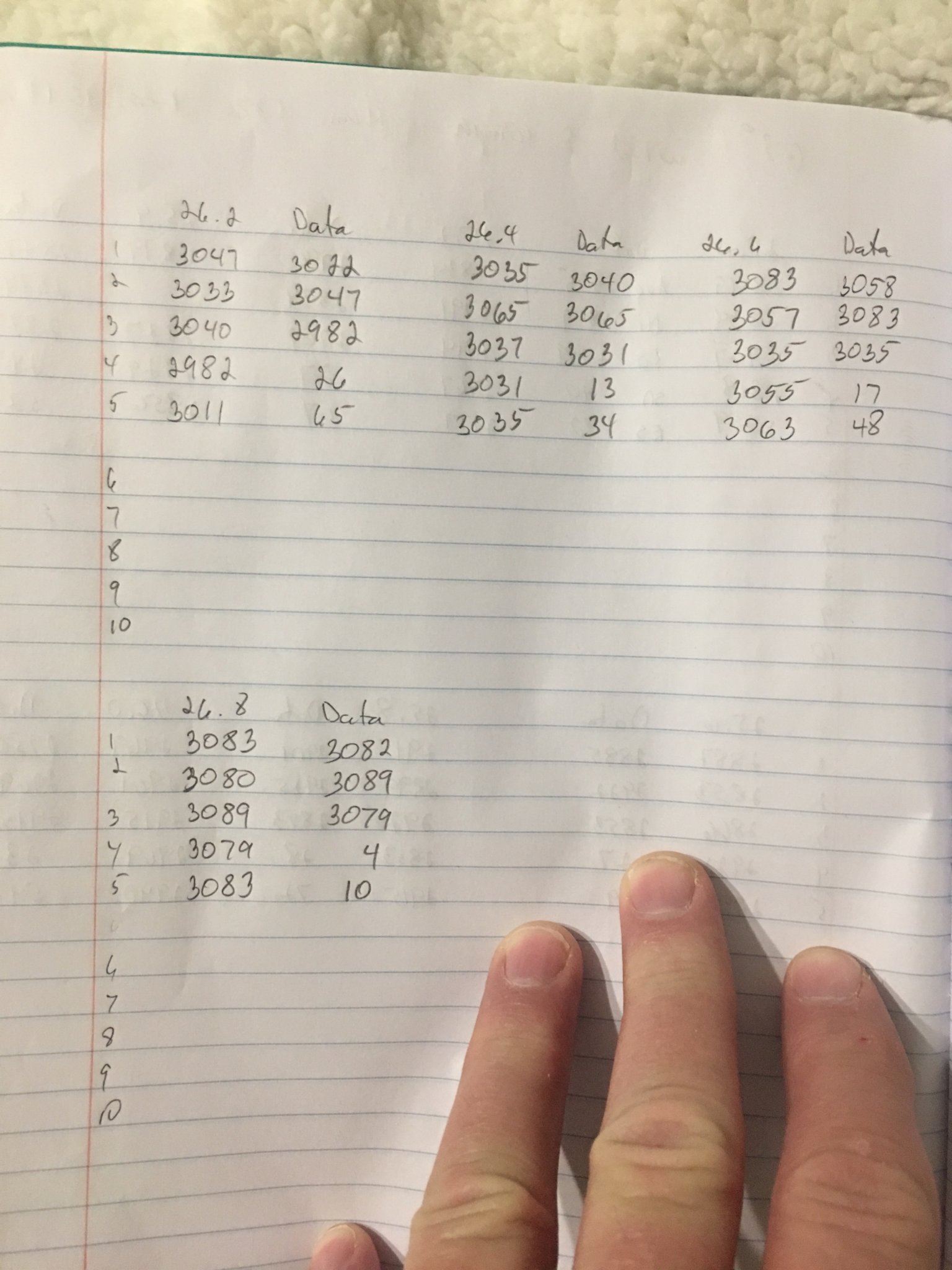

I loaded up a ladder of them and the numbers I was getting across my Chronograph were starting to look pretty impressive, but the groups sucked. Then I realized my scope was broken.
Here's the numbers from the chrono. All loads using Varget, starting with 25gr. up to 26.8gr.
Notice the numbers at 26.8 gr. I have not loaded up anymore of these, but I am going to, not that I have my scope back from the shop. I'm thinking that load will hopefully make some decent groups.
If these turn out to shoot as well as I think they are, I'm going to load up on them.
