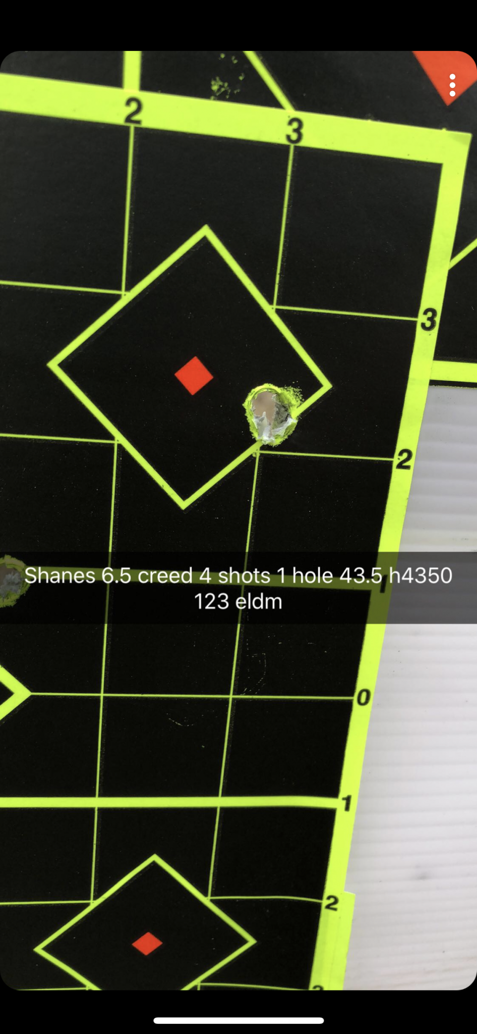

I just worked up a load on a bergera b14 hmr for a good friend of mine. It was my first experience with the rifle. Lets just say im very impressed. The only downfall would be the 22” barrel. I like a longer barrel personally. Its in a 6.5 Creedmoor and i found a load that produced a 4 shot 1 hole group with very little work. The action and trigger are very nice and the stock is as well. I have no experience with the tikka or ruger but id bet youd be very happy with the bergera.

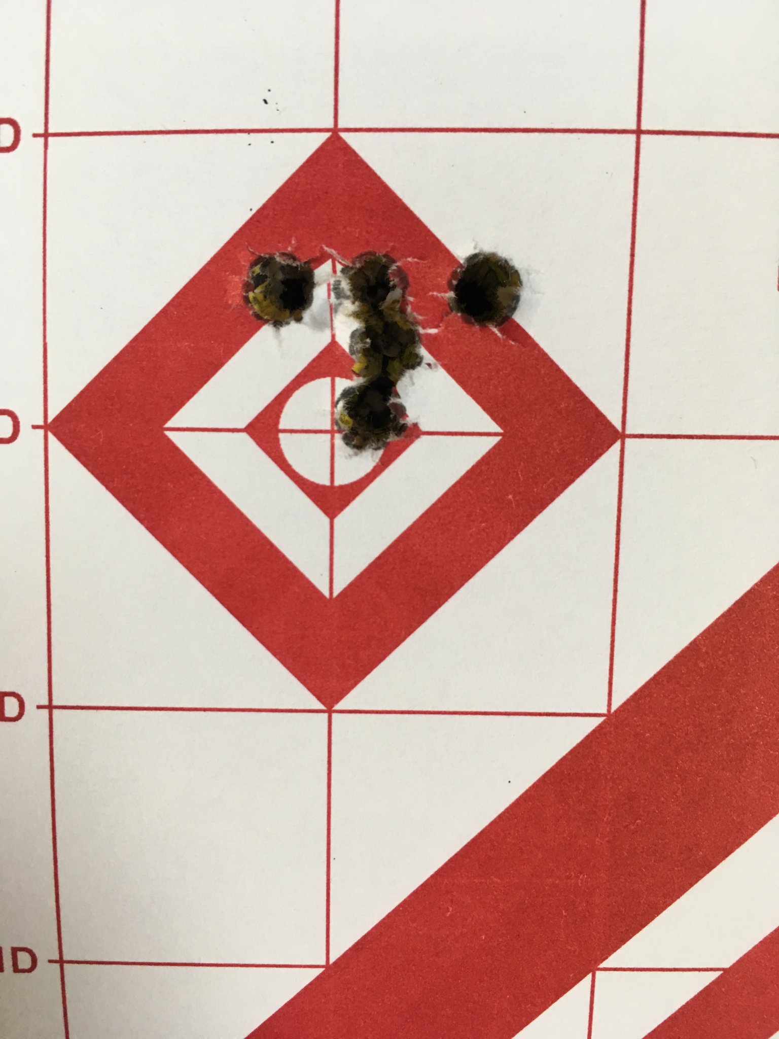

Here is what my plain Jane RPR does with bulk cheepo 140g ammo. This was with a hot barrel and smoking hot can.
Wasn’t trying that hard. Just a zero check after shooting steel for half an hour.
