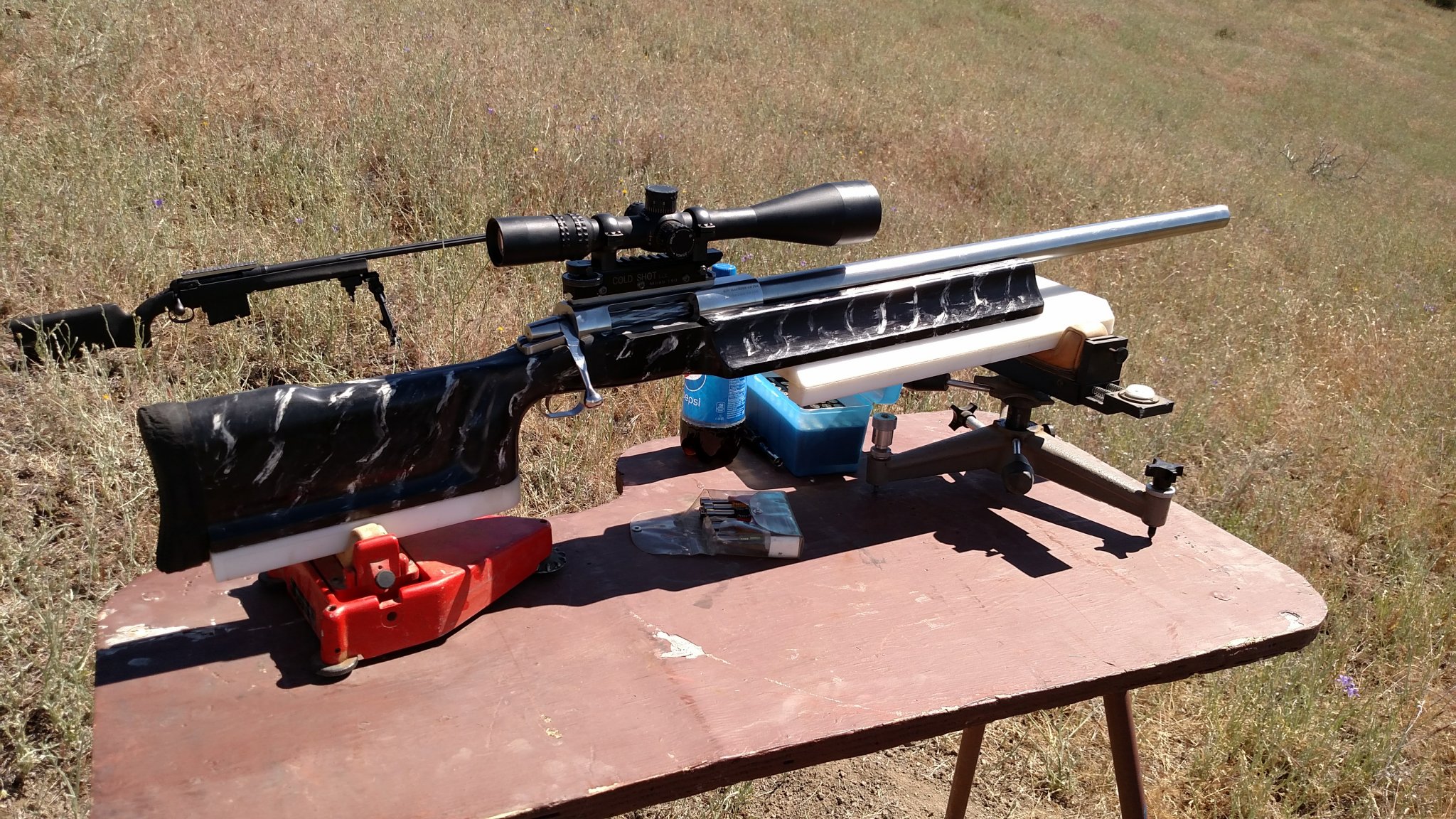

The picture is of one of our 2000 yard shooters who uses a 300 win mag with no issues.
I have used 6 Dasher 6mm-06 300WSM 338 Norma Ackley Improved 338 Lapua 338 Lapua Ackley Improved 338 SnipeTac 375-50BMG and 50 BMG and for overall ease the 338 Lapua is hard to beat.

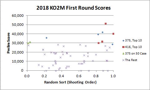

So this is one of the oddball stats that I ran for my own interests a while back and never really put out cause its meaning is slightly dubious but here goes.
In Ko2M 2018 the average score for targets out to 2095 yards was 9.6% higher with a 416 than a 375. I don't feel like I had enough 460 or 50 shooters to get an average that means anything. At longer ranges it gets a lot worse for the 375 scores but the 416 sample size isn't high enough for my tastes.
What we see is a huge difference in impacts off target that can be spotted from the line. 416 is going to be less sensitive to the wind and will easily stay supersonic to 2 miles. Some 416 shooters are also able to drop an external MOA adjustment need as they only have to be able to adjust from 1400 to 3500. That is asking a lot of a bullet and scope in 375.
Is 416 needed for 2000 yards? No, but it will probably give you more wiggle room that a 338.
-Alex
-Alex

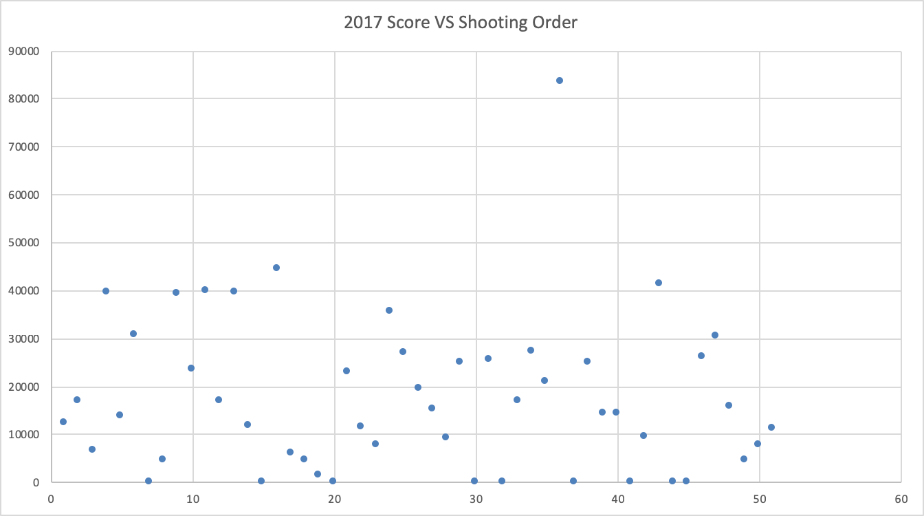

I did a similar analysis and came to the conclusion that the single largest determinant of 2018 KO2M success was first round shooting order.
In terms of making the top 10, shooting later on the second day appears to have been a significant advantage. It's hard to draw conclusions about what cartridge is best because of the small overall sample size. The 375CT has an bias for making the top 10 because it's over represented compared to the 416 and 375/50. It has a bias downwards in the overall average performance because it's the cheapest and most accessible of the 3 to shoot and more of the clueless are shooting it.
Using the 400 grain lazer for the 375 and the 500 for the 416, assuming 3100 fps for both, AB gives 2450 yards for the 375 to go transonic and 2650 for the 416 at 24"Hga. The 375 hits Mach 1 at 2850 yards. 3100 yards for the 416. My take on the best indicator for scoring potential is TOF. At 3500 yards its 6.47 seconds for the 375 and 6.151 seconds for the 416, not a huge difference.
I think the 416 is arguably the "best" of the currently available rounds, but it's a serious step up in cost for an insignificant in the grand scheme of things performance bump. Similarly, the 375 is pretty much a solids only proposition and is a serious step up in cost from the 338 and the 300 Hybrid. Litz ran step for step with the 375 Lethal Mag using a 338 Edge and 300 Hybrid on the second day of the 2016 event.
My point is there are much larger issues determining hit percentages than the "best" cartridge.
That is interesting and it is possible that there were favorable wind conditions towards the end of day two. I'll go back and look at the video. Usually the best conditions are early in the day and they get worse from there. I ran the same plot for 2017 and Derek crushed while there was overall poor shooting happening around him so in the end I'm not sure either show much more that random clustering.
It is only after running these numbers that I realized that my chart is using the final scores rather than the prelim scores. which would be even less profound.
-Alex

Are these stats only out to 2200 yards as the OP asked or are they to 3520 yards?
His stats are out to about 2100. Mine included data from out to 3500 as well.
-Alex
The problem with those stats and I love stats is all those shooters were anticipating what is needed for 3500+ yards.
Tell that same group the limit is 2200 yards and there chamberings might have been different?
Reactions: jaybigboy34
Actually
2017 had a 375 Cheytac take top honors
2018 was a 416 Barrett
