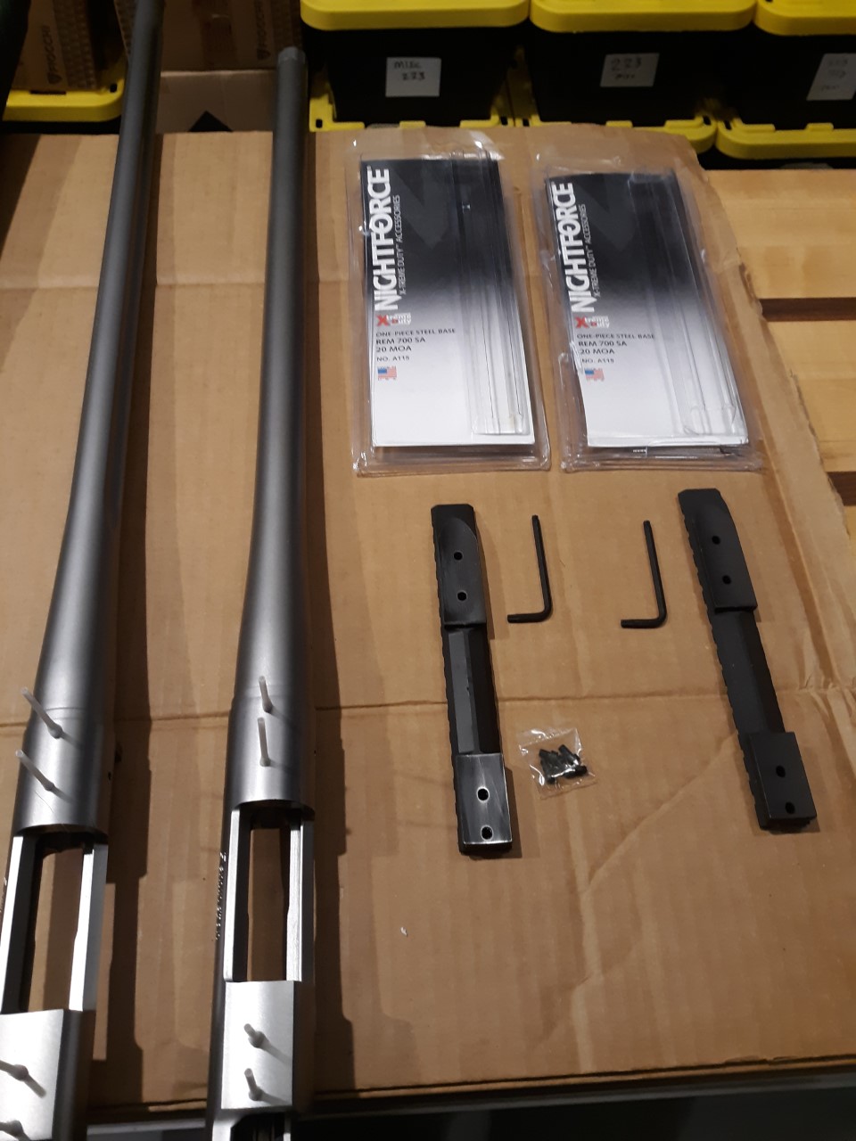

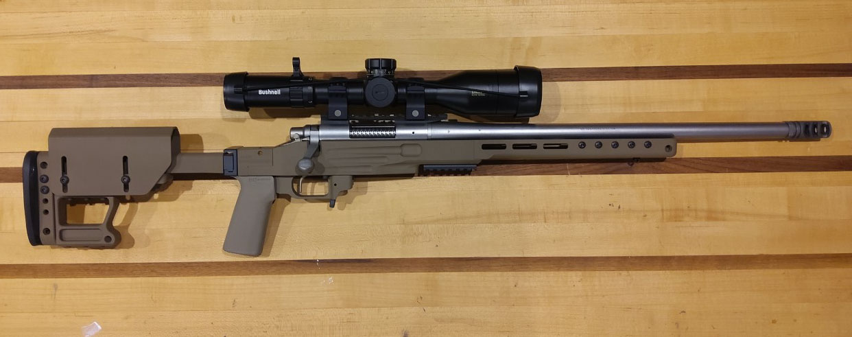

Base: 20 MOA NF steel, Badger, or Murphy stainless or titanium. Bed the base.
Rings: NF

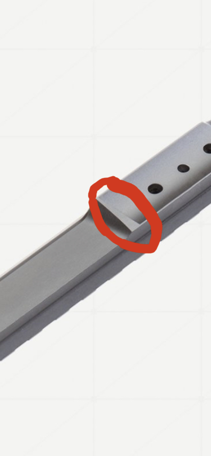

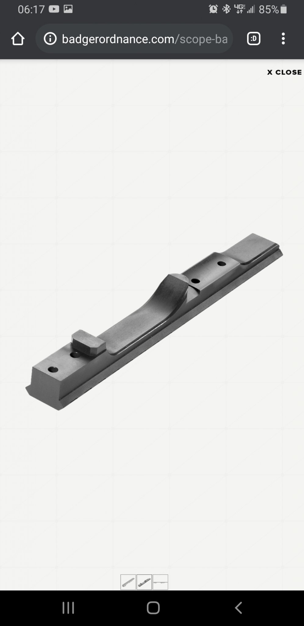

On the Badger I don't see a recoil lug on the regular rail. Only on the M40A3 seems to have one. Am I missing something? 1 pic is the A3 other is regular Rem700. Maybe I am missing what "integrated" means?

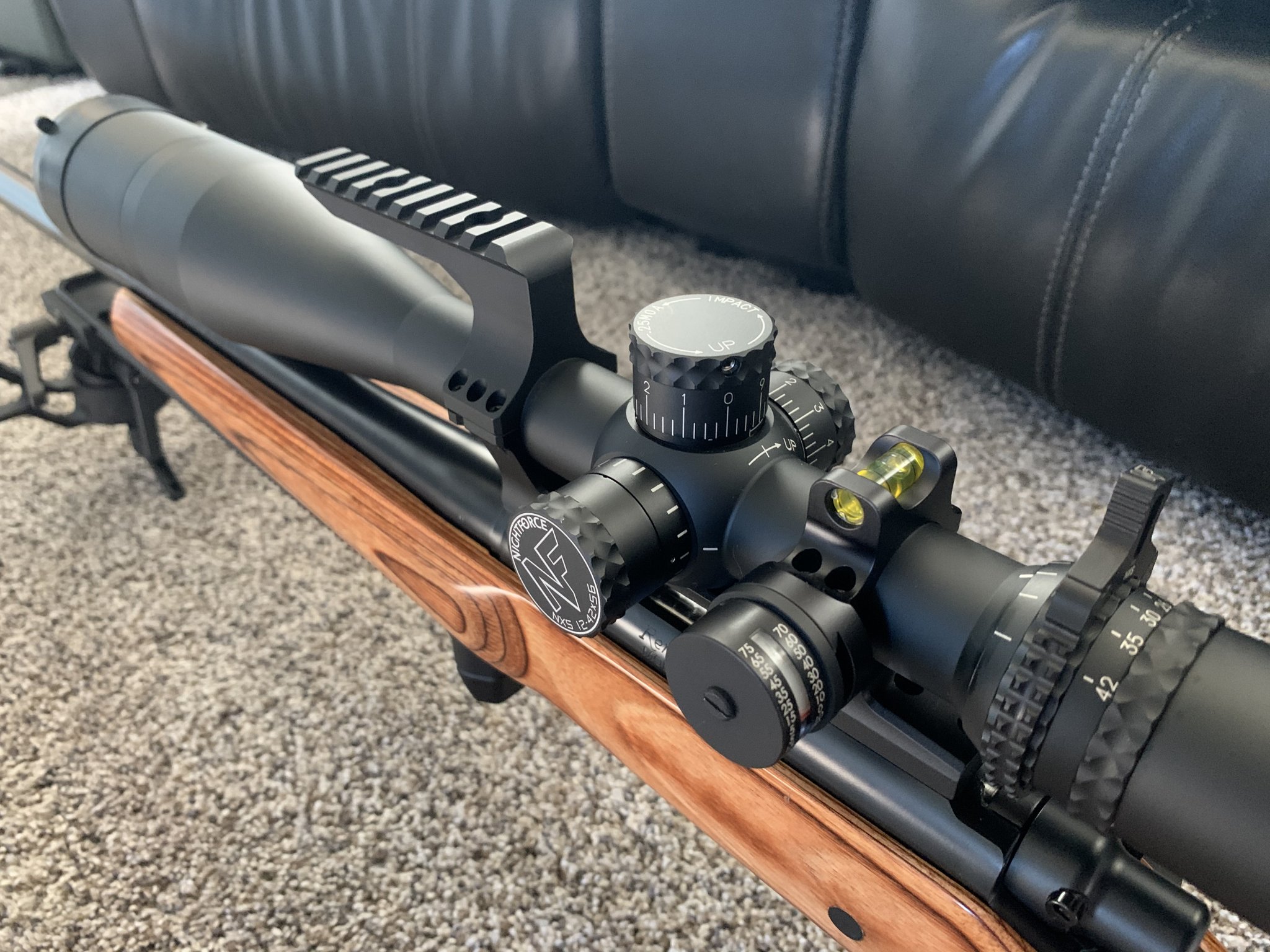

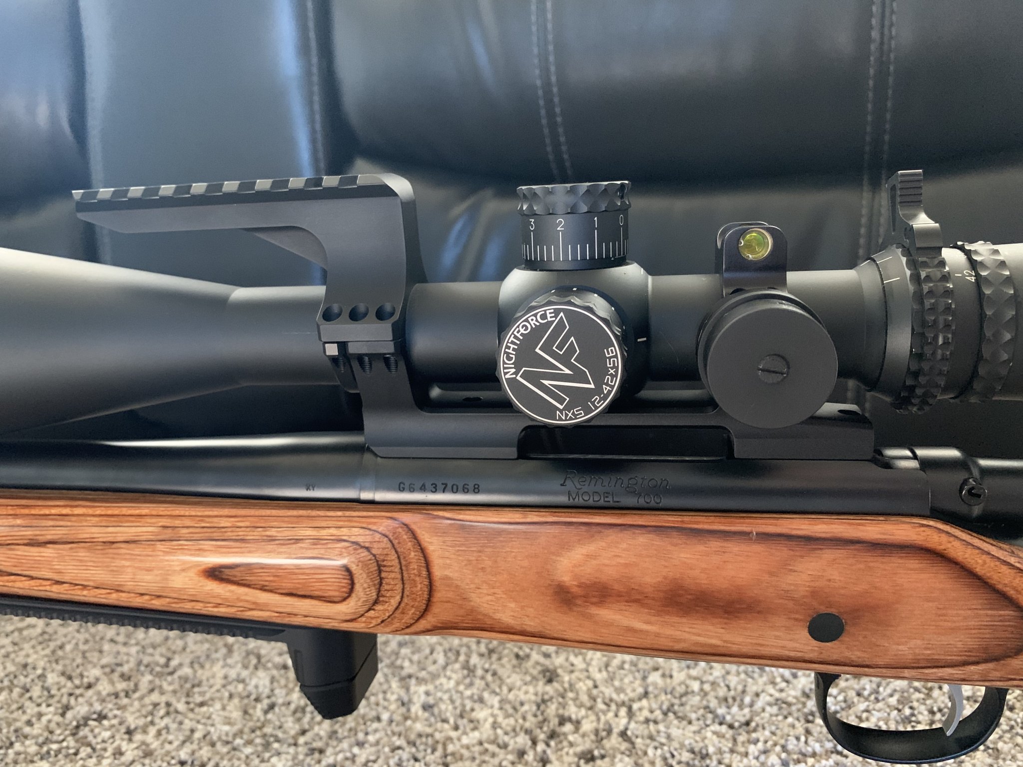

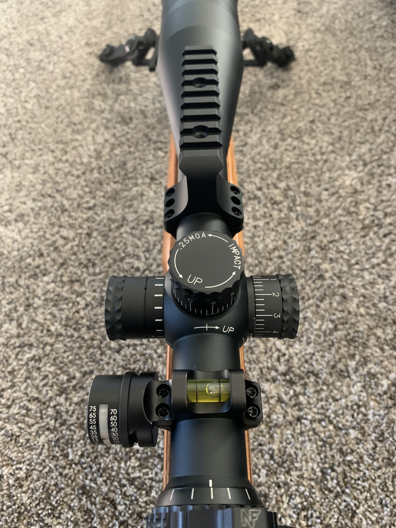

I happen to have this fully kitted out NF direct mount for sale - low 30mm - 20 moa cant
Wether it sells or not I absolutely love it, just need more height to clear my big can! I highly recommend these things to everyone.
Btw the low rings are good to go on my 56mm nxs, barely clears but there is clearance nonetheless
