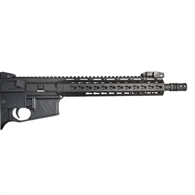

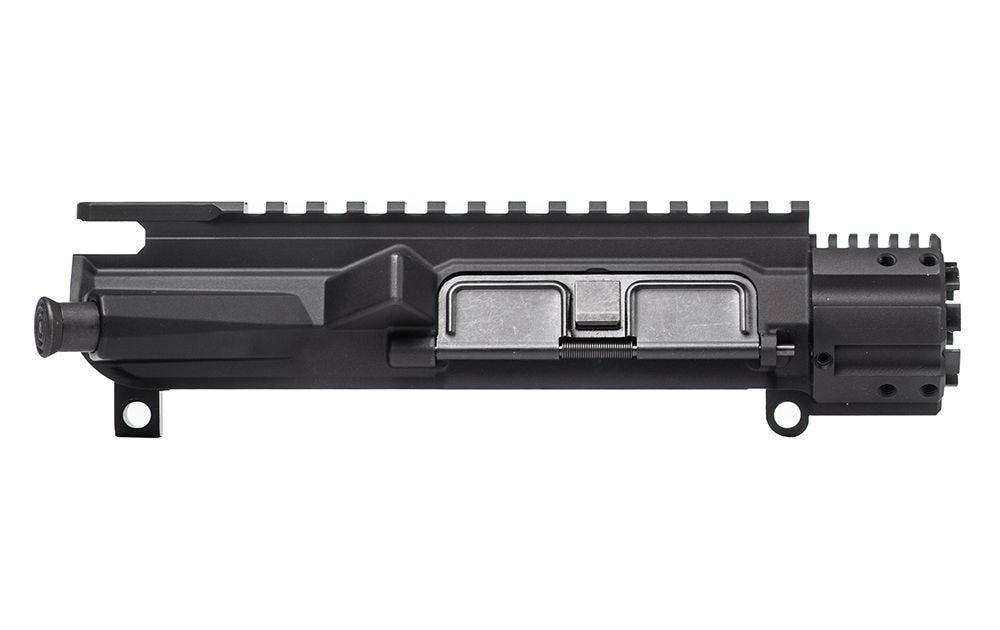

The two most rigid uppers I can think of are the Aero Precision M4E1, and Vltor VIS upper system. They both use proprietary handguard mounting but have a large selection of styles and lengths.
Both offers have a lot of material behind the barrel mounting area, in front of the ejection port, which is typically the weak point.
The Aero Precision option is very affordable and a good foundation for a very solid upper receiver system. The m4e1 handguards have plenty of room in them for adjustable gas blocks. One of the most accurate ARs I own is built on an aero upper.

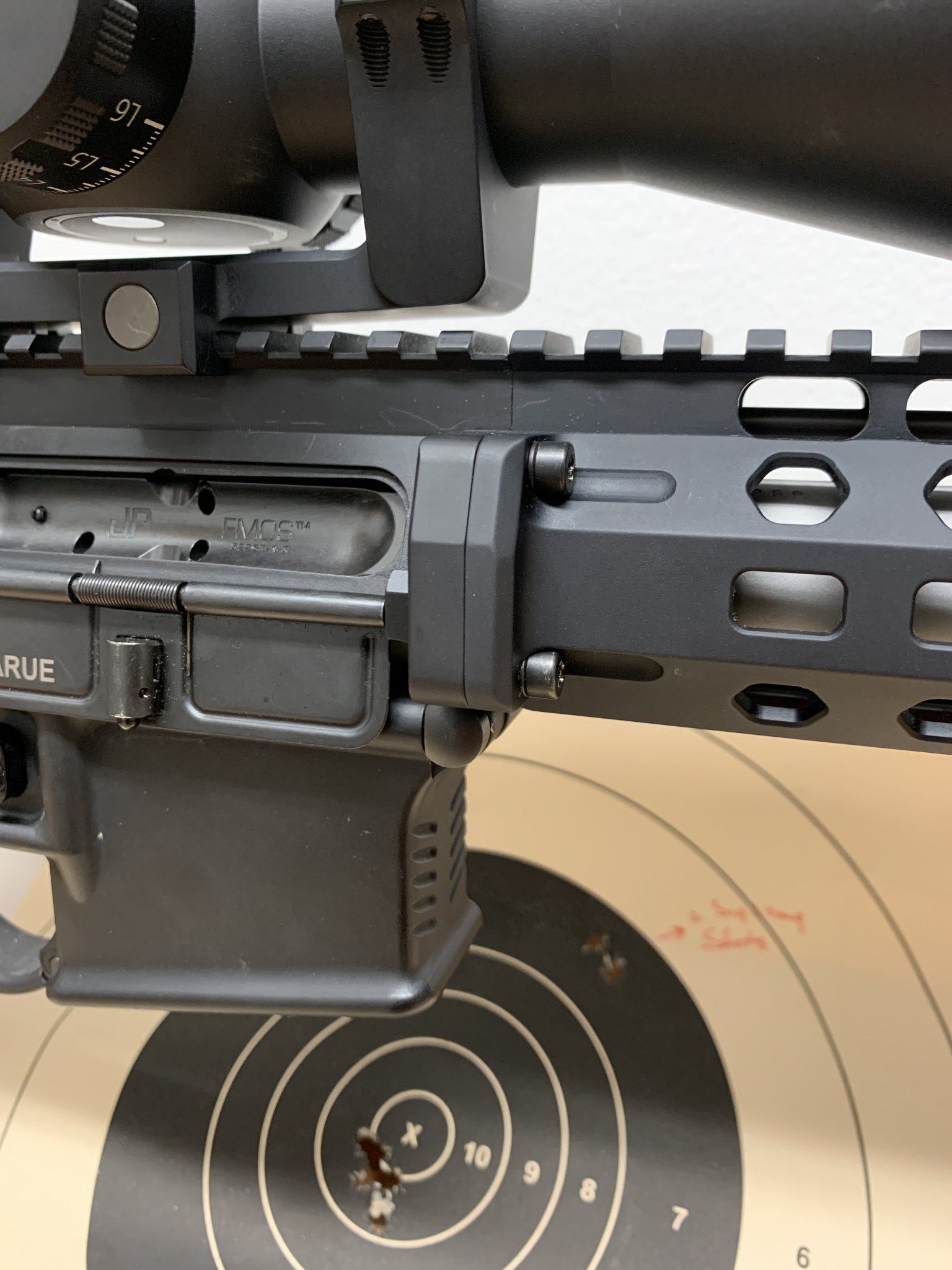

I am very happy with the larue 2.0 upper. It is absolutely rock solid. By far the most rigid system I have found. Consistency is definitely there and would recommend it.

It was a snug fit with the bat barrel extention but defiantly wasn’t a thermo fit. It shoots very well.

I started watching this thread a year ago (almost to the day) and since then I've installed two of the larue stealth 2.0 upper/handguard combos. Having had them, I can reassure you both that they are fantastic and very rigid. A word of caution, however, they aren't super lightweight, nor are they thermofit. For precision, you probably can't do better than this set, but I would shim your barrel extension with some thin stainless steel shim stock before installing the barrel. Also, check your gas block dimensions before you buy (or get a small gas block). I had to file down the inside of one of my handguard to get enough clearance for the gas block.
All considered, they are worth it and the best "monolithic" set out there (I've had a seekins too, and I prefer the larue). I have a third upper/handguard set that is sitting around doing nothing, so if you want to skip the two month wait time let me know and I'll sell it to you, but I don't plan on losing money on it. It's mlok, 13". I bought straight from Larue in the spring.
