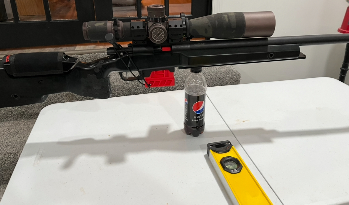

Interested in the consensus on what the most weight tunable PRS-type chassis is. Defining this as the largest delta between absolute minimum weight and a reasonable maximum weight (loaded with internal weights, buttstock weights if applicable, all accessory slots loaded with external weights).
I think it might be the xlr envy pro with its internal weights and c6 buttstock weights but curious what everyone’s experience has been. Thanks!
Most stocks and chassis can be made “relatively light” and pretty heavy. I have seen many who think the Foundations are hard to balance. You decide….
