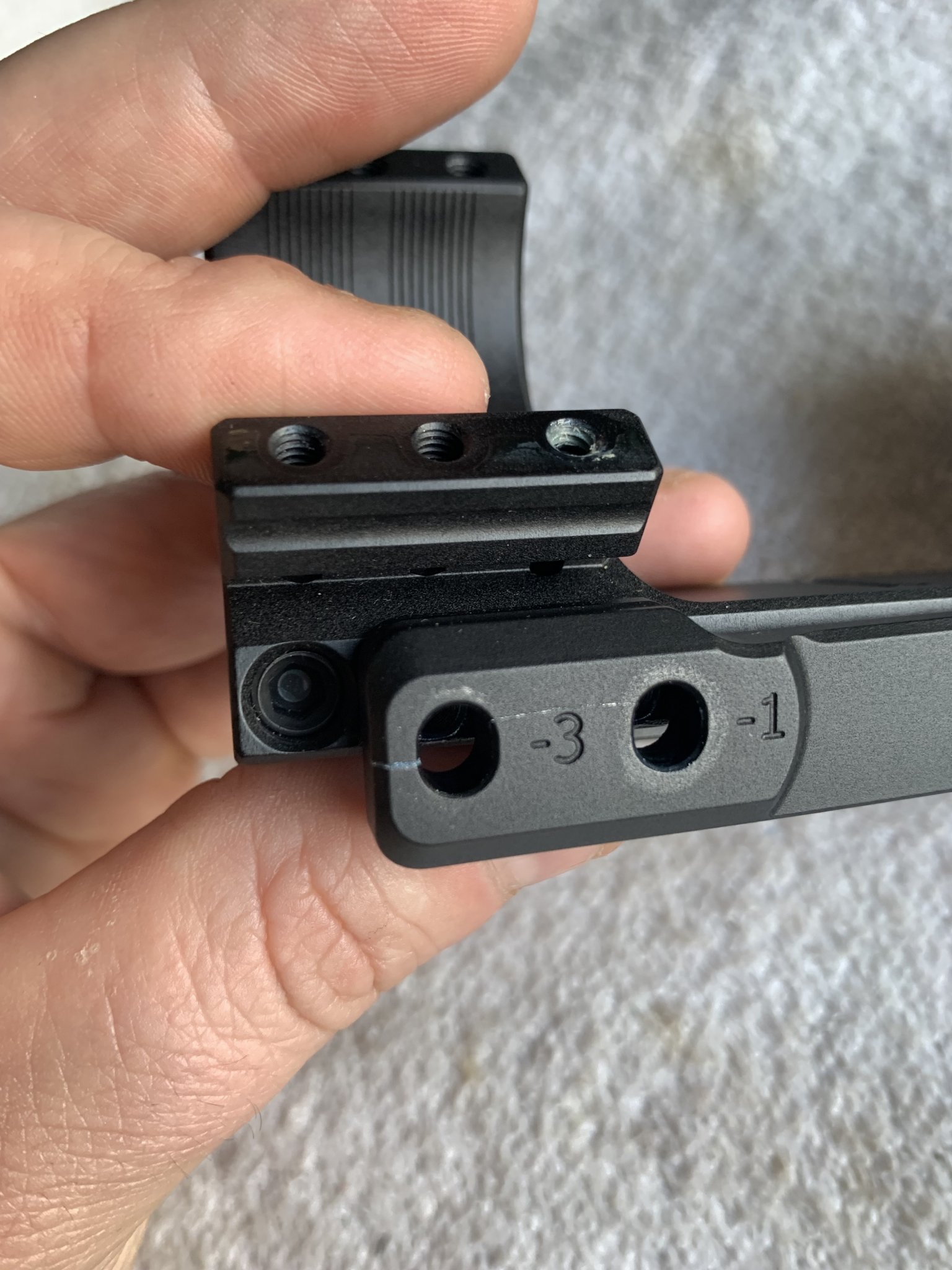

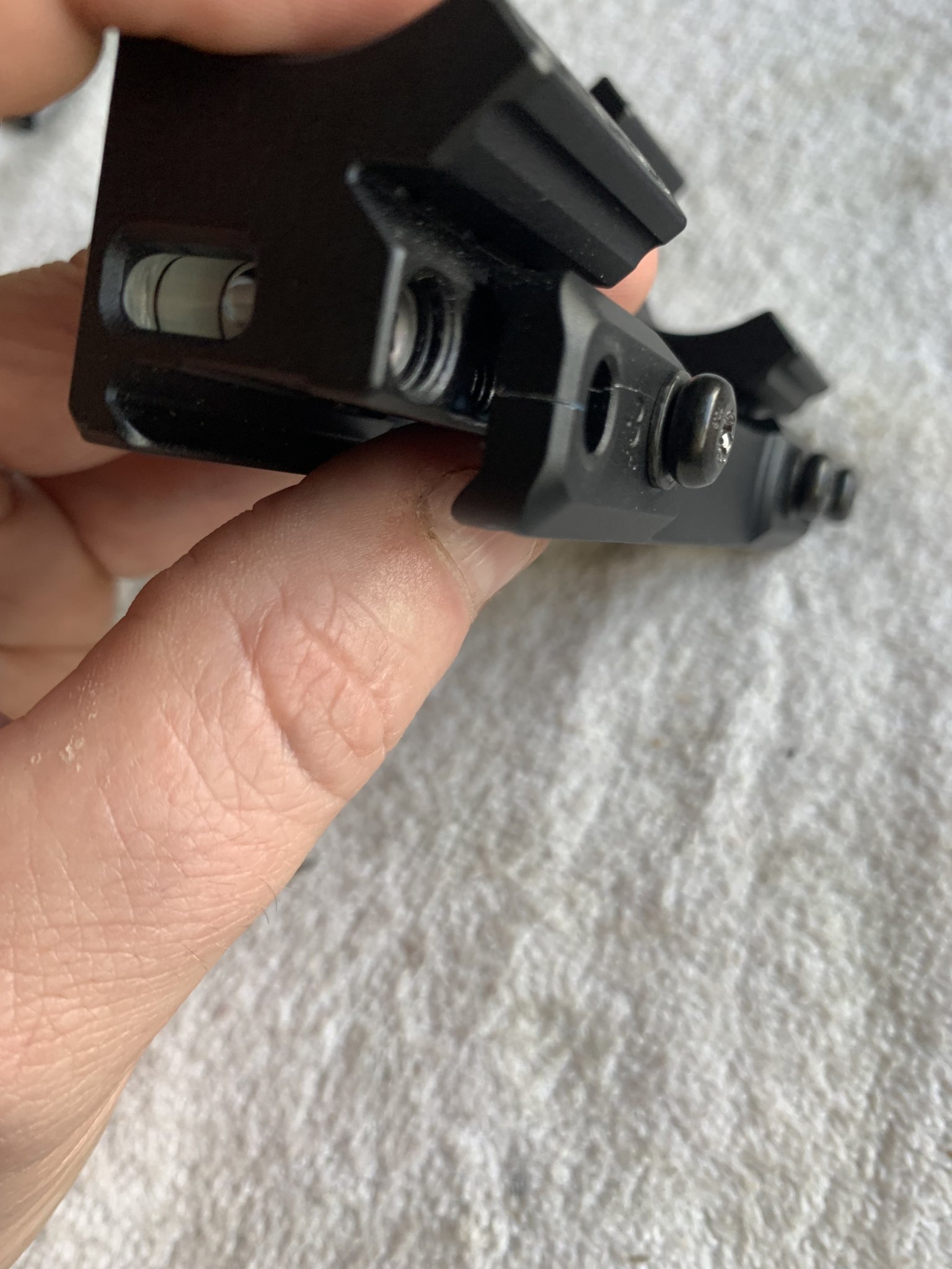

I have spuhr mounts on my atacr’s. I have however cracked the crossbar while torquing to spec.

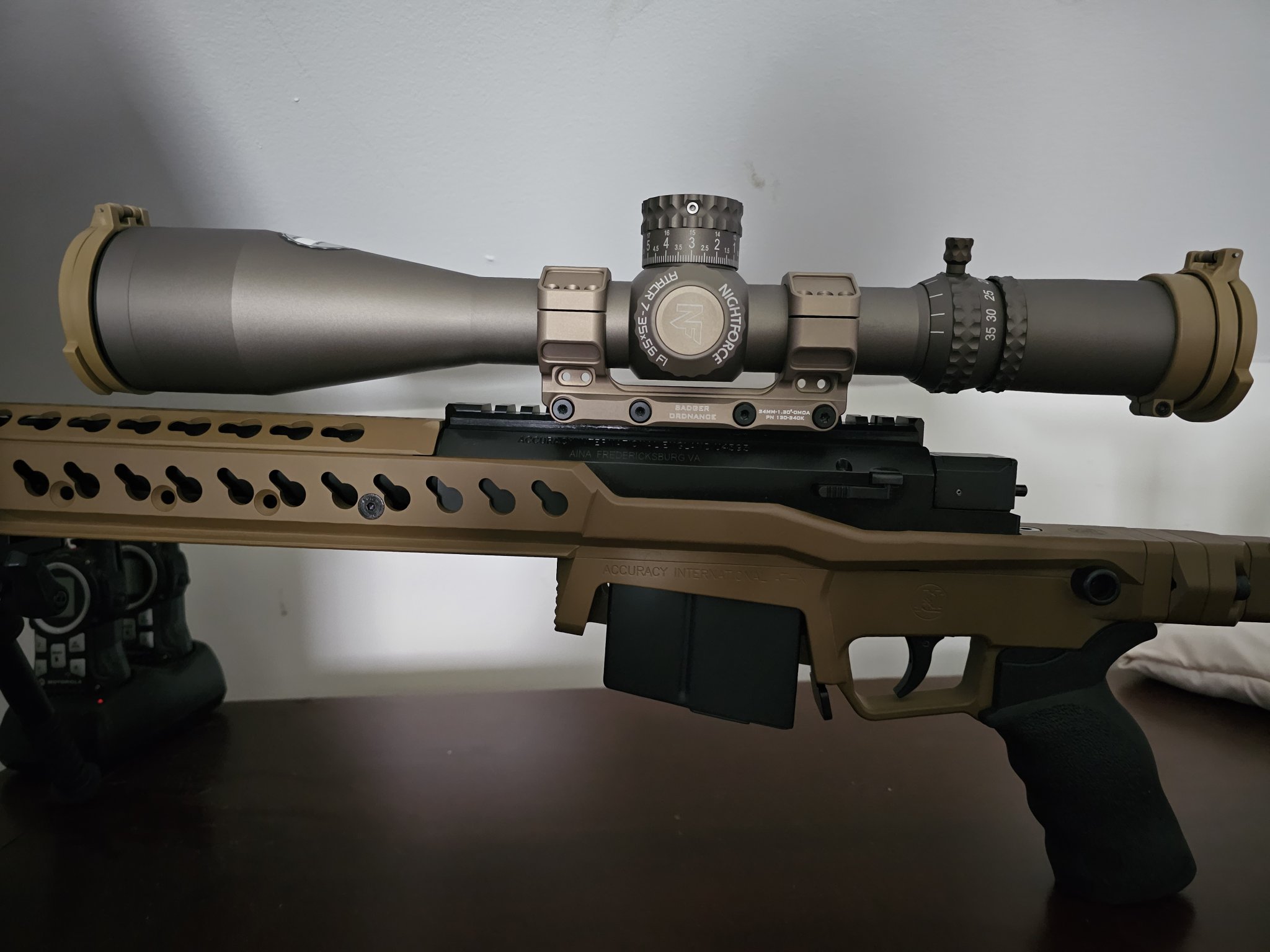

NF UltraMount and a set of fix it sticks for it. That’s all you need. It’s up to you if you want 0MOA or 20MOA but you don’t need a QD mount.
I have the NF UM with my 735 ATACR on my AXSR. That shit doesn’t move despite bouncing around in the truck in the desert or banging on shit at matches. It’s a really solid mount.
Same here util they beefed them up, their C/S from that experience can only be equalled by Zermatt Arms in my dealings.
I had two mounts of that type, only had one crack, sent me out replacements for both immediately.

I just got the Nightforce 20 MOA FDE Ultramount. I’ll let you know how it performs.
Pete
Mine was the beefed up version

Oh...... That's not great.
Assuming you're getting looked after?
Still a PITA though.....

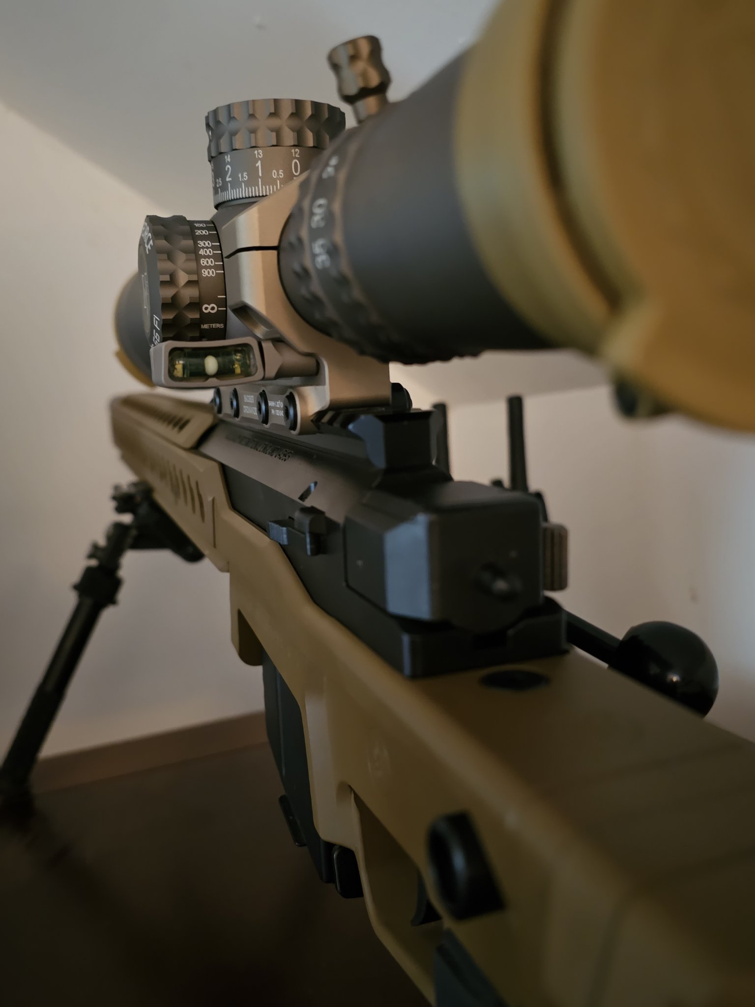

thank you for all the assistance. I did pick this up:
Spuhr SP-4602 FDE​
should be here in a few days. Looking at the bipod and a tool kit.

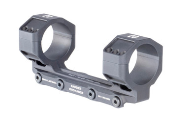

Badger makes great stuff and while dated (like the NF Ultramount) they are still a solid option. The newer C1 mounts are pretty nice as is the new grey ops and the MPA. Hard to really go wrong with any of them.
Spuhr SP-4602 FDE​
