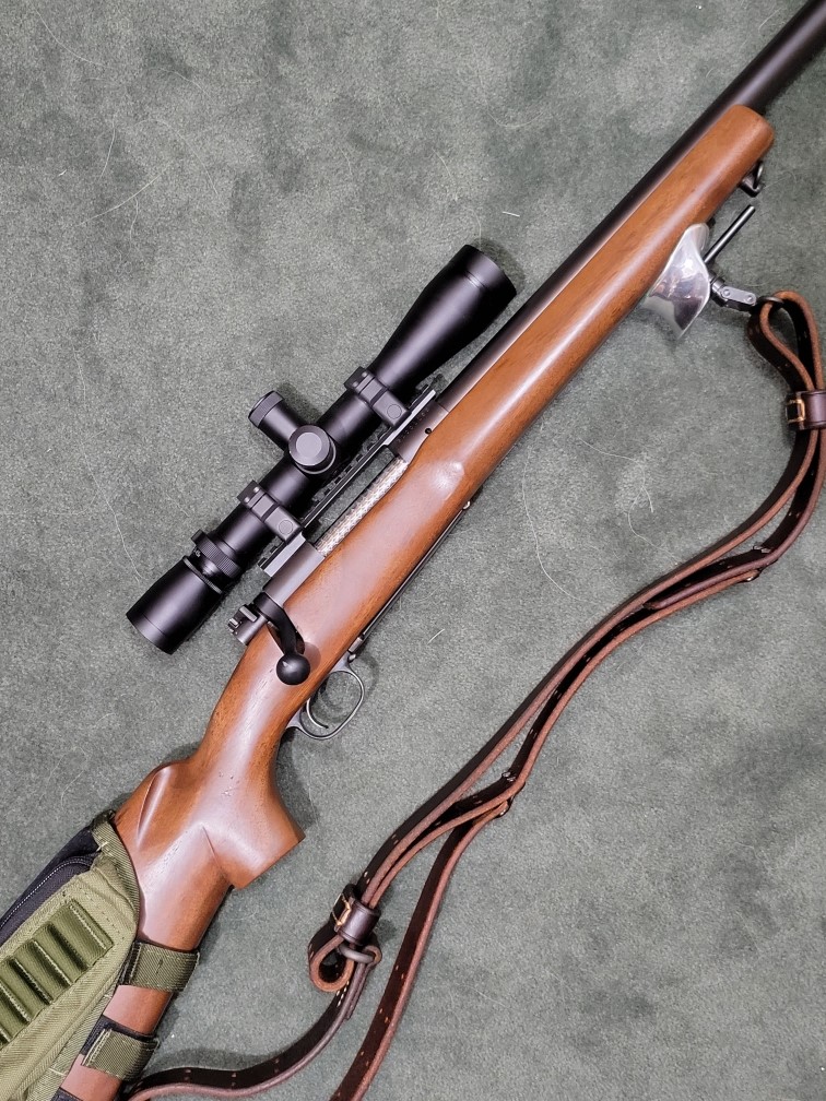

I did something similar to what you are wanting to do... I had a Leupold 1 piece base so I used it. It works ok, but with the clip slot in the receiver I could only put 1 screw in the back instead of 2 : /
Did the same kind of thing, except added the correct space rear hole in the base.
Badger and NF sold one piece bases with 5 holes, to fit either set up.
Nice setup !
Thanks! It is surprising how cheap you can pick up a Post 64 Model 70...

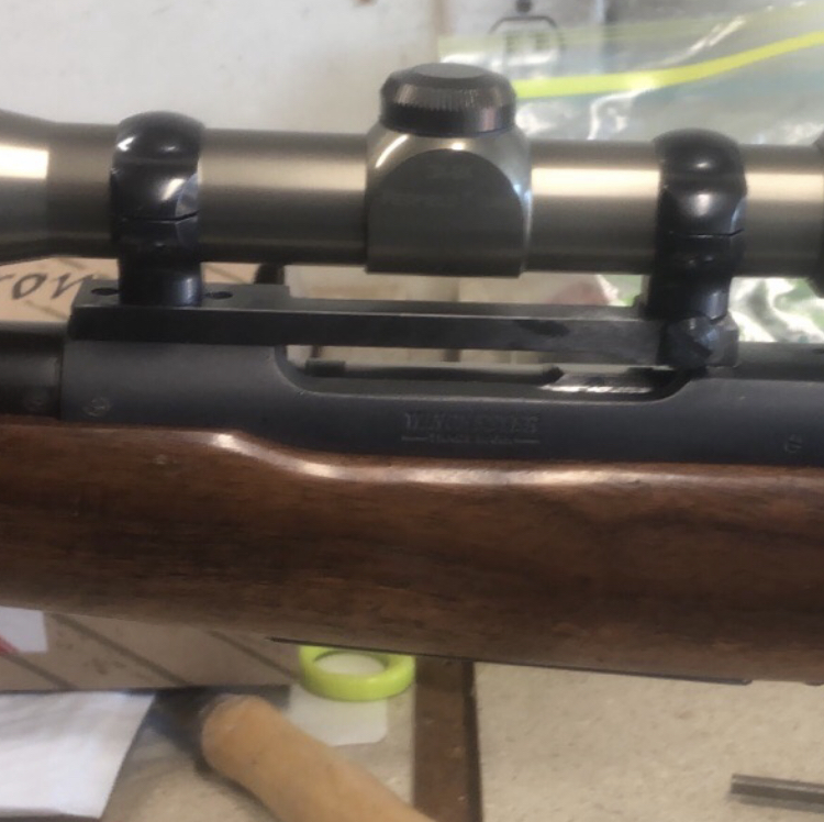

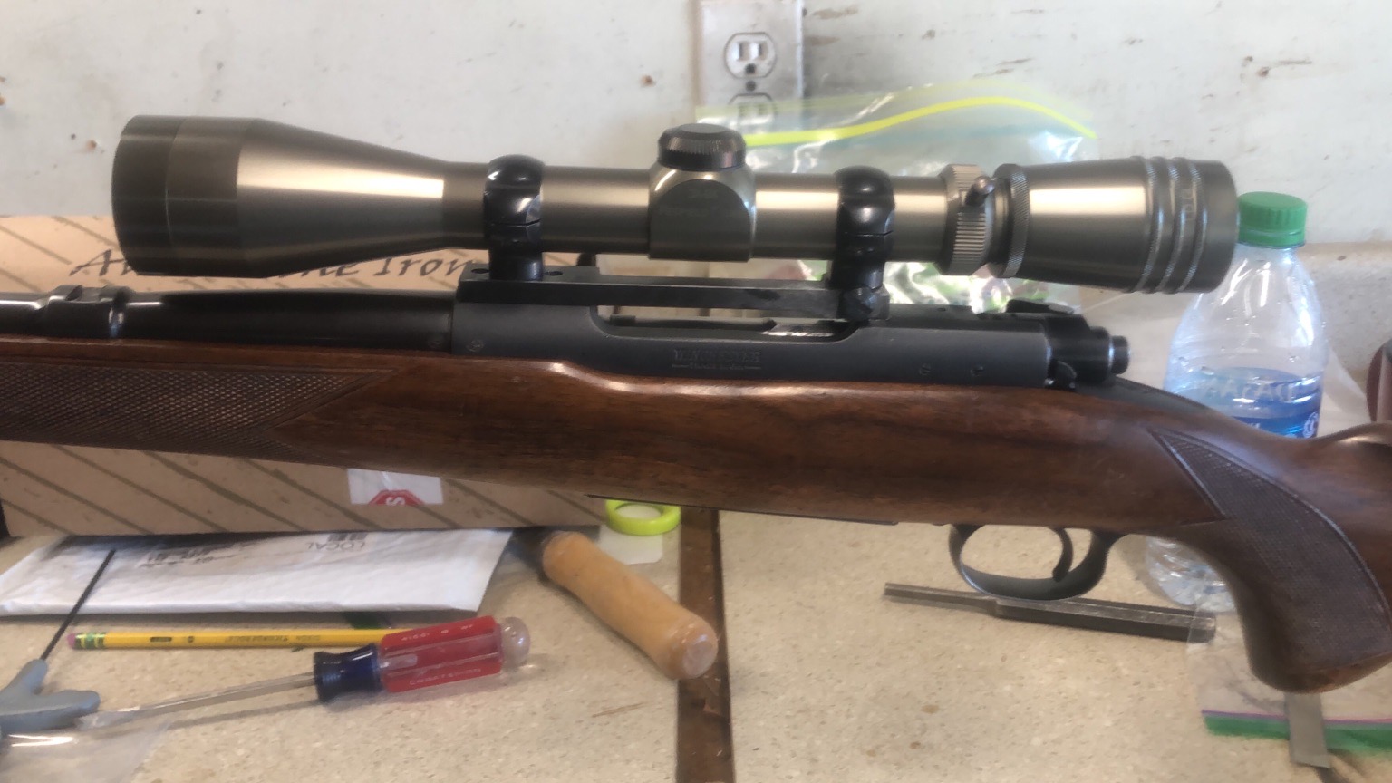

So, I got the rifle back from Barlow.
He mounted a Weaver T6 in a Redfield mount with 4 screw rings.
I went with the T6, cause my T10 needs to get the lens cleaned and change from a plain crosshair to maybe just a duplex.
Barlow also found a cracked hinge plate for the floorplate... luckily he found one in the shop.
He fabricated shims for the floor plate and trigger guard...said the magazine box wasnt properly supported.
Found the aperture sight mount was compressing into the stock, so that was removed.
The bolt release spring had been modified for the aftermarket trigger..he now thinks it's a Canjar. He replaced the spring and modified it differently to work.
He also properly modded the trigger guard for the aftermarket trigger.
He says the mods should extend the life of the stock, but eventually it will need the full repair.
Still waffling, but I'm in it now. I'll try to get to the range and see how it shoots. Eventually set the barrel back.

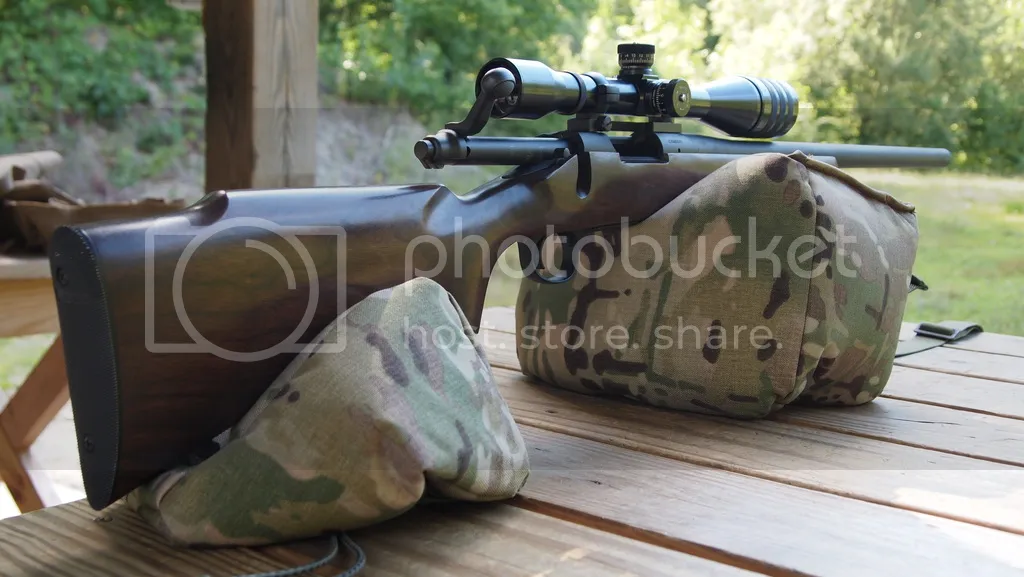

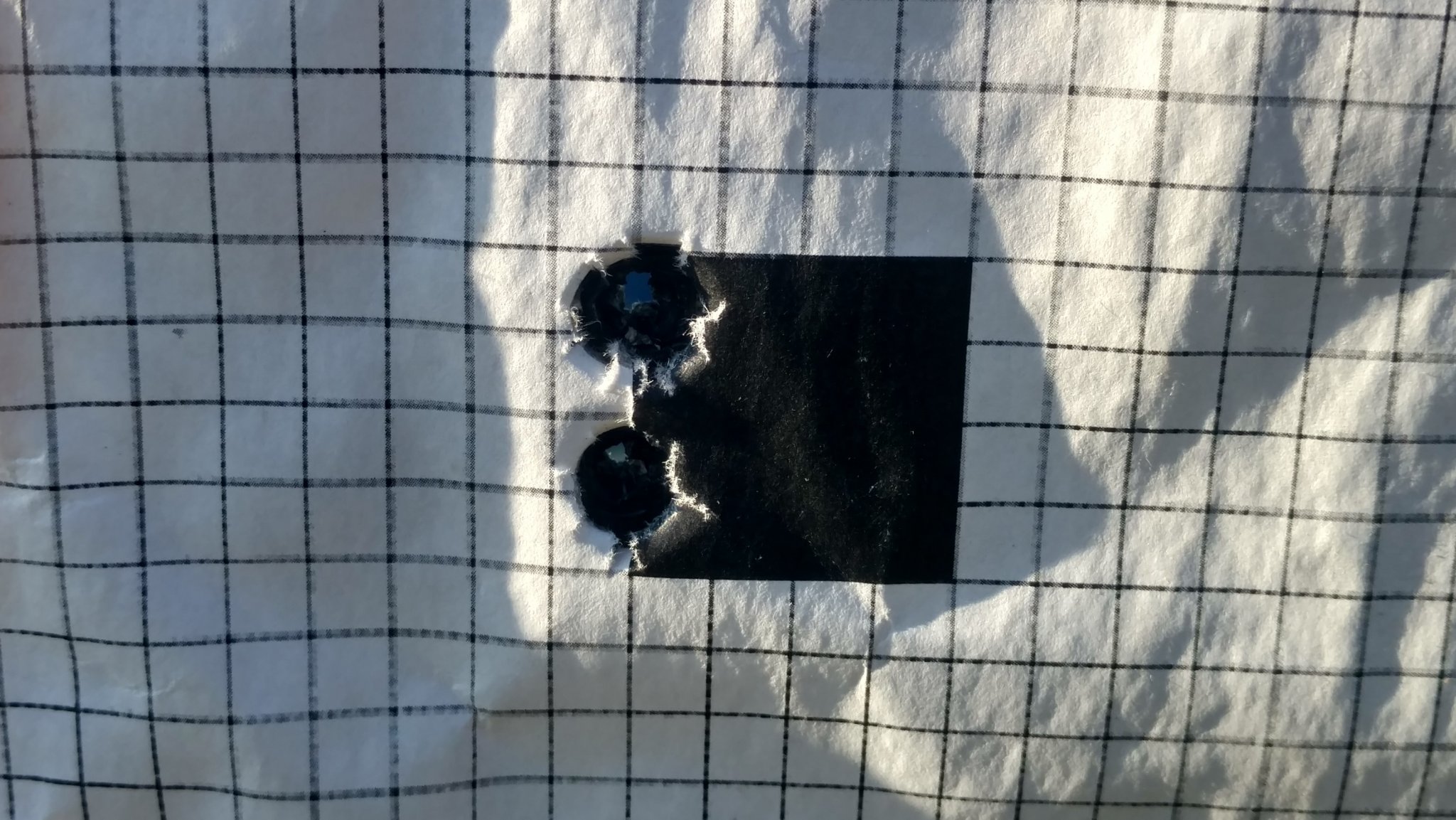

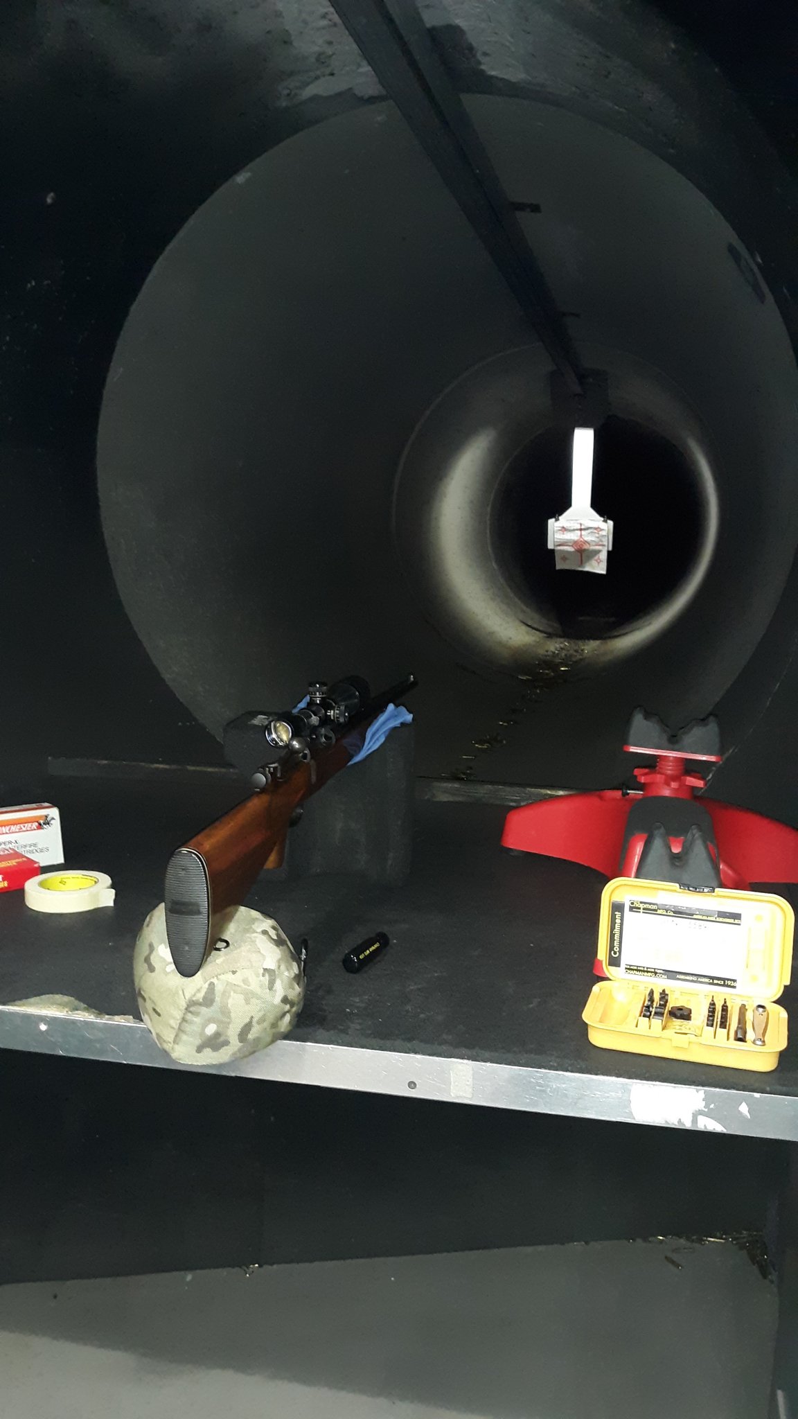

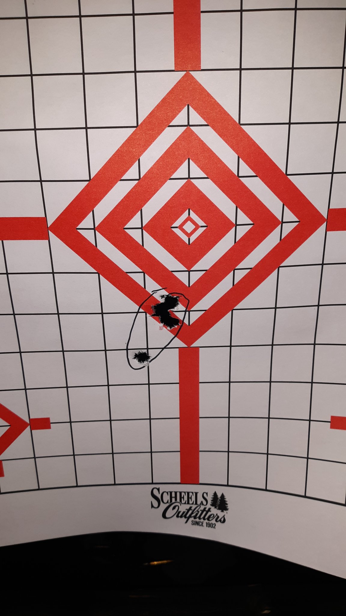

I was finally able to get the M70 Target to the range. Went to an indoor range with a 100yd tunnel.
After using some left over hunting ammo and some American Eagle ball..I was not feeling good about it.
Then I shot this group with 168FGMM....
Admittedly, it's a cherry picked 5 shot group, but..I'm not the precision rifle shooter that the guys here are, and..the shooting position and dark tunnel made it more difficult. Nor the fixed 6x weaver T6
I'll see what I can do outside, but the weather is getting rough.

Don't think I'll do any serious shooting at the tunnel...wanted to shoot some of the 22s there, but that lighting just sux...you don't know where you are in the scope.

I ran my T-10n on an M40 in .308...I see photobucket has stolen my photos.....
It sits as a spare now in my gun cabinet.
