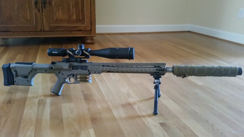

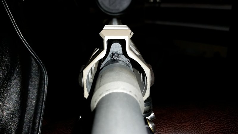

I am running a heavy 20" WOP barrel under my 15" Armalite comp keymod rail. I have used Magpul nylon or Seekins aluminum 5-slot rail section at the front and either an Atlas or Harris mounted to that. My SA gas block is about 1/8" from touching the top or bottom of the block to the ID of the rail. I have seen no accuracy indicators or marks inside the handrail to indicate excessive flex. I load the bipod enough that a Magpul nylon rail flexed quite visibly with the bipod attached, hence the aluminum version now in use.
If your gas block is near the mount point of the short 1913 rail, just make sure the mounting screws for the rail do not protrude through the lock nut or plate and press into the gas block. I've only had the issue with an MLOK set up and simply shorten the screws a tad.
