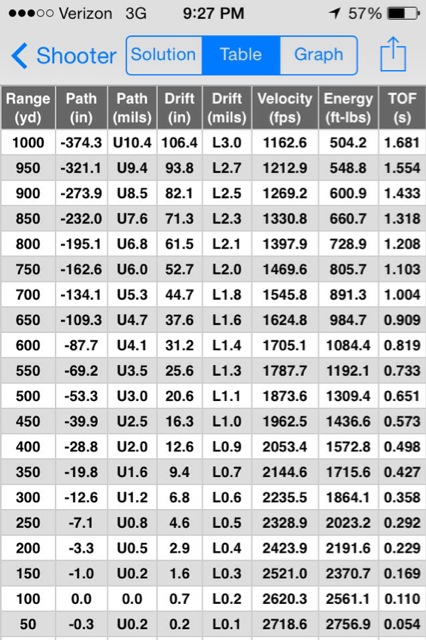

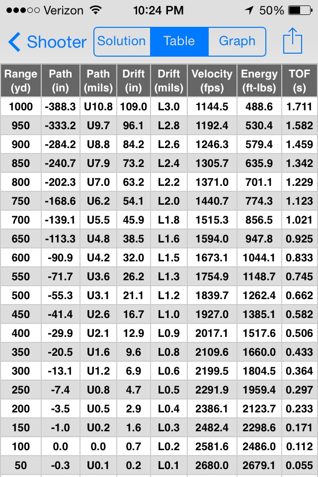

This is what I ended up with.
It's set up with a full value 10mph wind but there wasn't actually much wind ImageUploadedByTapatalk1412040515.482161.jpg
Sorry. I screwed up and posted the wrong one. I was playing around with the elevation to see how much difference it would make. As it's posted right now is exactly what I had.

For reference this is what I started with.
There was one adjustment in between. In each case shots were either on target or or just off the edges of the 12"x12" plate at 1000 or 700 and then started falling quite a bit over the target. When this happened I adjusted until elevation was back on target and then went back to the program and tweaked the speed until it lined up with what the bullets were doing. Each time I shot at other targets using the new formula to confirm it was correct and each time the bullets were back on target.
The only thing I could think of is that the conditions or velocity changed or something on the rifle moved so that it was changing my zero in a way that was temporarily repeatable and wasn't effecting windage which is also possible.
