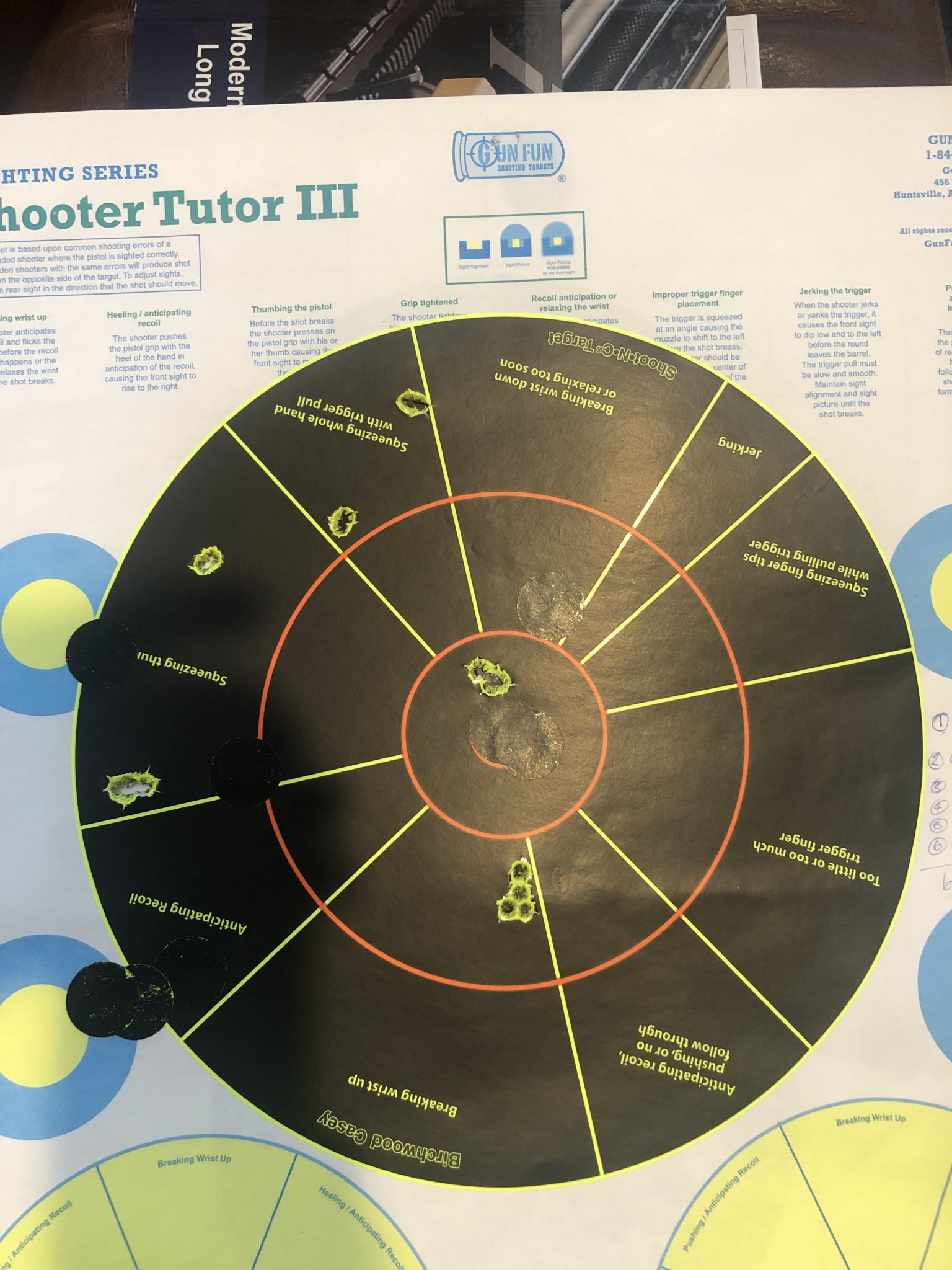

Just to provide an update:
Shot the rifle yesterday at 50 and 100 yards, and had zero feeding or extraction issues. After shooting 40 rounds of Hornady 140 ELD-M, i cannot be happier! Group size at 50 averaged just below 1/4”, while 100 yard groups were around 0.45”, shooting from a bench. Sandbag setup was not great, and no bipod has been mounted yet. Accuracy guarantee is 3/8’ths of an inch. Pretty sure i can improve on that once i mount a good bipod.
Photo below shows 3 and 4 shot groups at 50. Around 0.43 MOA average for 5 groups, if the first (worst) group is ignored.

Looks good. I like the “Shooter Tutor”, but I had to flip it upside down to read the explanations for missing the bull’s-eye. . Interesting. Do you think the explanations on the outside of the target, on the outside are accurate/legitimate?
I use those targets for mainly pistol work. They can be helpful.
I was just re-using an old pistol target, which is why it was upside down. Saving a few pennies.
Don’t think it applies to long rifles...
