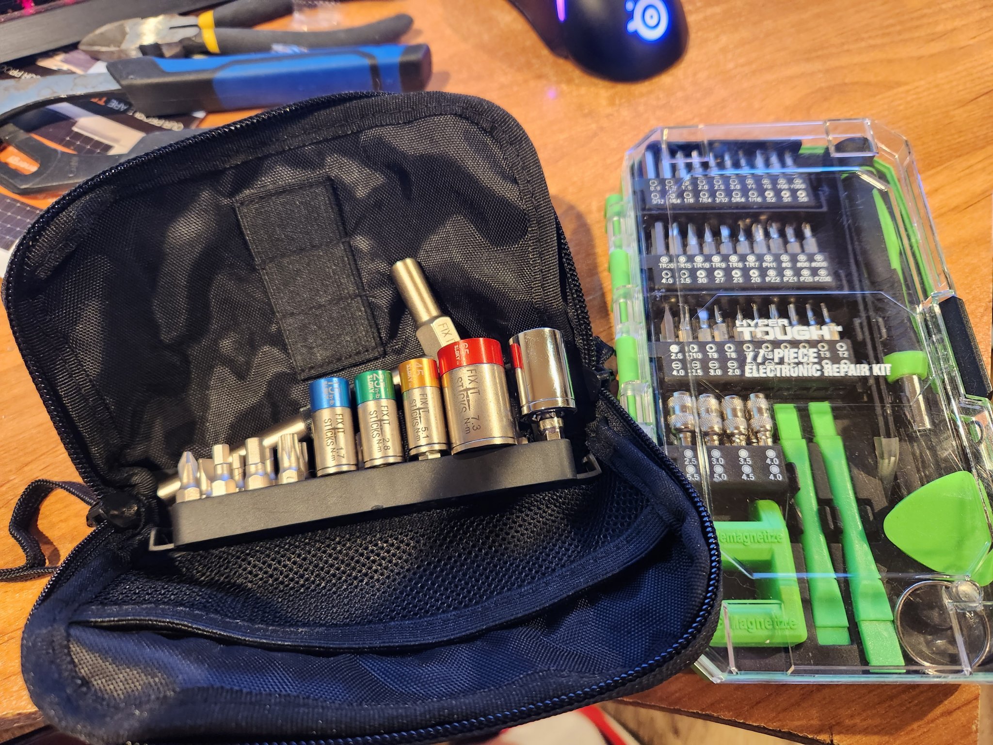

I have multiple sets torque bits. Wheeler being one and another set from Ace or something similar. Usually what one set doesn’t have the other will
I also have a set of these and haven’t had an issue with any stock/chassis or mount with my combination of tools I now have

Edit: This cheap driver set and my fix-it sticks have paid for themselves. Plus I've helped 10+ people adjust their shit by having random attachments from the green kit. Its like $20. Get one.
