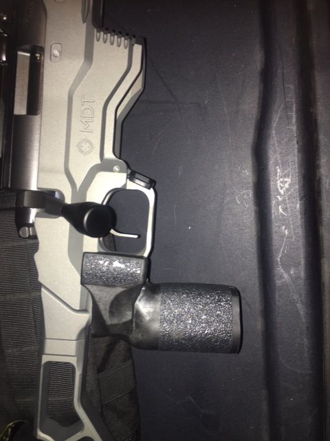

    As the title suggests, I'm not a fan of the adjustable grip I got with the MDT ACC so I want to swap it with an MPA EVG grip. Wondering if anyone's tried it and have pictures of the grip post-trimming
    I have one on mine. I had to remove some material with a file one the grip, I like it better than the MDT grip it came with. It also had a funny angle when I was done so I put some shims in to make it straight.

    Specifically looking for pictures if you have any
    Here is one

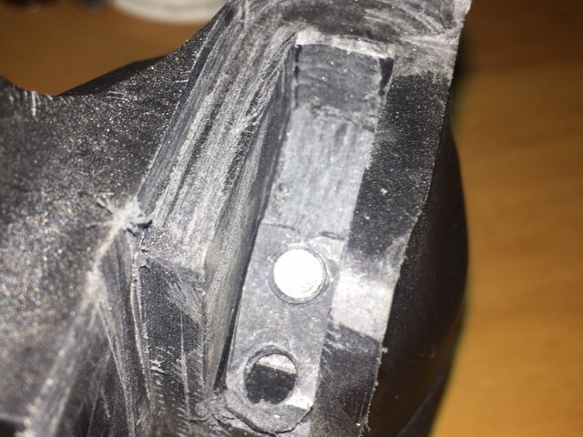

    Oh sorry if I take it off I will snap one. I might put the MDT back on to sell it. If remember right the on back of the grip the two angles did not agree. some material at the back of the slot, it was a while ago.
    I slid it on. filed slid it back on filed more etc.

    Here is the inside, I turned on the flash not sure if that helped. the one without the flash you could not see the back where it was hard to remove material. The little round thing in front of the bolt it a shim (telecaster pick up bobbin) I made out a part from work to make it sit straight up and down.
