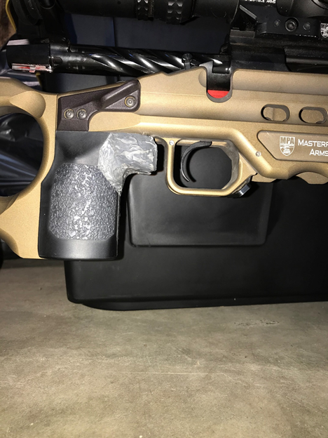

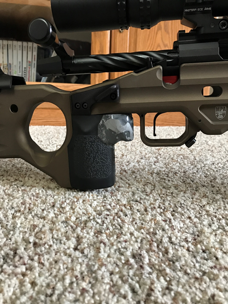

That being said, I am 5’ 9” or 5’ 10” and 205 pounds. I have the cheek bones of a 12 year old girl apparently as I have yet to meet a man that can see through my scopes. I also have hands on the small side of average. So please take into account the fact that I am not an average shaped person in the respect of build.
However, that is one of the main reasons that I chose the Matrix as it is supposed to be fully adjustable and have multiple grips that can be changed out to suit different sized hands. They also pride themselves on the grip that they produce for the Competition chassis which indicated to me that they would probably be ahead of the game in this area.
I ended up using the vertical 2 grip. I chose this option because it placed my hand closer to the trigger than the rest, and I do prefer the vertical to the swept. To be honest I thought for sure that I would like the swept but it placed my hand farther to the rear and that was really the main factor for not liking it as well.
I shot the rifle for a few weeks and I could never really get a good feel on hand placement. I then used some foam and started to build up and area between the trigger guard and the grip to stop my hand from riding up the grip towards the action. This was much better. I emailed MPA and expressed my concern with the fit and had no response. I then built up the area with an epoxy putty and ground it down until it had a good fit for the straight shoe trigger that I was running. I coated the putty with JB weld so it would handle the weather and abuse.
I ran this for a while, and it was much better but I barely had room for my remaining three fingers below the buildup. Even though I had no problem maneuvering the rifle I feared there could be a safety concern at some point. I then reduced that area about so my middle finger fit slightly behind the trigger guard. I realized that now my finger is engaging the flat shoe in the middle and not towards the bottom and it did not feel the same each time. So I purchased another Triggertech Diamond with a curved shoe. I do prefer the straight triggers but, in this chassis, the curved is a better option in my case.

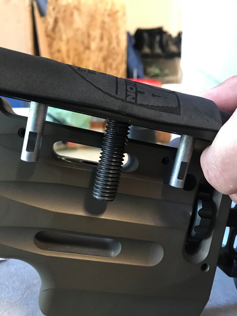

Cheek Riser
Originally setting up the stock I found that I could not adjust the cheek riser high enough. The retention bars were to high for the set screws to engage with. I ended up building up a cheek riser with craft store foam to get the correct height, and then I wrapped it in hockey tape. This also allowed me to thin it out and shift the top of the riser to the right side, so I did not have to cant my head to get on the scope. Prior to doing this I was going to purchase an accessory from MPA that would have allowed me to slide the cheek riser to the right. I do appreciate that they offer this accessory but do think they should include it with a chassis named the Matrix.

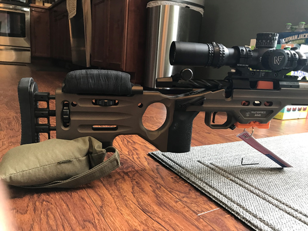

To be clear the reason I built up the riser as opposed to purchasing the accessory was because the riser would not go high enough and still lock down with the set screws.
I shot the rifle like this in all of the matches that I attended and it worked very well. I have done this to other stocks but I had hoped that I would not have to do so this time.

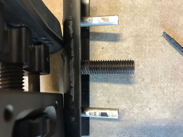

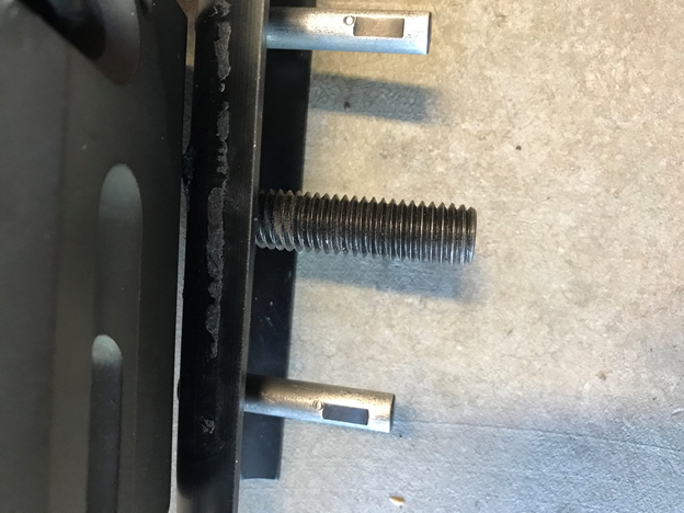

A problem was notice when I went to move the riser. I loosened the set screws and I could not adjust the riser. I was able to move it enough at the range to get the height I needed after I cut the “hillbilly riser” off at the range. When I returned home I tore into the problem.
When I added the “hillbilly” I locked the riser down in a low position so I could get more of a taper to the thin top. When I did this the set screws engaged the lock down shafts above the standard flats that are provided. I did not know this at the time, but found out that the set screws cratered out the shaft. When I went to raise the cheek riser, I had to tap it up with a soft dead blow while rotating the adjustment screw. I then filed down the blemish and had to polish the shafts up to get them to go back into the stock. The original finish looks to be a Parkerize treatment. I think Parkerizing is great but in this dry non lubricated duty I think it was a bad choice. A polished stainless shaft would be much better suited.
It was then that I noticed the flat on the shafts and how short they were. They were also not 90 degrees from the set screw engagement. I squared up the flats so the next time I locked it down the set screws would engage the flats properly.
The original engagement is about 3/8” of travel. That is ridiculous to think anyone from a 5’ slim person to a 6’ 10” heavy built person would only need 3/8” of difference.
The picture above shows the original lock down after I cleaned it up and polished it. The flat shows the original finish.
I used a Dremel and added length to the engagement area. I then lowered the riser completely and engaged the set screws. The picture below shows the engagement point.
The picture above shows the flats with the bottom of the riser sitting on the top of the chassis. This is not its lowest position that is shown two pictures up. I would consider this to be a normal area for the riser for most people
I would recommend replacing the set screws with brass or polymer non marring tips as well.

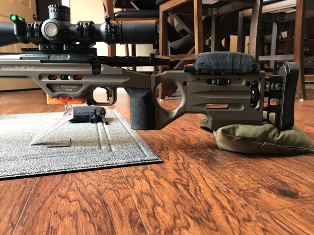

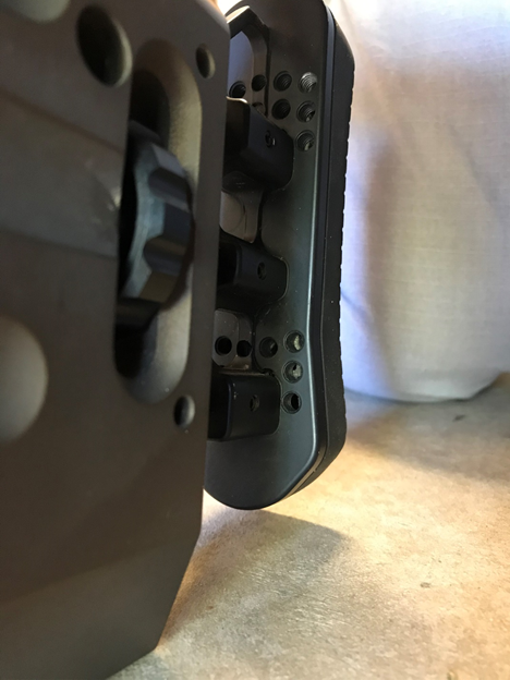

The But Pad

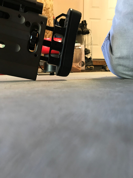

If you look at the above pictures you will notice that the but pad is rotated 180 degrees. The pictures of the cheek riser with the foam and hockey tape show the but pad in the highest position available. Rotating the pad will give you the most height that you can get out of it.
The but pad is not as comfortable when it is rotated but I like to have the top of the pad approximately the same as the top of the barrel. You can see that there is adjustment if you would like to offset the but pad left or right.
Also be aware that if you move the but pad at all from its centered position the pad becomes more exposed to damage as it is not protected by the mounting hardware as well.
Compared to most high-end chassis this is not acceptable. I have used J Allen, KRG, and MDT. All of those products have much more adjustment in both the riser and the but pad.

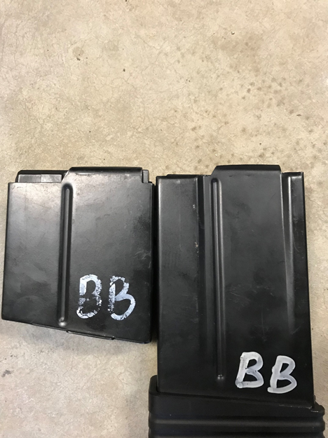

Now that that has been said, I will get into the AW magazine conversation. Talk to anyone that is in the industry and they will steer you away from AW magazines. I want to run them so I was willing to suffer through the process.
This is my process and I do not recommend that you follow it this is my story alone and it may have negative results for anyone else.
I feel that most problems with magazines is not the magazine but the fit. When I see a rifle have feeding issues while pushed into or onto something I believe the problem to be the fit.

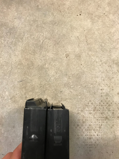

I started by setting the MPA adjustable mag catch as high as I could. The AW magazines have to have pressure to actually snap into place. This keeps the magazine from rocking forward when pushed into something. KRG and J Alen have a few other tricks to keep the magazine from rocking as well but even without their additions seating the magazine high worked.
I then had to file down the top of the AW magazines because the bottom of the bolt lugs, not the bolt, impinged on them. They were basically a knife blade when I was done. I did not modify them in any other way. Prior to this I destroyed an AW magazine trying to modify the lips but then realized the true issue.
I then inserted an ACIS magazine. I then removed at least an 1/8” from the lips and had to reshape them because the bolt would impinge on it when it was pressed into or onto anything. The magazine runs great never had a problem.
As a side note another Vector owner was having problems with his magazines and was talking to people that were insisting that he shave down his mag catch to lower his magazine. I loaned him my ACIS and he ran it for the remainder of the match with no issues.
So it is my belief that you should set the magazine as high in the action as possible and modify your $70 to $90 magazines to fit. Again that is my belief and I am not a gunsmith, or an engineer. I am a guy with a Dremel and a hammer.

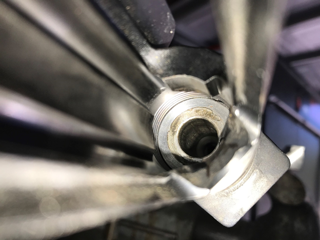

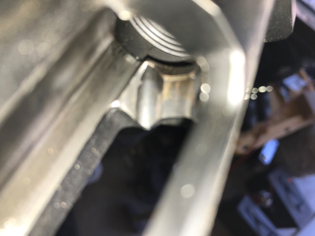

I am running 6.5 Creedmoor. Using an AW magazine there is a sharp point that will catch the shoulder from time to time and dent the case. I rounded it off and problem solved. Now every so often the round will kick to the opposite side of the chamber and hit the back of the barrel instead of entering the chamber.
I ended up removing a portion of the feed ramps all the way into the end of the action. I did this incrementally and only removed what was needed while still leaving the raceway intact.
This solved the problem with Creedmoor. I do not recommend that anyone does this and if they do they should have it done by a gunsmith. I also would not advise this on any other ammo. I believe that this allows the bullet to enter the chamber before the feed ramps force the round toward the center while still retained in the magazine. I do not know if this will work on any other round.
Now that that has been said I LOVE the Curtis Vector action. I could have set this up for an ACIS but did not. This action is smooth as silk on satin and has given me zero problems.
I do not consider what I have done to the feed ramps to be a problem. I did this so I could run AW magazines 100% of the time with pressure from any and all directions and IT DOES.
