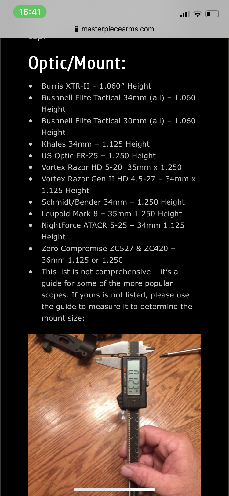

I’m wanting to purchase a mpa Mount for a athlon cronus. It will go on an bighorn origin with a proof sendora Barrel. 20 moa rail. There are different heights listed and I was wandering if anyone had experience with this particular set up. Thanks in advance. Pictures welcome.
I’m wandering about the distance between the bottom of the scope and the mount also.
Did you see this on MPA web site?
I personally use the 1.250 with my Vortex Razor II in a MPA chassis.

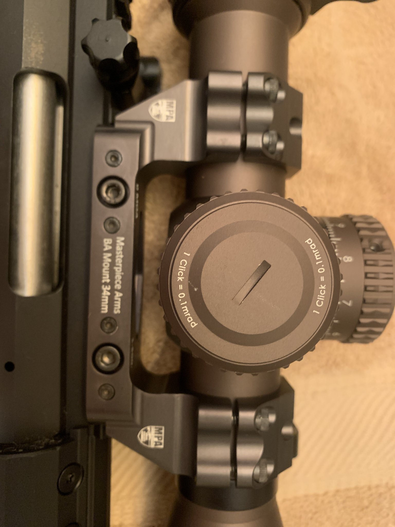

Cavreconscout. Does it set the scope high off your rifle? My scope is on the way after a mix up. I can’t measure it yet.

Measure how far below the main tube the housing for the turret sets. That is what the measurement is for.

This is with the 1.250. You should be able to use the 1.125 which is what they recommend for the Razor II.
