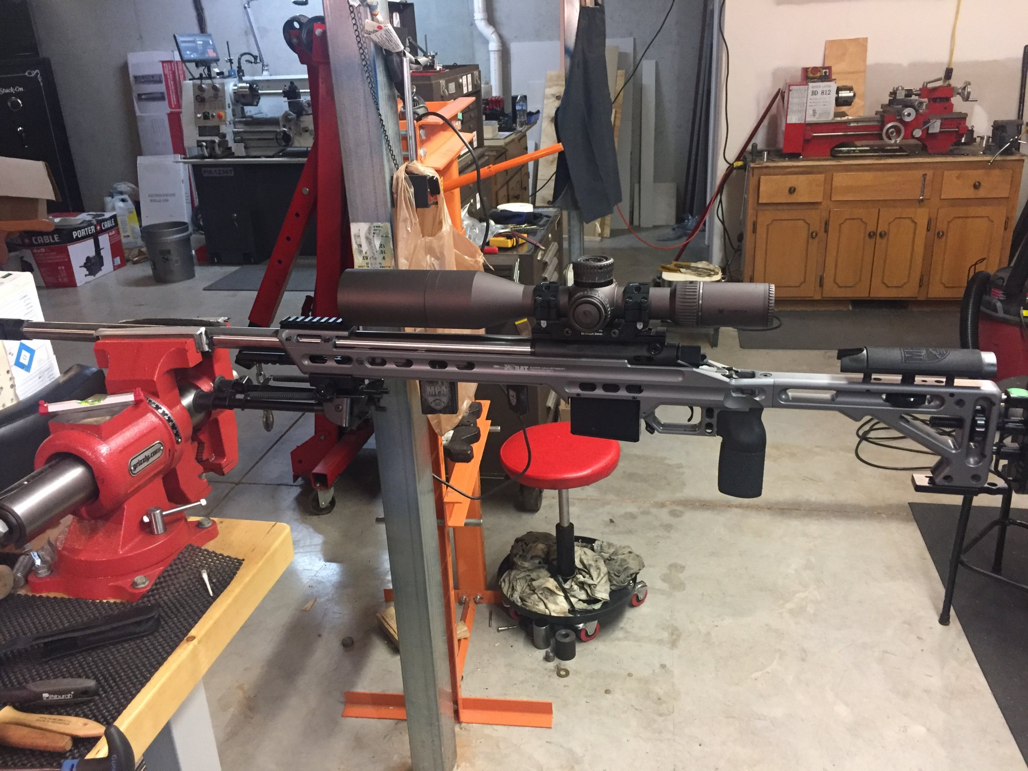

Nightforce Ultralight mediums would work for sure. The lows may cut it too close with the MTU profile. I use lows on my Tiikka CTR w/ a Athlon Cronus and there is less than 1/8" clearance.
Reactions: 6xcKY
