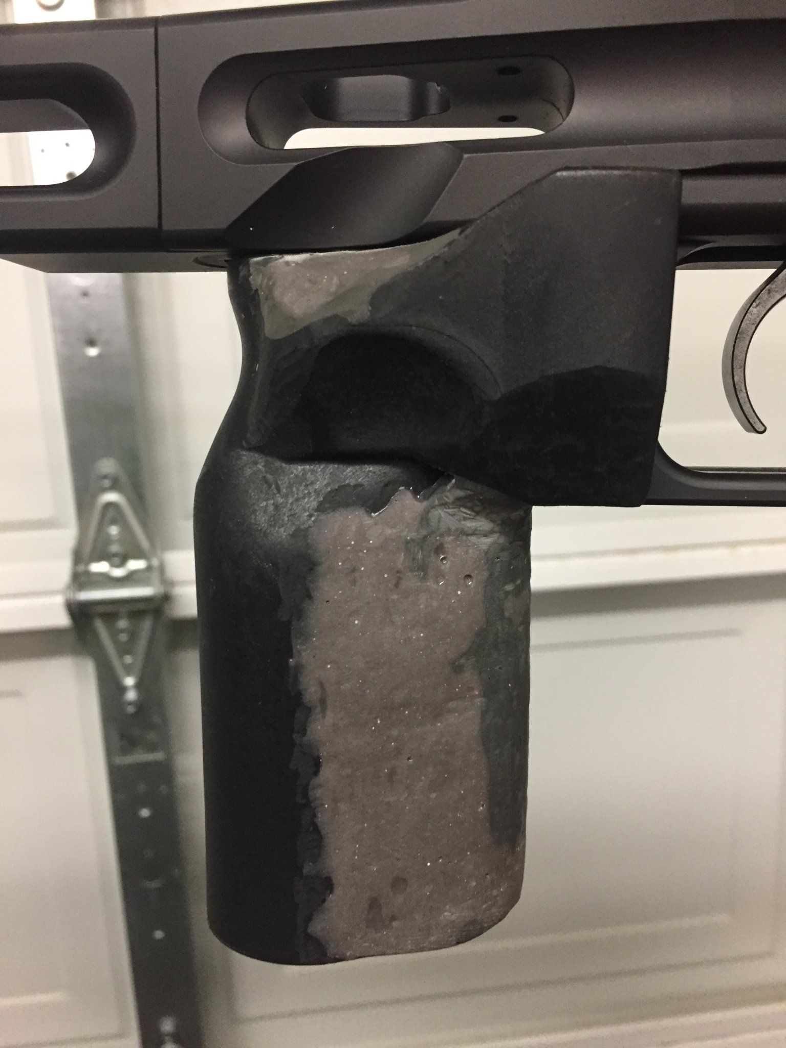

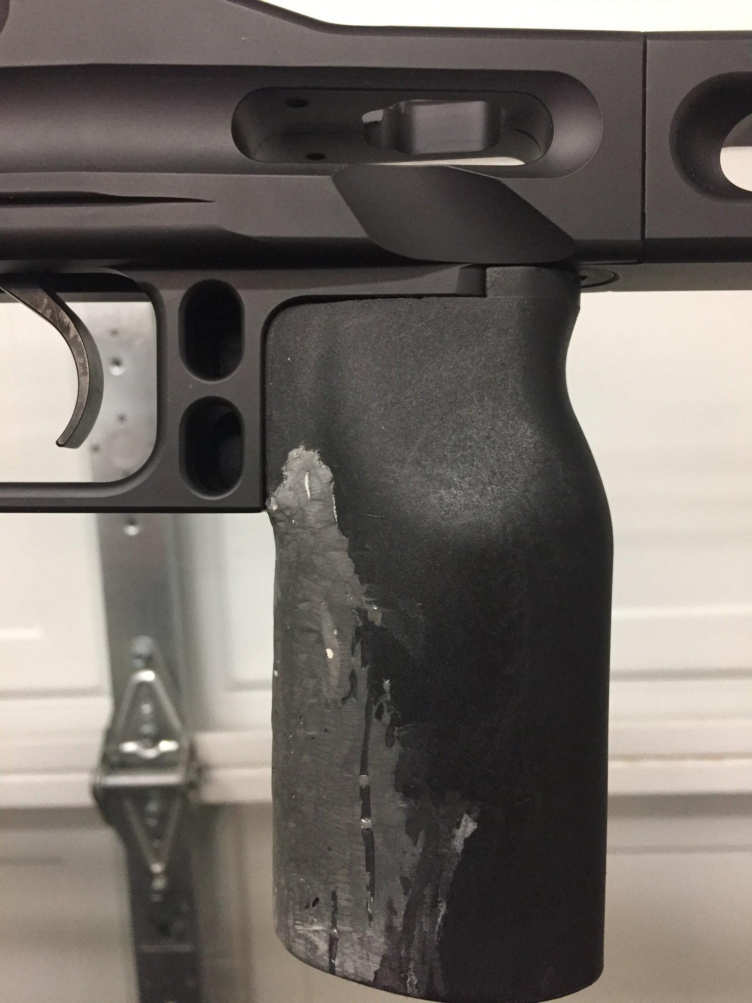

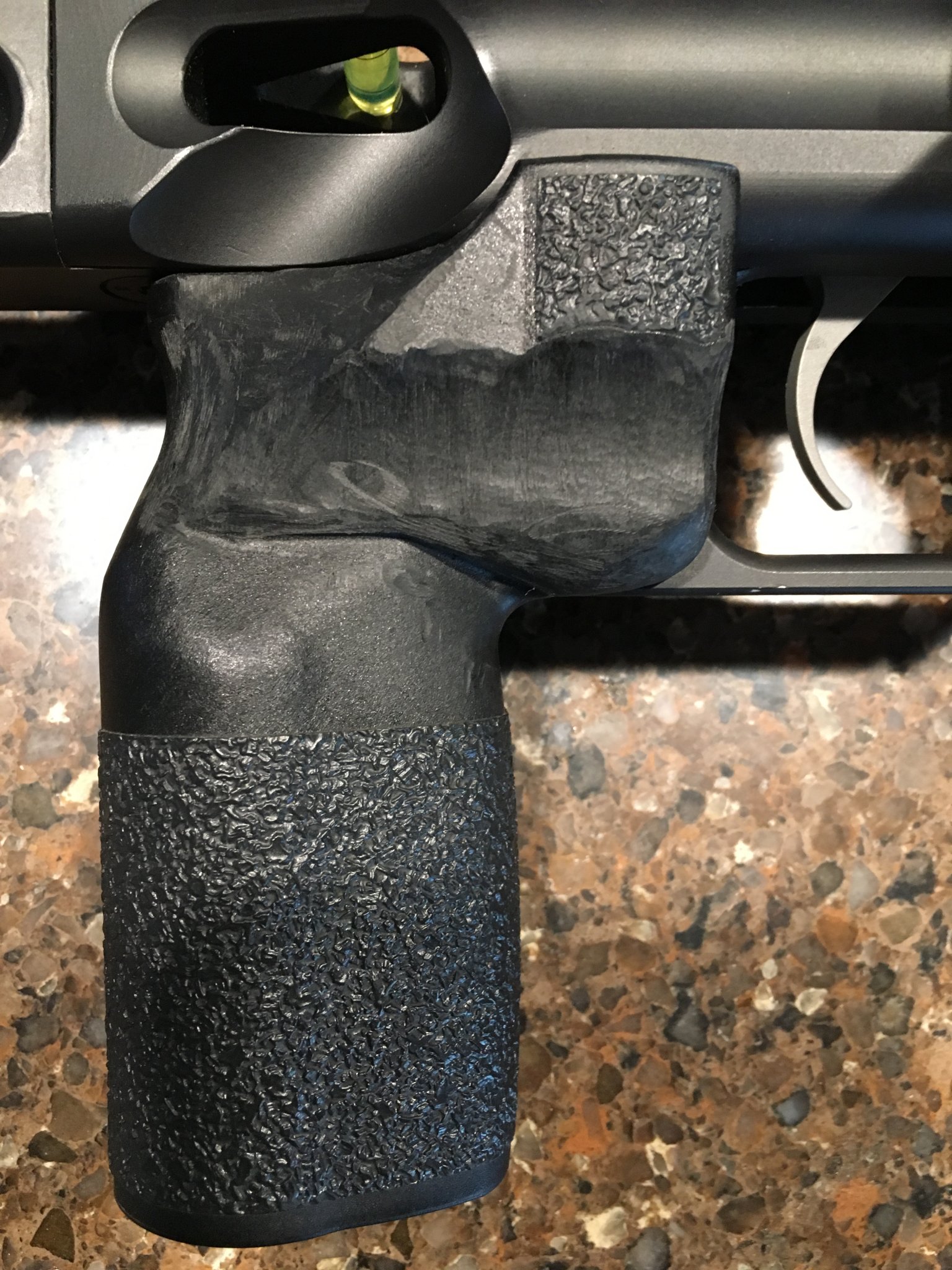

Honestly it looks rough and if need be I can go over with sand paper but I really don’t feel any of the markings on it
Side view
Front view
Back side

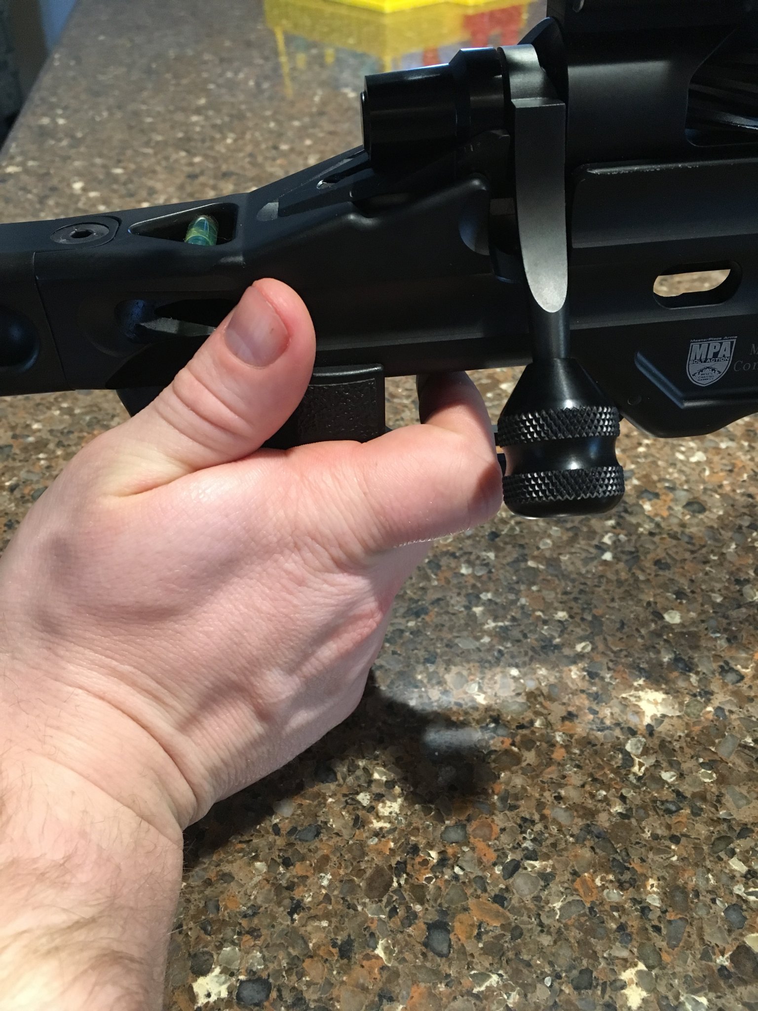

Hand placement
And now you can see why my chode fingers don’t work without modifications.

That's basically what I did to mine. However, I added some epoxy to the front strap, and the thumbshelf. I then sanded down to get the exact 90 degree trigger finger I wanted.

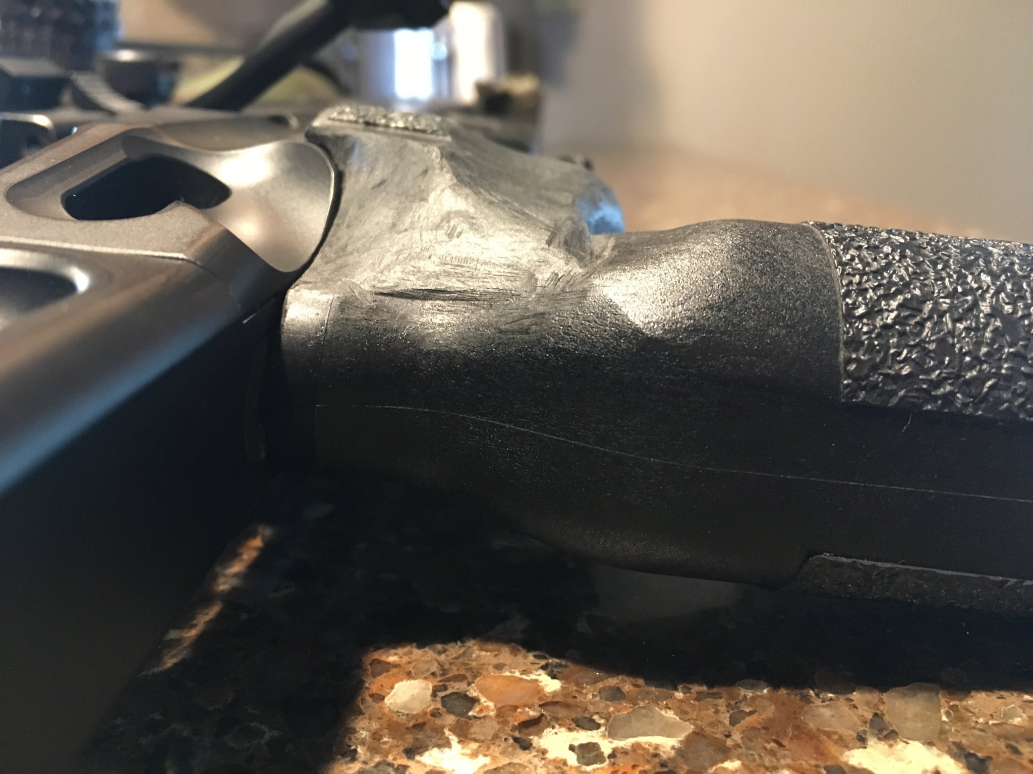

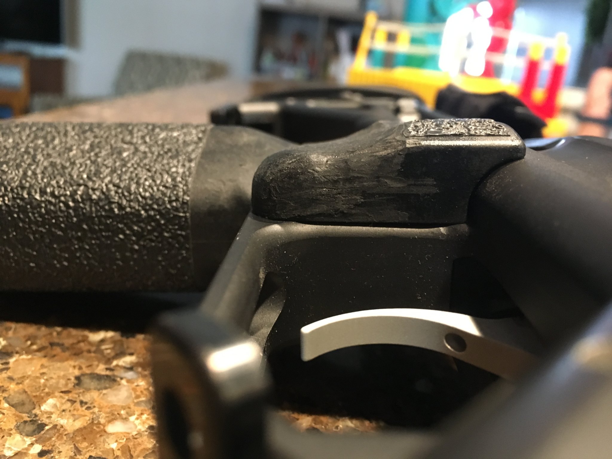

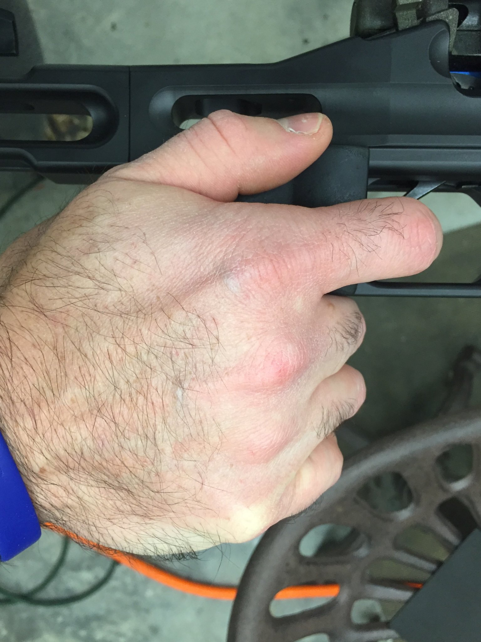

Here’s what I did:
I added epoxy to the front strap to build it up to be completely vertical from the back of the trigger guard. I also added to the sides of the grip to “round” it out. Then I sanded it down smooth. I built up the thumb rest, then flattened it out to make my thumb happy. I sanded down the“fingerrest” as I felt my fingers drag on the bottom corner when trying to run the bolt fast. It still does it’s job of positioning my trigger finger. I have a sheet of Talon grip that I wrap the grip with to finish it off.
