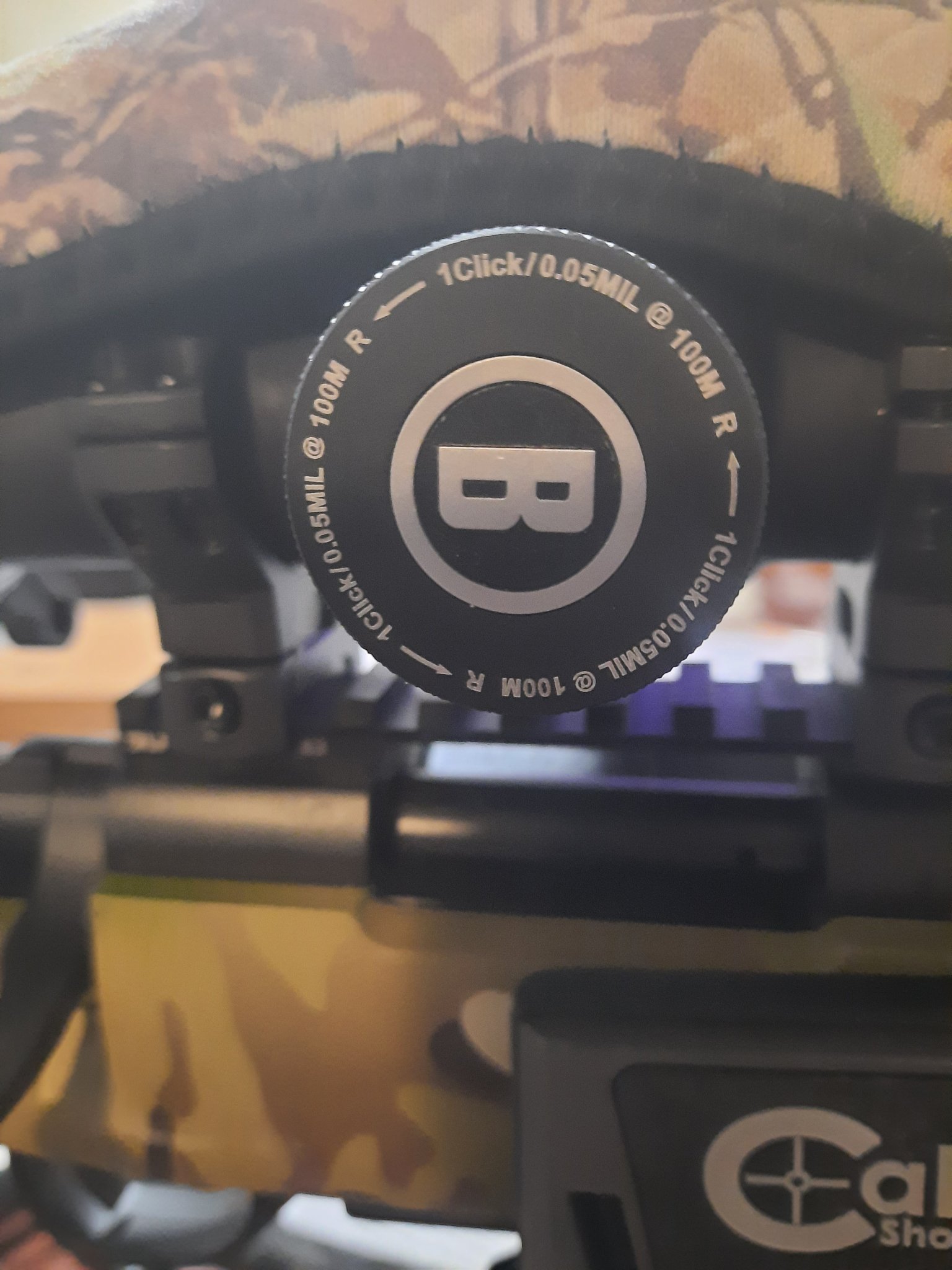

I just received a bushnell forge rifle scope. Store sent a scope with .05 mil per click turrets. I've never used a mil scope before. Would at 100m .05 mil click equal .5cm on target?
Just measure with the reticle. No different than a MOA scope unless you don't know how to use that properly also. It is ok to admit if you don't know, as we all start somewhere.

It is simple reticle, german #4 and if I'm wrong can we start by from beginning, which part is wrong
I wont assume what reticle you have or focal plane...
So my simple answer: Yes. .05 milliradian = .5cm (5mm) @ 100m and 1cm (10mm) @ 200m
Suggest you see what happens when you adjust your turrets and confirm ;)

SFP, and thank you, that is all I needed to know

I have to ask - Is that a legit authentic scope?

Yes, bought from Natchez shooters, I buy exclusively bushnell. It's a new bushnell forge
Ok. The reason I’m surprised is that milliradian is a measure of angle, not distance.
So writing it as .05 milliradians at 100m seems bizarre and completely unhelpful - hence you being confused.

Yes it is, it's a .05 milliradian per click scope
That way of describing a milliradian scope is confusing to people who don't understand angular subtentions.
Like those who think that 1 MOA is 1/4" at 100 meters.

Expressing the adjustment increment in terms of fractions of a milradian on ele/wind
turrets has been standard industry practice for quite some time, is very helpful and shouldn’t surprise anyone.
If you’re not sure why this is, perhaps it’s a good idea to brush up on rifle scope fundamentals in practical precision shooting applications.
Correct me if I’m wrong then, but .05Mil is .05Mil. At any distance. The Mil is the constant. The distance and length are the variables.

To be clear, I’m not surprised at them expressing the milliradians per click.
What I’m surprised at is the reference to a distance in the same expression.
Thanks for the advice.
Why are you surprised by this?
Do you not understand the relationship being expressed on the turret and how that information is applied in context? Would it also surprise you to know that nearly every scope, at essentially every price point now a days has the same sort of guidance on each turret?
I’m obviously missing something.
How is the distance relevant?
‘1 click = .1Mil’
That’s it.
Why would I need any reference to distance? .1Mil is still .1 Mil regardless of if its @100m or 1000m
You just answered your own question. Lol.
What if one click wasn’t equivalent to .1 Mil at 100 meters. What if one click equated to .1 Mil (one cm) at 50 meters (but that distance figure wasn’t stated on the turrets).
Don’t you think that your rifle’s dope for a 1000m shot would be different from the same elevation you verified based on a scope indexed for 1 click=.1mil at 100m?
do you think you’d still be on target with the first round fired dialing up the same number of clicks using this new scope with a different index (unbeknownst to you because no distance figure is on the turrets)?
Either my morning tea hasn’t kicked in or I’m struggling to English.
I’ve read that 4 times and I’m still not sure what you’re asking..
Just to clarify.. when I said ‘1 Mil’ I meant 1Milliradian. Not mm. Is that where the confusion is?
Maybe I should have written ‘1 click = 1MRAD’
All I need to know is what unit of milliradians a click adjusts by. That’s it. I can work out everything else myself. If you’re asking would my Dope be different at 1000m compared to 100m.. Of course it would, but that doesn’t change the fact that a milliradian at 100m is still a milliradian at 1000m. It’s the distance (height or width) that a milliradian represents that changes with range. Not the milliradian.
If they’d written ‘1 click = 5mm @ 100m’, that would make more sense to me than ‘1mil @ 100m’.
What am I missing?

You're right, I had read the label as 5 cm @ 100 m. Went back and sure as shit the turret label is fubar
ETA I should have said .5 cm @100 m but it's still a retarded European way of saying .05 mils
If they had written ‘1 click = 5mm @ 100m’, that would make more sense. What am I missing?
Scope makers don’t write it in terms of linear distance on turrets as much anymore (ie 1click=5mm or 1 click = 1cm at 100m, etc) as most folks think of and log dope using the unit of angular measurement not the actual drop value in mm, cm, inches, etc. As an example, Your rifle’s dope book (.308 win) prob reads something like 100m-0, 200m-.7mils, 300m-1.5mils - and so forth. It doesn’t express those drop values only in mm or cm (though you may keep that info in the dope book, it’s not what you’re reaching for first when tying to come up with a firing solution).
We also don’t typically use the linear measurement when correcting or adjusting, or calling shot corrections. You express all that information in the angular measurement (mils or MOA), depending on the system you’re using (Ie “.5 mils high, .2mils right” instead of “50 cm high and 20 cm right”). So the scope makers put “.1mil” instead of 1cm to make it more aligned with how we think of the adjustments.
The point of my question above was that if a zero distance index isn’t written at all and it just said one click = 1cm or .1 mil, you would just assume that means at 100m but if it doesn’t and that information isn’t on the turrets (or anywhere else for that matter), it would have an impact on your ability to hit your target (or initially zero the rifle) at least until you figured out what the difference was.
That said, It seems you’re actually hung up on having the “Mil” value (ie .05mil aka 1/20 mil)l at 100m) instead of the incremental adjustment distance expressed in a linear unit (1cm or 5mm) on the turret (answers my question in post 34) where as I read post 31 to indicate you were hung up on providing the target’s zero reference distance (100m) on the turret.
Let me know if I’m mis-reading anything of yours.
First 2 paras - I’m in 100% agreement with.
But then you lose me in the third. What exactly do you mean by zero distance index?
If I’m ‘.5 mils right’ as you refer to in the second para - the distance is irrelevant. I adjust .5mils.
I dont think I’m hung up on anything. I just see no need for any ‘distance or length’ reference on the turrets whatsoever. It’s redundant information that is openly going to confuse people. I’ve never suggested there should be a linear unit expressed on the turret. I’m saying that adding the ‘@100m’ to the OPs turrets makes no sense. The only way that referencing @100m makes sense to me is if they ARE using a linear unit - but they aren’t!

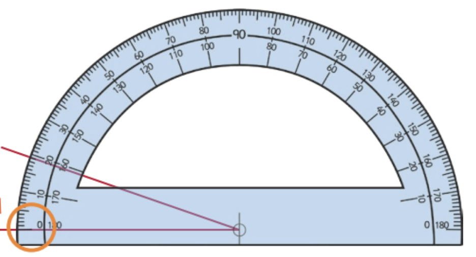

Op, the reason you're getting so much crap in this thread is you seem to be confusing/combining a term of angular measurement (mils / mrad / milliradians, etc.) with units of linear measurement (inches, centimeters or whatever). I made the same mistake many many years ago. Hopefully this will clarify.
Look at the image of the protractor, which measures angle. Degrees, radians, minutes, milliradians are all measure of angle. Feet, inches, meters, centimeters, etc are linear.
So let's pretend the protractor is measuring tenths of a mil.
  • The horizontal line represents line of sight through the scope, which we'll assume is mounted on a .22 rimfire, aimed at a target on a level range.
  • The line running through the "19" mark represents the angle of the barrel at 1.9 mils elevation from zero, which for an "average" .22 with "average" mils optic and "average" match ammo zeroed at an "average" 50 yards will be on target at very close to 100 yards.
Ok, so 1.9 mils is the angle. That angle will be 1.9 mils at 100 yards , 200 meters, 1.4 miles, 17.3 furlongs, or whatever linear distance you care to name. It just so happens that, at 100 yards, 1.9 mils subtends 6.8 inches... but at 500 yards, that 1.9 mils subtends 18 inches.
To correct misses high or low, you make corrections to the angle of the barrel's angle by turning the elevation turret. Does it make sense to convert the linear distance of the miss to an angular measurement? Hell no. You use the stadia marks on the vertical reticle of your scope to see how many fractions of a mil high or low you are and dial that correction or hold over/under by that correction.
Your Bushnell Forge is a second focal plane scope, which means the reticle stays the same size regardless of magnification settings. This means that, assuming your reticle has stadia marks, the angle they are documented to subtend is only correct at maximum magnification.
Bottom line is, Forget Linear. Please. FORGET LINEAR. When you miss, your spotter doesn't call adjustments in inches, your spotter calls correction in mils (or MOA for old school).
Your scope, by stating "0.05 MIL @ 100M" isn't helping and really makes Bushnell look foolish. The distance is totally, utterly irrelevant.

Zero Index distance is my term describing the “100m” portion of the information on the turret. Most zero their rifles at 100m (or 100 yards) hence why the turret values are expressed using 100m as the reference distance for movement in terms of incremental adjustment size on the target for each click.
