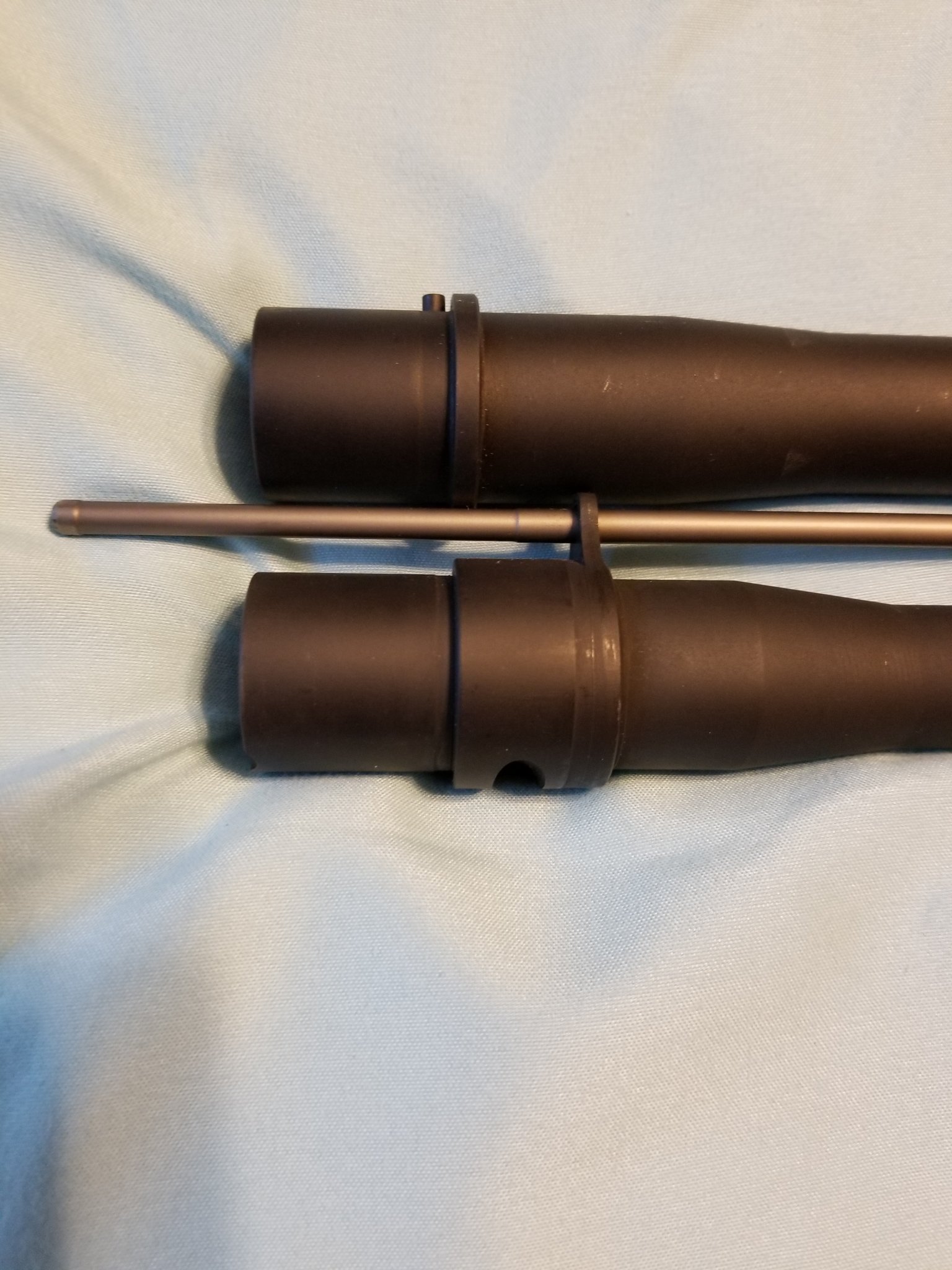

BHW barrel on top. MRP barrel on bottom. I would essentially need a sleeve over the BHW to allow for the cut for the retaining screw. Correct?

Looks that way. Getting a proper fitting sleeve is probably the biggest issue. You can probably do the cut with a hand file like Laseredge stated.

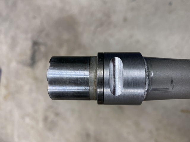

Looks good!!! Are those threaded on or press fit? Also it looks like the sleeve goes over the chamber area in the front when the barrel tapers down, is there a gap there?
Just got done making a prototype. Plan to offer this in the near future.
