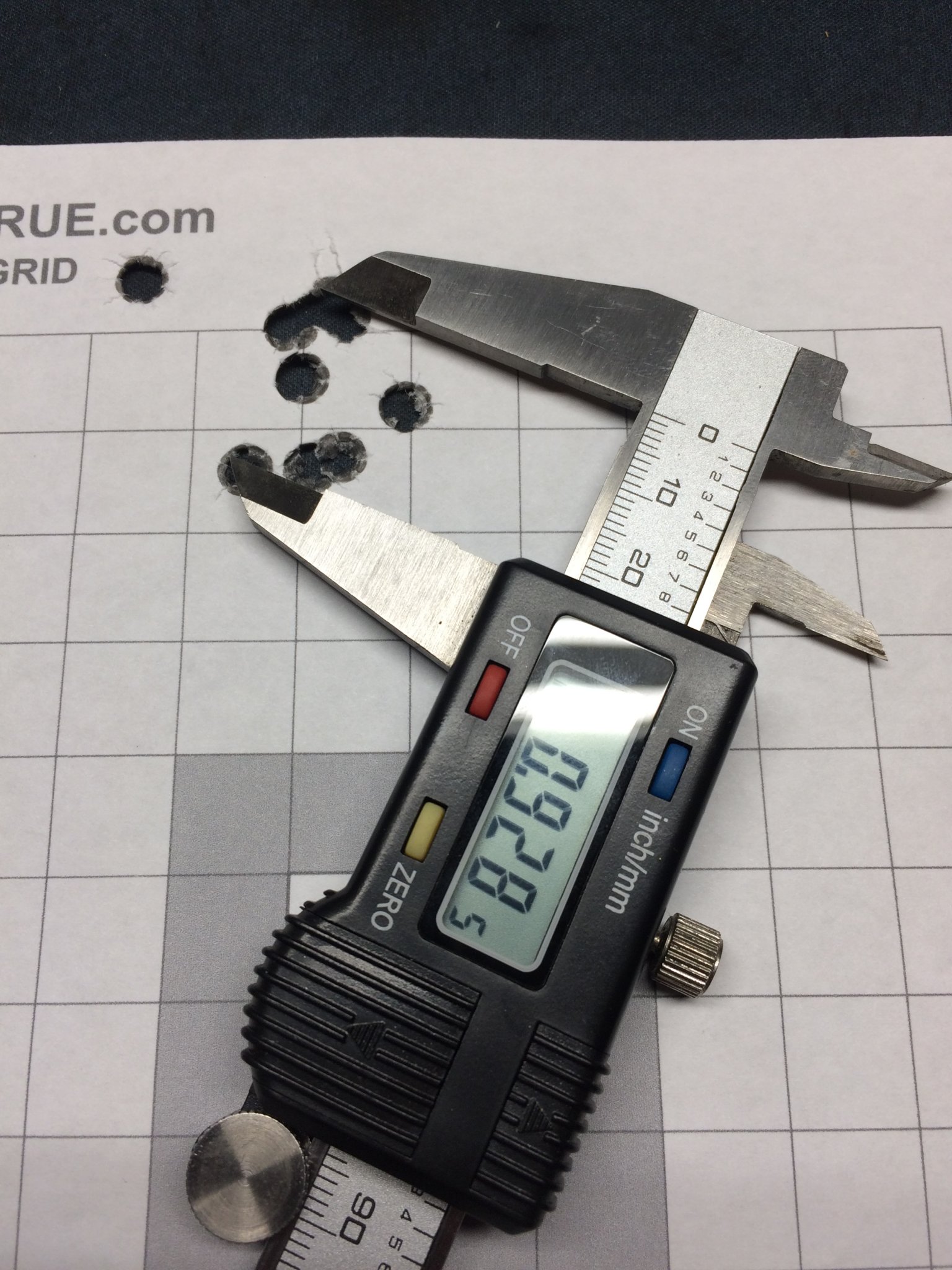

Barrett MRAD. Shift is entirely repeatable, but can be substantial moving across barrels. For example, the shift in the below case was something like 1.1 mil left and .7 mil up going from .260 to .338. A .308 barrel, on the other hand, showed less than .2 mil shift from the .338 POI.
100yards, factory prime ammunition, which is normally around 1moa for 5-round groups at this distance. Procedure:
shoot 3 rounds .260
replace .260 barrel with .338
shoot three rounds .338
replace .338 with .260
shoot three rounds .260
remove and replace .260 barrel
The resulting .260 group. I did call the flier in this case and did not measure it as I do not think it can be attributed to the weapon:
7107429
