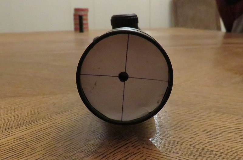

Target shooters have used small apertures on their scopes to reduce parallax error. Here is a home made one.
7065448
Congratulations, you have just made your scope virtually parallax free. If your head is in the wrong position you won’t be able to see anything through your scope. Now move your head around until an image appears. This is your perfect head position.

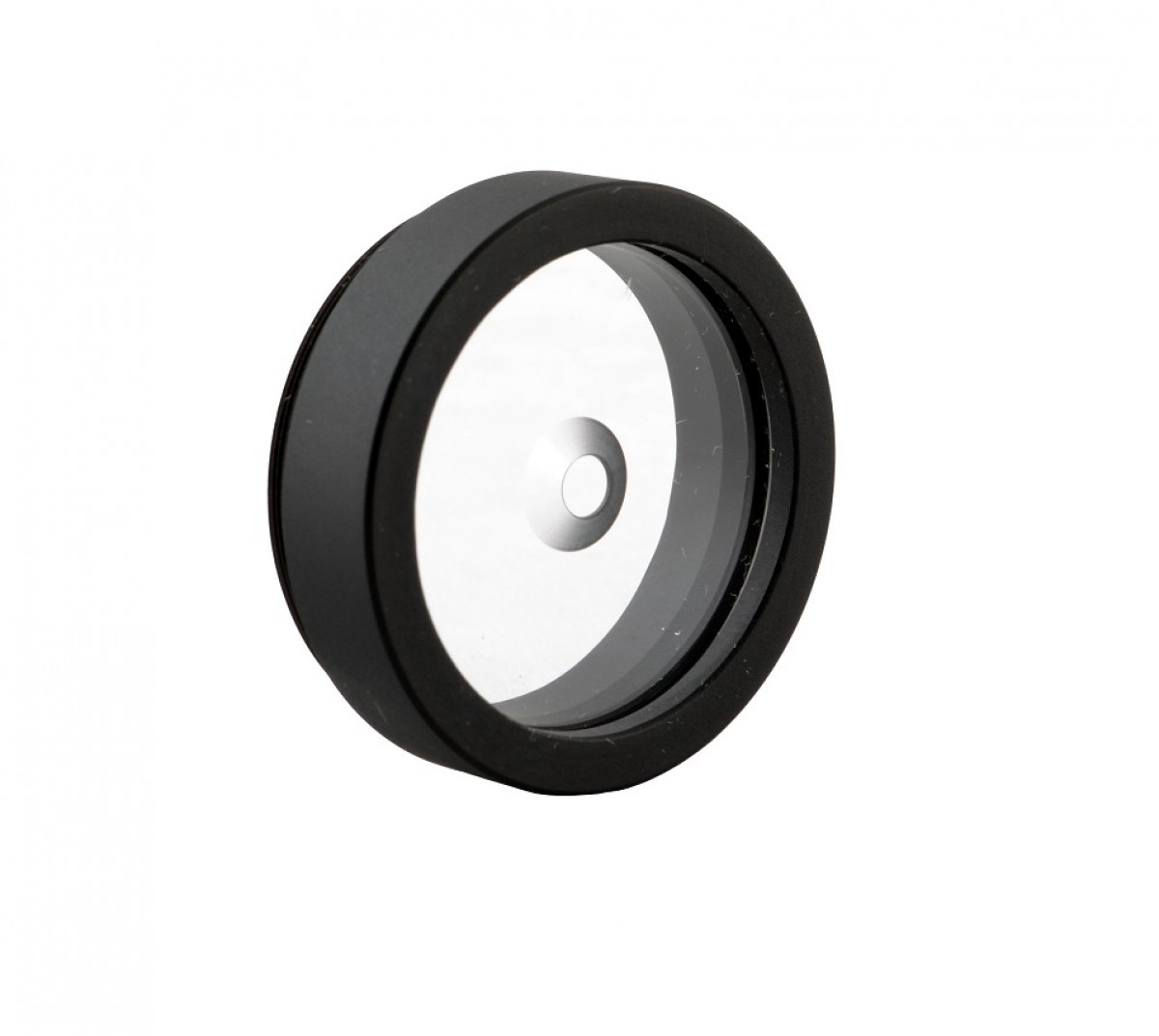

White Oak Lens Reducer
Our unique “ghost ring” design is a lens with a chamfer around the center hole. It ships with two lenses, a clear and a smoke tinted. Both are transparent which allows you a full field of view so you can still see surrounding targets and target numbers but acts as a ghost ring centering your eye in the 3/64 diameter hole.

There are obvious disadvantages to this fix , even for target shooting, but it does demonstrate that this is a common problem and that the fix is consistency in looking through the scope with the same head position every time.
