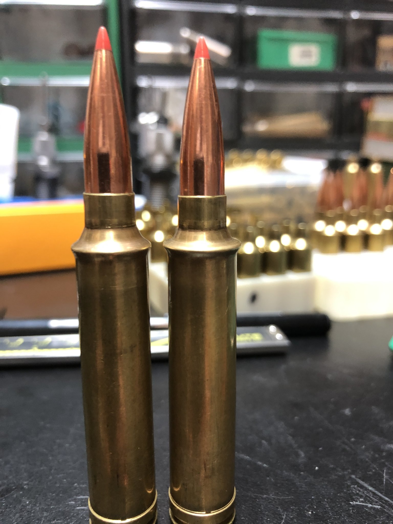

I was trying to seat a couple 6.5 Creedmoor projectiles in Lapua brass and mushed a couple. They don’t fit in the gauge.
I pulled The projectiles & salvaged the powder, I deactivated the cap.
I was goo g to resize, but was concerned the brass might get stuck.
anyone else have any experience? Should I try to salvage or toss the brass?
Thank you
Virgin Lapua 6.5CM SRP brass. When I bought them, I emailed Lapua to ask about what to do & they said they could be loaded as is, unless I wanted to FL resize first, but it wasn't necessary. Previously, when loading 5.56 NATO, I never did anything special with virgin brass, just prime & load.
in the 350 rounds I loaded so far, 3 have gotten “mushed” and won’t fit in the 6.5 CM gauge.
the projectile is an Hornady 140gr OTM.
my load stroke is slow & deliberate, which is why this is confusing. At the apex, there was a sudden “mush” feeling and the round is short, neck gone & I’m confused.
sounds like I should have done something first, based on the graphite suggestion.
all of the boxes of Lapua brass came with 101 pieces, so I don’t feel cheated, just....confused.

Not sure how to post pics. The shoulder is bulged out & rounded due to the neck being pressed towards the case head. COAL dropped from 2.8005” to 2.7790”
the case gauge is a test because I won’t chamber a live, possibly defective round that could get lodged in the chamber of my Tikka, nothing more.
the shoulder is now bulged, rounded, and curved rather than straight/oblique shoulder
if the projectile continue, it would be telescoped/intussuscepted into the case.
Do your cases look like the 300 Not Improved? 🤣

That’s a negative Smooth1, the shoulder is rounded like pressure in the case had nowhere to go & bulged out the angle of the shoulder, making it arched.
which micrometer? Redding Premium Die Set #66446 FL die set, but I haven’t used the resizing die yet, just the seating die. It only came with one micrometer
You can see some are getting crushed. Just for reassurance I would chamber a couple loaded rounds to make sure the others are not bulging out as well just not as noticeable. If you haven’t done this already
