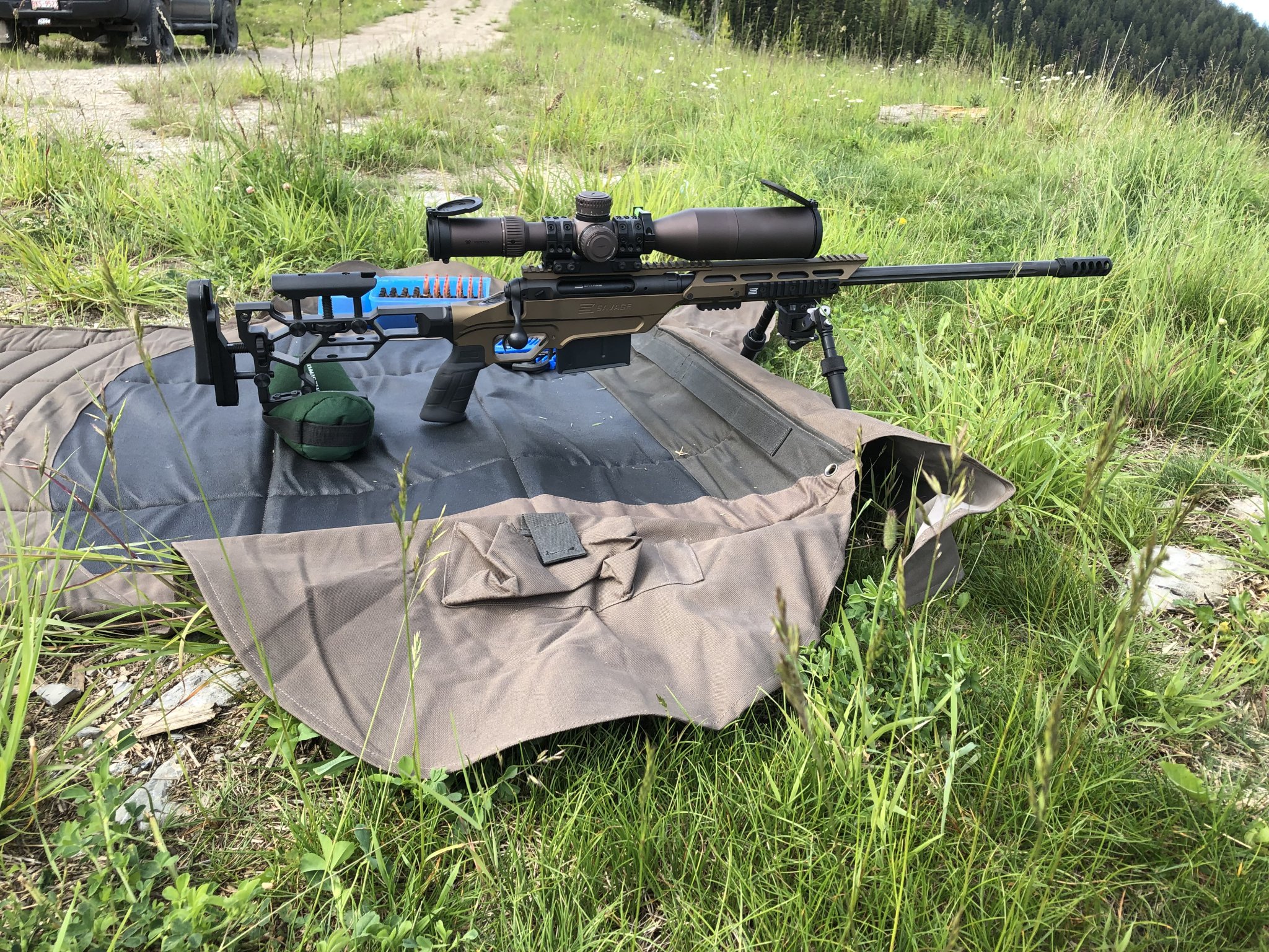

I’m in Canada as well and got the Terminator TT for my 338 Lapua From RangeTech. I was truly shocked how little recoil there is with this break. The TF brake is 3/4-24 and is self timing like he TT so no gunsmith is required. Unfortunately I haven’t shot the fat bastard for comparison.
